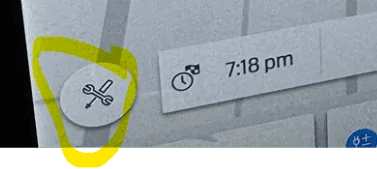

I went to the dealer today for my 10k mile service. I also asked them to look at my Nav. When I first start vehicle and use Nav and hit go I am no longer able to adjust sound for radio or phone then 10 min later it plays every turn I made and then I can adjust sound normally. Today dealer updated my SW and I got this screen (pic) but it did NOT FIX the Nav issue. I am also having an issue with my app where I can use remote lock and unlock called Ford and said a SW update coming no ETA. Anyone else have similar Nav / sound issues?

IIRC there may be settings that you can toggle to possibly correct this.

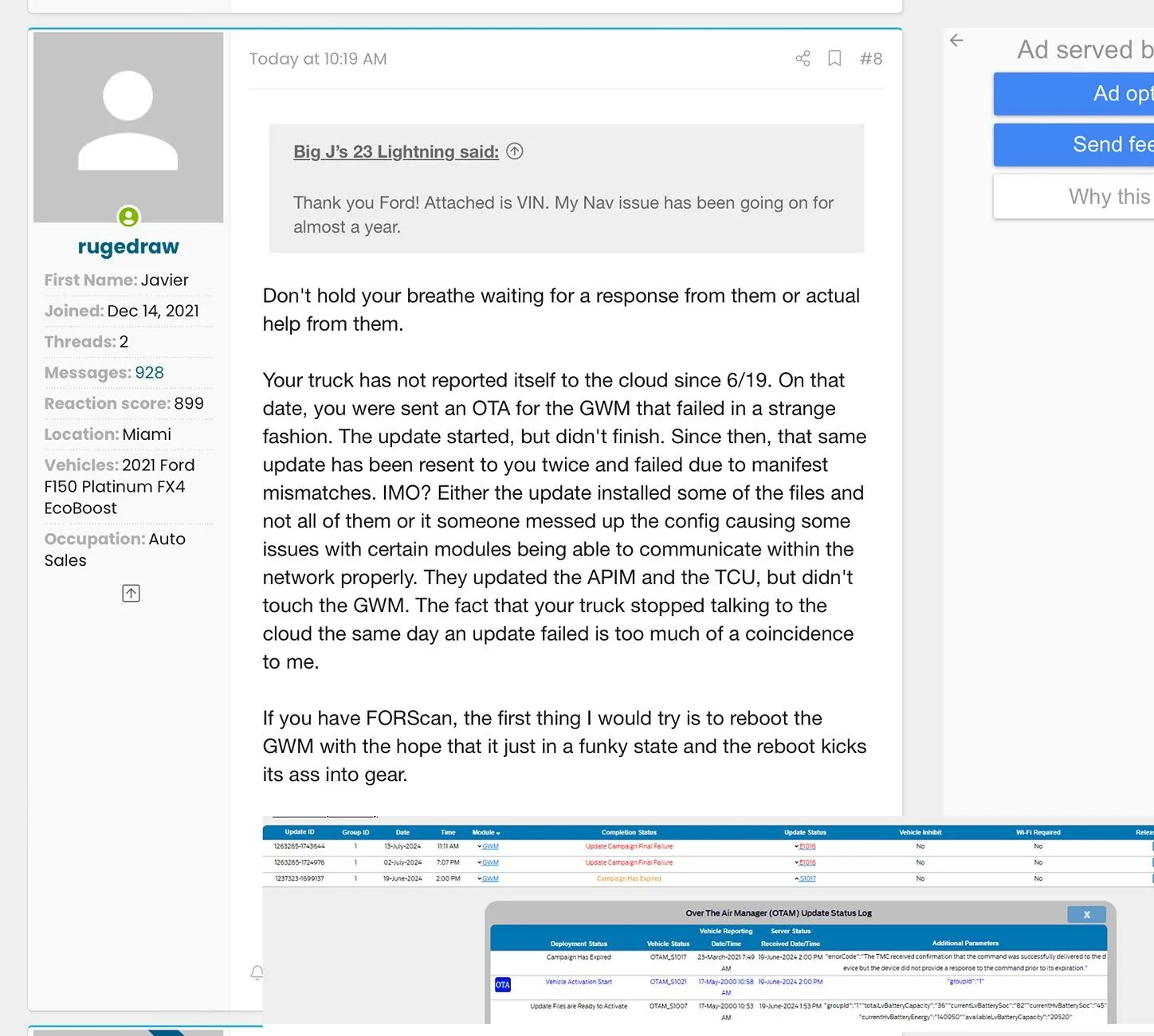

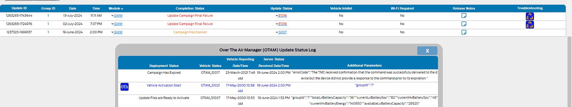

Your truck has not reported itself to the cloud since 6/19. On that date, you were sent an OTA for the GWM that failed in a strange fashion. The update started, but didn't finish. Since then, that same update has been resent to you twice and failed due to manifest mismatches. IMO? Either the update installed some of the files and not all of them or it someone messed up the config causing some issues with certain modules being able to communicate within the network properly. They updated the APIM and the TCU, but didn't touch the GWM. The fact that your truck stopped talking to the cloud the same day an update failed is too much of a coincidence to me.
If you have FORScan, the first thing I would try is to reboot the GWM with the hope that it just in a funky state and the reboot kicks its ass into gear.
