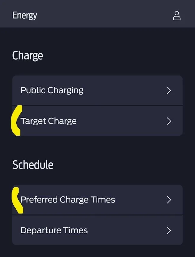

Build the location alone, nevermind trying to customize the time frames or SOC values, save the location, let it sync to the cloud then edit the location in Fordpass.
I wonder if one could build the entire scheme in Forpass, this was difficult if not impossible in the old 4.x series, maybe they improved that part in version 5 ??

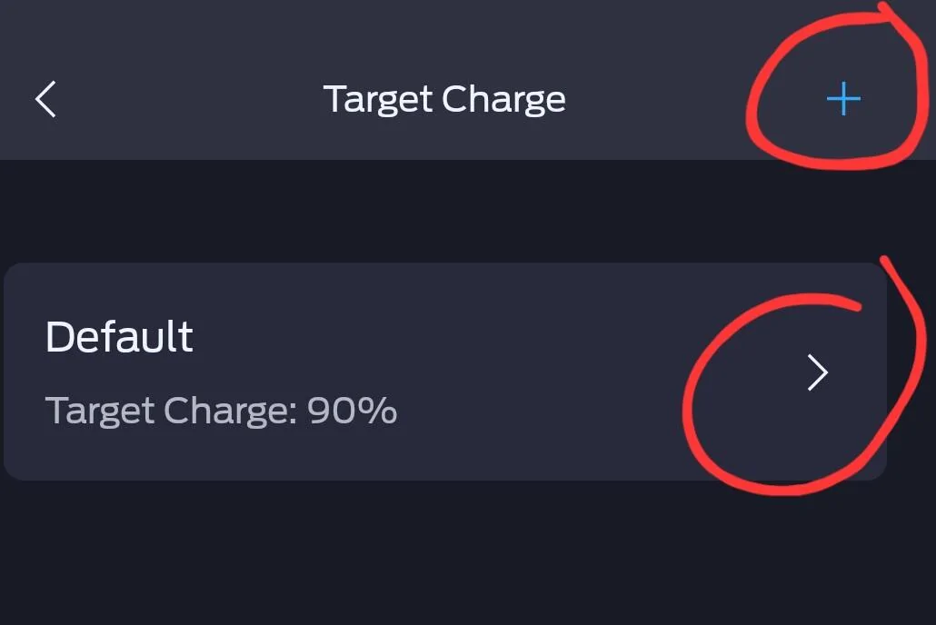

While plugged in and actively charging at location go to Target Charge
Ford F-150 Lightning OTA Software Update 10.3.0 - Powertrain, Battery, Parking Brake 1737938867348-qe
+ to add the location, if it doesn't let you, stop the charging to see if it allows you to build the location and SOC value.

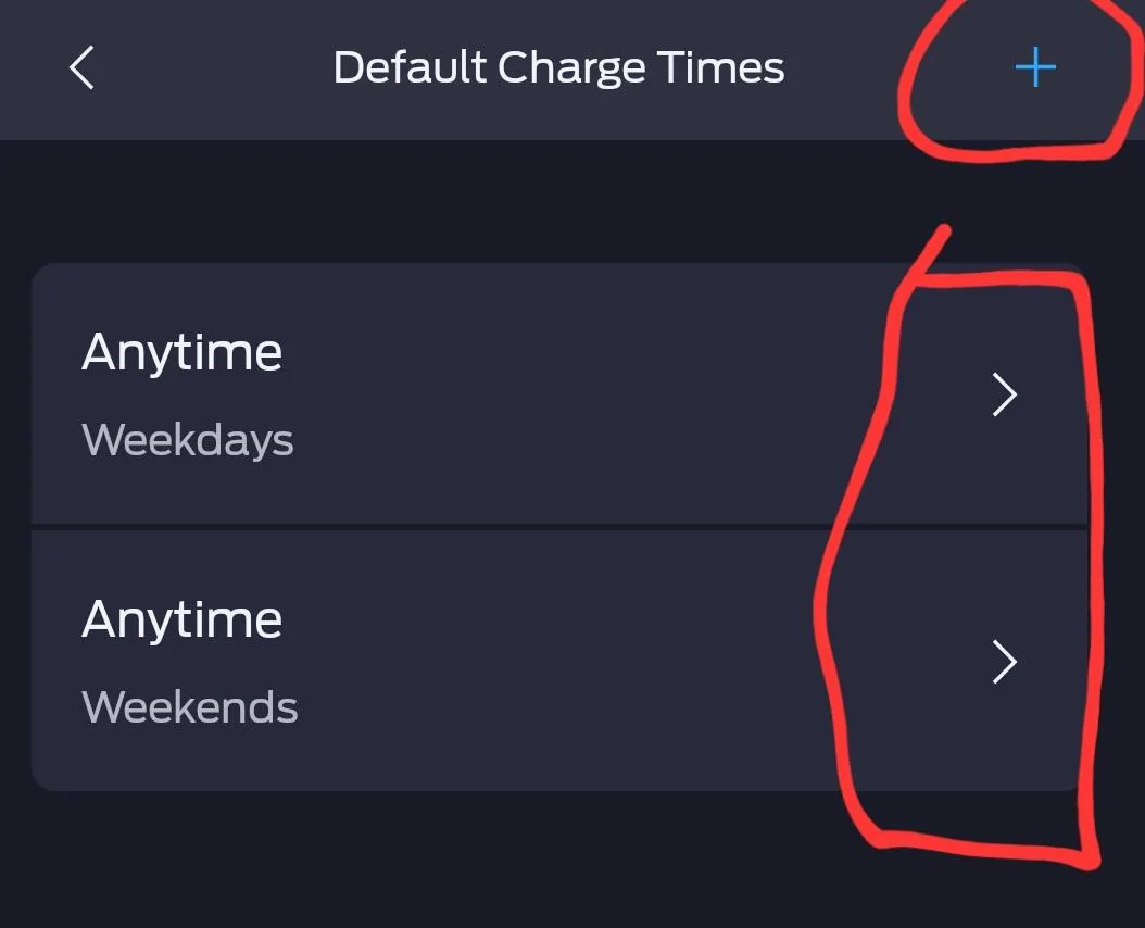

Then once created back up to the energy / charge section then go into Preferred Charge Times confirm it's set to anytime for weekdays and weekends, if nothing is listed start with + to build the first set of daily & weekend rules.
