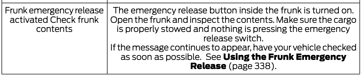

The primary release opened to the secondary latch and produced an on-screen red alert to pull over because the frunk had been released. The frunk did not open. It was caused by the internal 'kidnap release' when pressed by a jack handle for a large jack he was carrying.
This is where social media fails. The title of this thread is misleading and alarmist. As noted, only the primary latch opened, the secondary latch did not, and did not cause any issue. Yet post after post jumps all over this, and Google will pick up this stuff and amplify incorrect information.

There is no indication that it triggered anything besides the driver warning and primary latch release (probably). The owner's manual clearly states that the emergency release is turned on.
A quick look at the regulation posted above reveals that it requires the system to work while the vehicle is moving within five minutes, despite GM's request to waive. (Utah family driving around looking for their five kids unaware they were dying in the trunk, among other things.) I could see this as increasingly dire warnings and power reductions over the course of five minutes if the Frunk driver doesn't stop the vehicle.

Interesting, thanks for sharing. It looks like NHTSA made an amendment to account for frunk releases while in motion.
I updated the thread title to more accurately describe what happened. It seems that only the primary latch should release while in motion, assuming the system is operating correctly.
S4.3(b) For passenger cars with a front trunk compartment that has a front opening hood required to have a secondary latch position, actuation of the release mechanism required by paragraph S4.1 of this standard when the passenger car is in motion (at a speed of 3 km/h or more) must release the primary latch position, but not the secondary latch position. At all other times, actuation of the release mechanism required by paragraph S4.1 of this standard must completely release the trunk lid from all latching positions of the trunk lid latch. The passenger cars described in this paragraph are excluded from the requirements of this standard until September 1, 2002.
The agency notes that the amended text requires actuation of the release mechanism when the passenger car is stationary or moving at a speed of less than 3 km/h to release the latch completely from all latch positions, regardless of the previous state of the latches or whether the primary latch has been released during passenger car movement. Since NHTSA is granting this request, the agency does not have to address Porsche's request to provide manufacturers the option of disabling the interior trunk release system when the vehicle is in motion.

Here are the requirements laid out by NHTSA in FMVSS 401. You can see in S4.3(b)iii that for a front trunk the primary latch must be released and secondary latch must remain latched if the vehicle is traveling over 5 km/h. So, the system did exactly what it was required to do. However, there is nothing in the standard that prevents a transparent plastic cover over the button. It only requires that the mechanism can easily be seen (S4.2(a)).
Gotta love the internets...😉
S4. Requirements.
S4.1 Each passenger car with a trunk compartment must have an automatic or manual release mechanism inside the trunk compartment that unlatches the trunk lid. Each trunk release shall conform, at the manufacturer's option, to either S4.2(a) and S4.3, or S4.2(b) and S4.3. The manufacturer shall select the option by the time it certifies the vehicle and may not thereafter select a different option for the vehicle.
S4.2(a) Each manual release mechanism installed pursuant to S4.1 of this standard must include a feature, like lighting or phosphorescence, that allows the release mechanism to be easily seen inside the closed trunk compartment.
(b) Each automatic release mechanism installed pursuant to S4.1 of this section must unlatch the trunk lid within 5 minutes of when the trunk lid is closed with a person inside the trunk compartment.
S4.3(a) Except as provided in paragraph S4.3(b), actuation of the release mechanism required by S4.1 of this standard must completely release the trunk lid from all latching positions of the trunk lid latch.
(b)
(1) For passenger cars with a front trunk compartment that has a front opening trunk lid required to have a secondary latching position or latch system, actuation of the release mechanism required by paragraph S4.1 of this standard must result in the following:
(i) When the passenger car is stationary, the release mechanism must release the trunk lid from all latching positions or latch systems;
(ii) When the passenger car is moving forward at a speed less than 5 km/h, the release mechanism must release the trunk lid from the primary latching position or latch system, and may release the trunk lid from all latching positions or latch systems;
(iii) When the passenger car is moving forward at a speed of 5 km/h or greater, the release mechanism must release the trunk lid from the primary latching position or latch system, but must not release the trunk lid from the secondary latching position or latch system.
(2) The passenger cars described in paragraph S4.3(b)(1) are excluded from the requirements of this standard until September 1, 2002.
