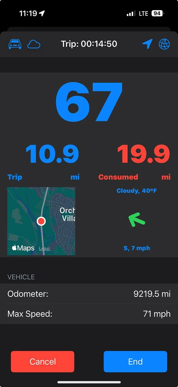

it is an iOS phone companion app for the Lightning and Mach-E so these aren’t useful suggestions.
I have never found the Ford calculated distance to empty to be anywhere close to correct (not to mention the discussions here). The last time I charged to 100% it said I had 345 miles of range, which just cemented my mindset of never relying on that number.
The GOM can’t predict the future so over the longer term. It is less accurate since it doesn’t know if it’s going to be cold and raining tomorrow, or if you’re going to be doing more climbing than descending, or if you’re encountering headwinds or tailwinds.
But my use case is over the very short term since I am interested in quickly observing that the difference in the distance to empty is deviating from the actual distance driven. Like this Rivian dashboard that highlights how off they can be.
Ford F-150 Lightning PID List to Monitor your Lightning 1748855926600-
I get what you are trying to do, thats obvious. My point is that the GOM isn't accurate, it isn't based on simply the driving history, so using it in any sort of calculation is a pointless endeavor.
It's not that it can't see the future, its that it isn't accurate even on the historical trend. The main reason is that it appears to be manipulated by Ford to give buyers the impression their truck will do the EPA rated range. It's not historical when it shows 345 miles of range at 100%,l when ones historical efficiency is below the EPA rating. That's a feel good number, not a calculated one.
The GOM has been doing this for quite some time now and although it appears to get closer to using real math when SOC is below 80% we can't be sure how true that is.
