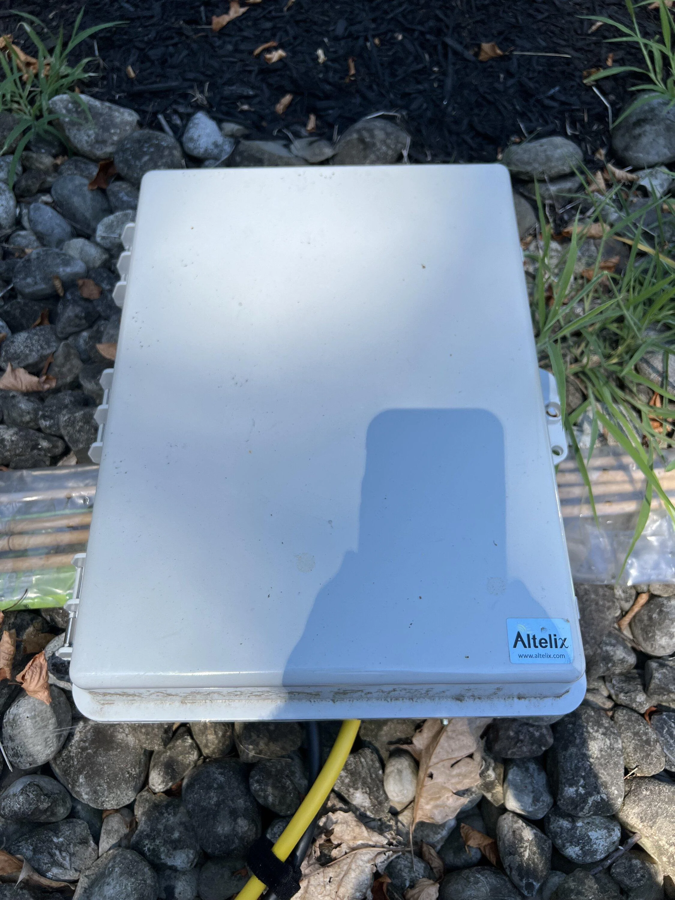

This is the underlying reason for the question. My wife has a Chevy Bolt and it defaults to 8A unless you change it to 12A. We use it every day since wife does 80 miles per day round trip, and we found that her level 1 works out for her. This is in a IP rated enclosure just to be sure there aren't any issues along with a 10/3 cord.
I do have 2 40A OpenEVSEs in the garage, however wife doesn't feel comfortable driving into the garage. I would love to park in the garage with my truck, but my truck is too high. So at the moment, I am stuck using the Level 1 from FMC.

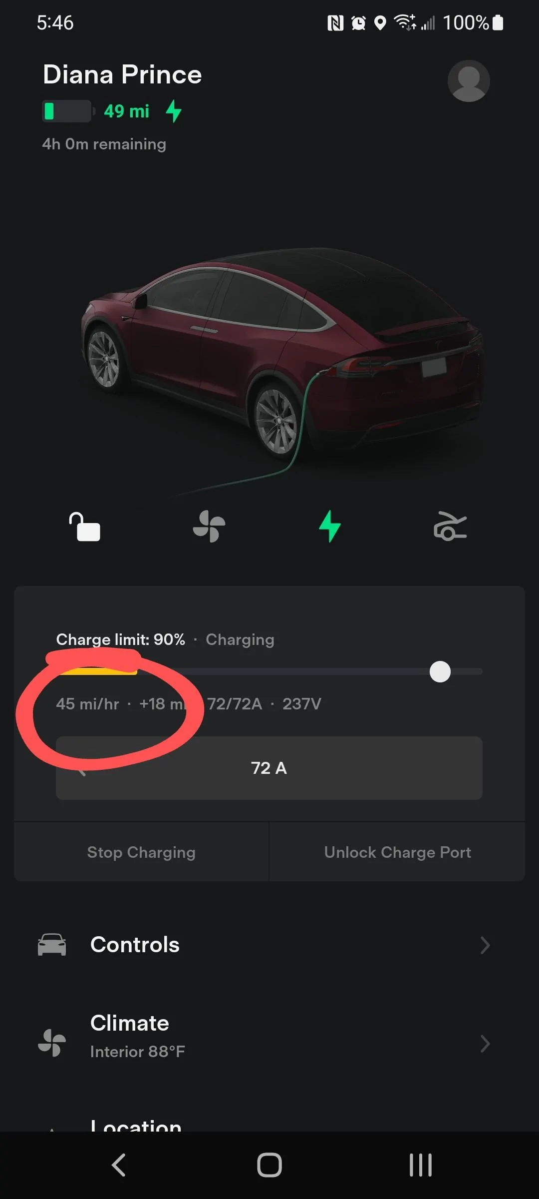

It's a Teslaism. Miles gained per hour of charging based on EPA range. I understand it puts kWh in the battery.
The observation in Tesla cars with 120v is that in winter, you get less kWh into the battery because the battery heater must run occasionally to keep it warm enough to accept a charge.
Ford F-150 Lightning Portable EVSE Amps over 110v/120v Screenshot_20220724-174644_Tesla~2
So yes, in my experience with other vehicles, during winter less energy gets put into the battery per hour vs. summer because the car diverts more to keep the pack warm enough to accept a charge. That's expressed as EPA rated miles per hour of charging but - as you notice - could be represented as how many kWh gets added to the battery.
