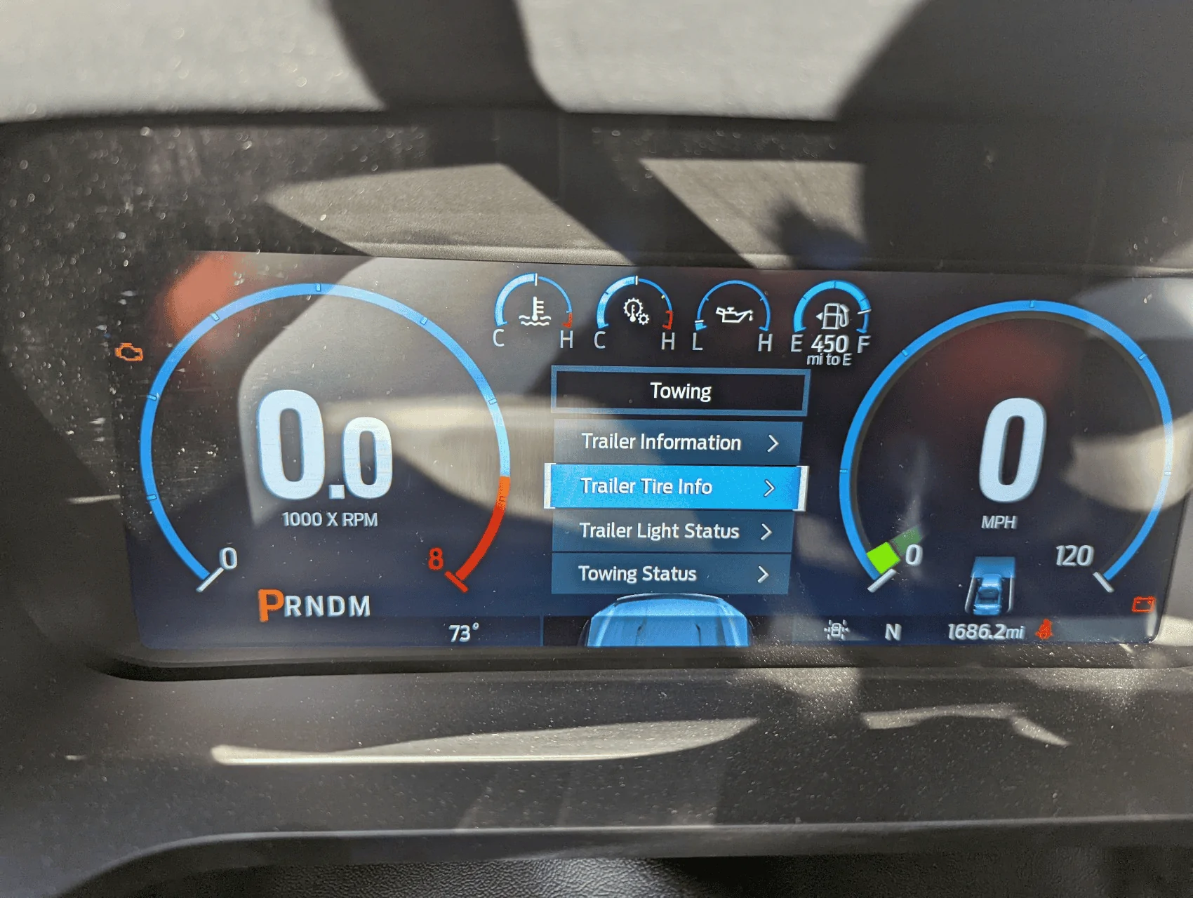

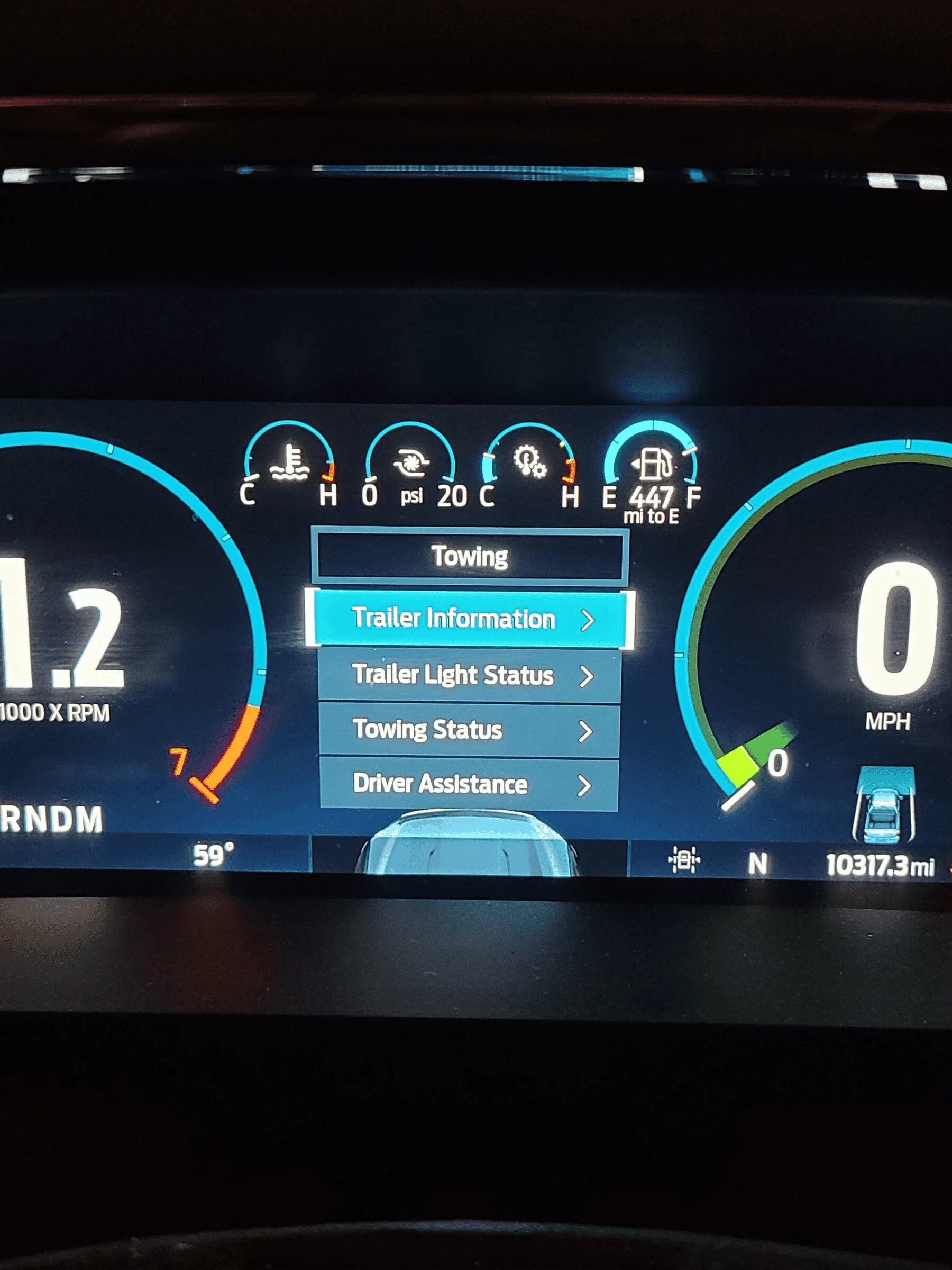

Dang, so that means we can NEVER get an update so that our trailer setup menu can use stickers? Or monitor the added TPMS? This initially got me riled up when folks were asking about installing the TPMS and how it says "no TPMS installed" on the "Trailer Tire Info" screen and us old timers had no clue where this menu option was so he posted a picture. The first picture is from a user wanting to install the TPMS (and I believe also had the sticker option), and the 2nd picture is MINE that has never ever had this "Trailer Tire Info" sub menu option.
So that's why I started thinking that the cluster head unit has nothing to do with the Sync head unit as far as updates. I don't really care about the TPMS but if I'm missing *something* then I'm missing possibly other things I really want like BED CAMERA WHILE DRIVING. At least Ford acknowledged that the limitation was silly and removed it but not removed it for all :(
I can’t say never. As of now there isn’t. There could be many updates coming. The ipc is on the Ethernet so OTA is possible. The camera in motion is available for all now if you take your truck to get the ipma updated. It takes 3-6 hours.
The cluster is odd because apim updates can affect its perceived function while it also has its own updates that will affect it also. The apim update added CarPlay directions in cluster. So that’s a perceived ipc update that was actually an apim update. Same as the phone contacts in cluster with CarPlay.
