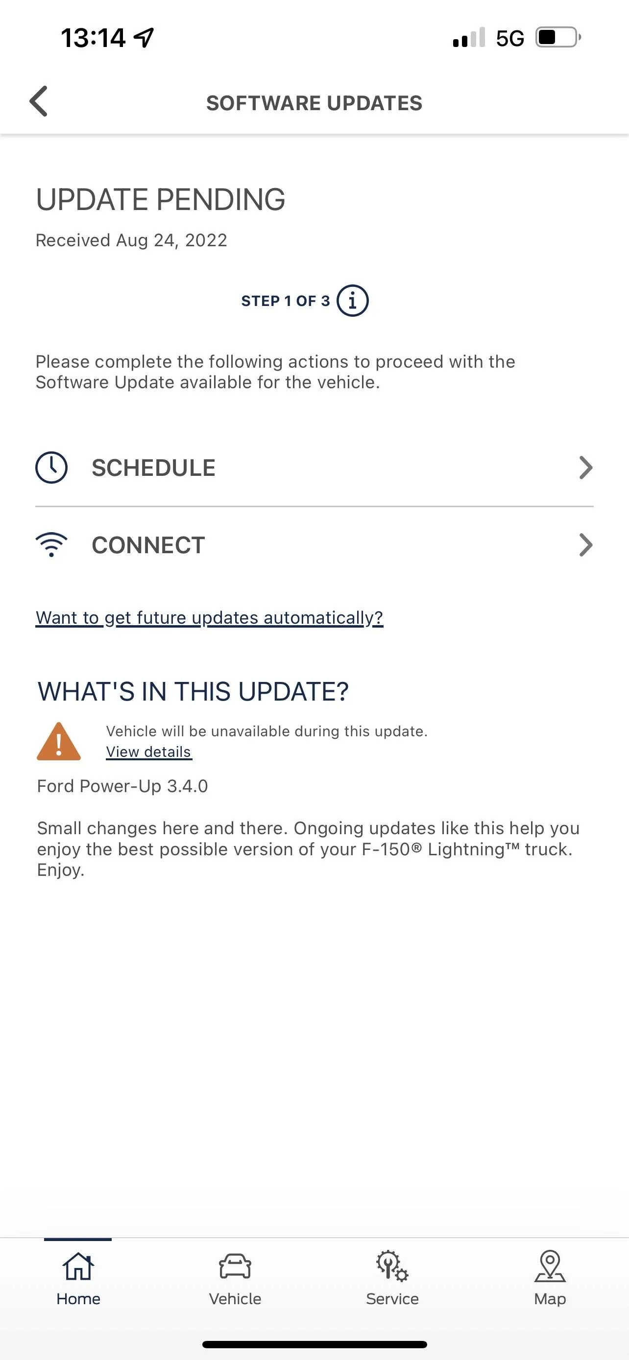

Software update is pending. This doesn’t seem to install, and the app says the update needs to be scheduled but I can’t get onto a schedule screen.
This is the same problem that many of us have had on this 3.4 update. Going to your settings and set it up for automatic updates everyday and connect it to Wi-Fi. Doing both of those should help. Mine finally took on the 3rd attempt.

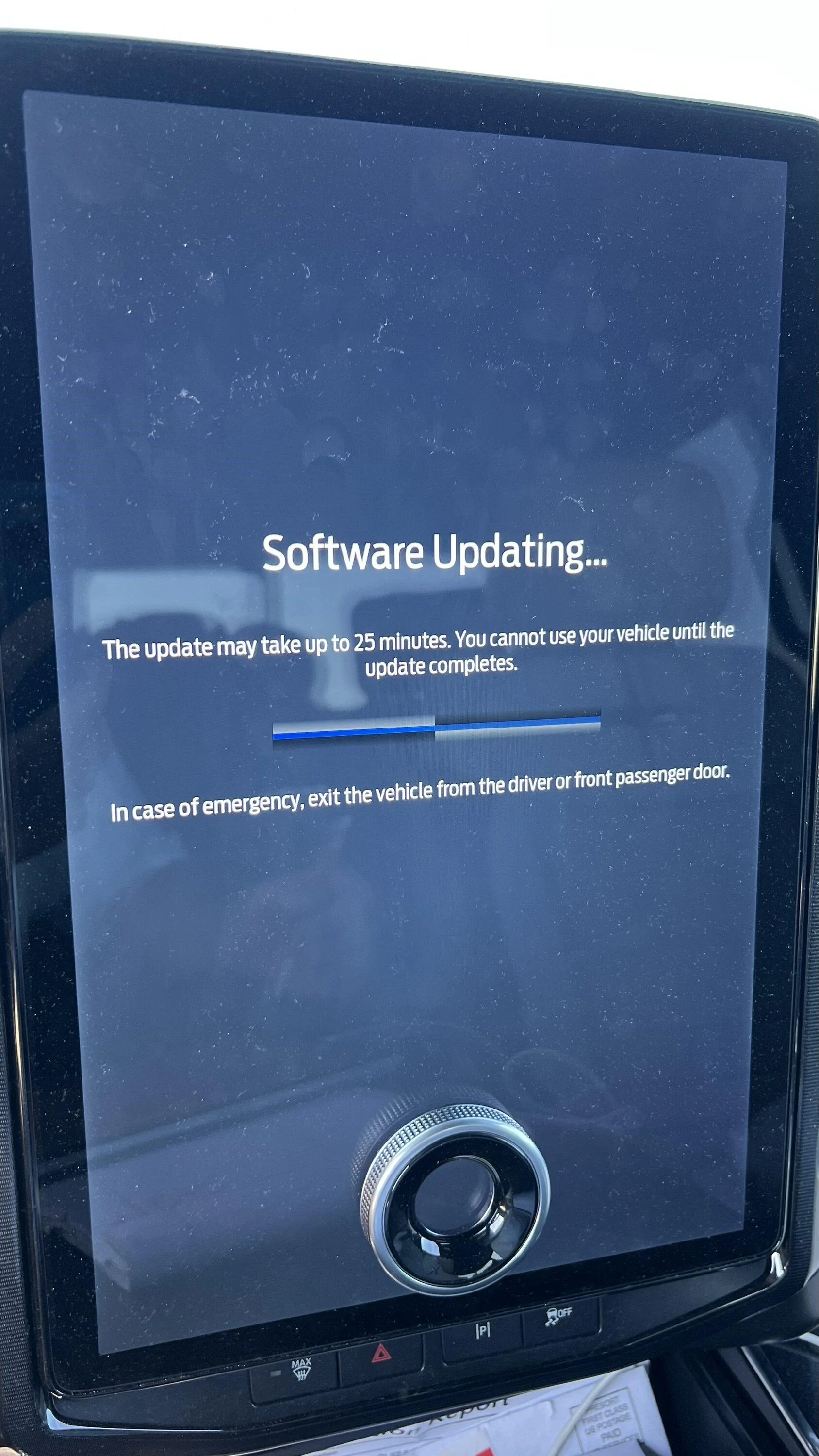

Software update Successful.

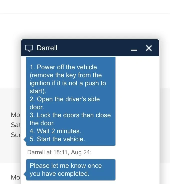

I got instructions from Ford chat…. Same procedure that davidf01 used.
First I would like to preform a Key Cycle. To perform a key cycle:
1. Power off the vehicle (remove the key from the ignition if it is not a push to start). 2. Open the driver's side door.
3. Lock the doors then close the door.
4. Wait 2 minutes.
5. Start the vehicle.

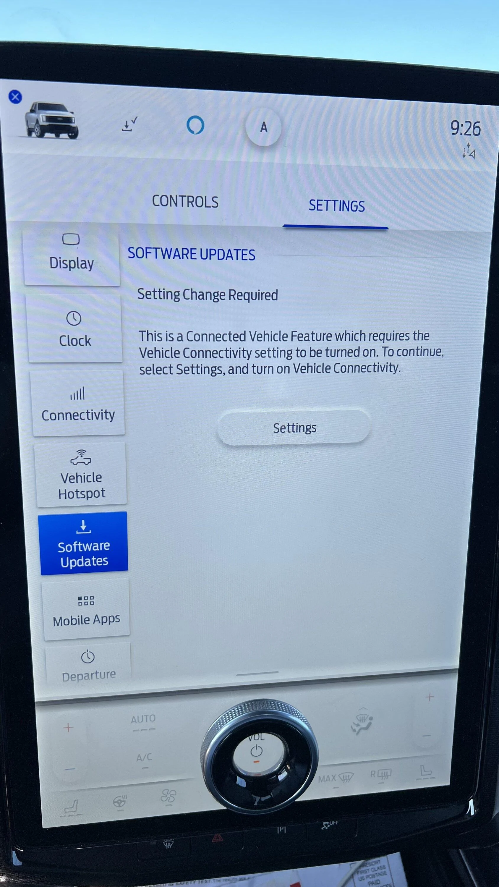

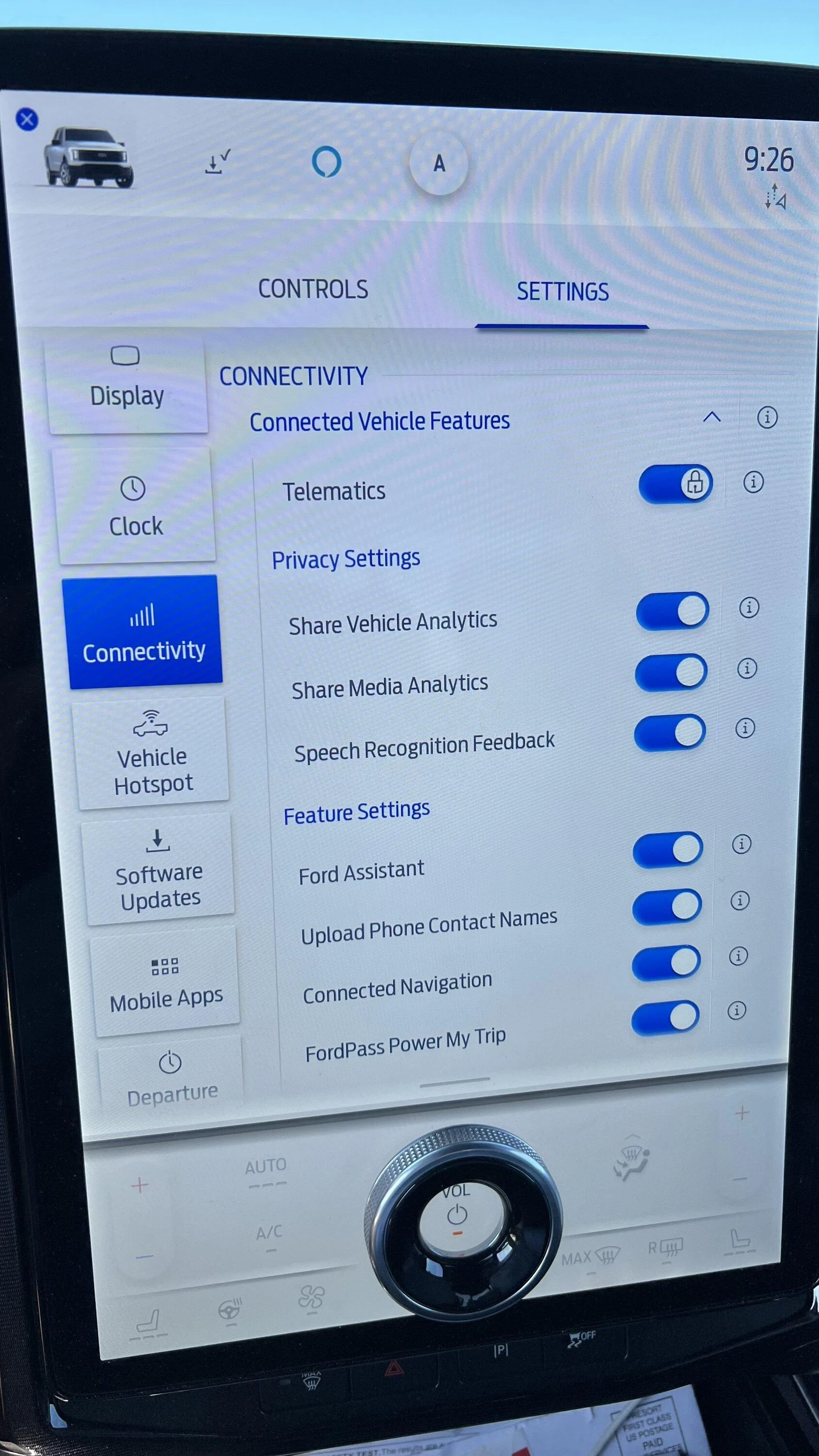

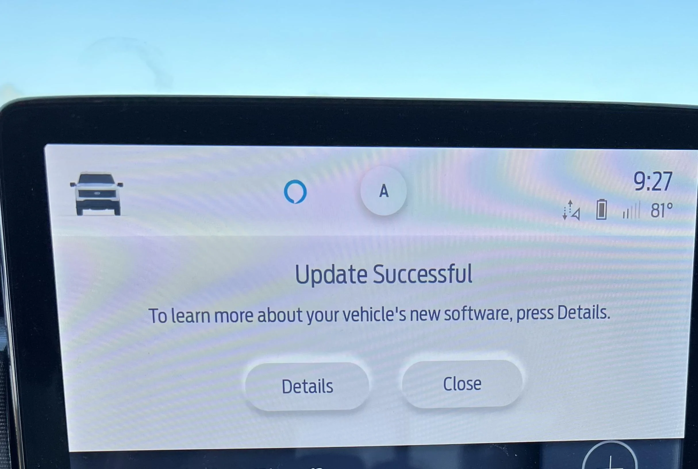

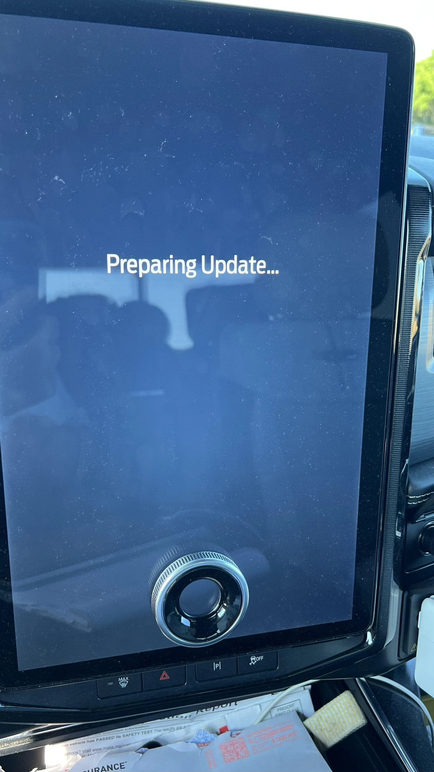

I followed this procedure and it failed to update. Next day,today, I tried it again. I wasn’t at home, I wasn’t connected to Wi-Fi. I was still getting an error of “settings change required” but it did proceed to install the update, see attached photos. All of these settings were already in the on position. I rebooted Sync and then it displayed “update successful”.
4. Wait 2 minutes.
So you note you did the same thing as @davidf01. David had a very specific problem where he didn't have the auto update and scheduling buttons. Are you noting you didn't have them either and this procedure fixed those, or you did this procedure regardless and then you magically got the update? Just trying to separate the problems.

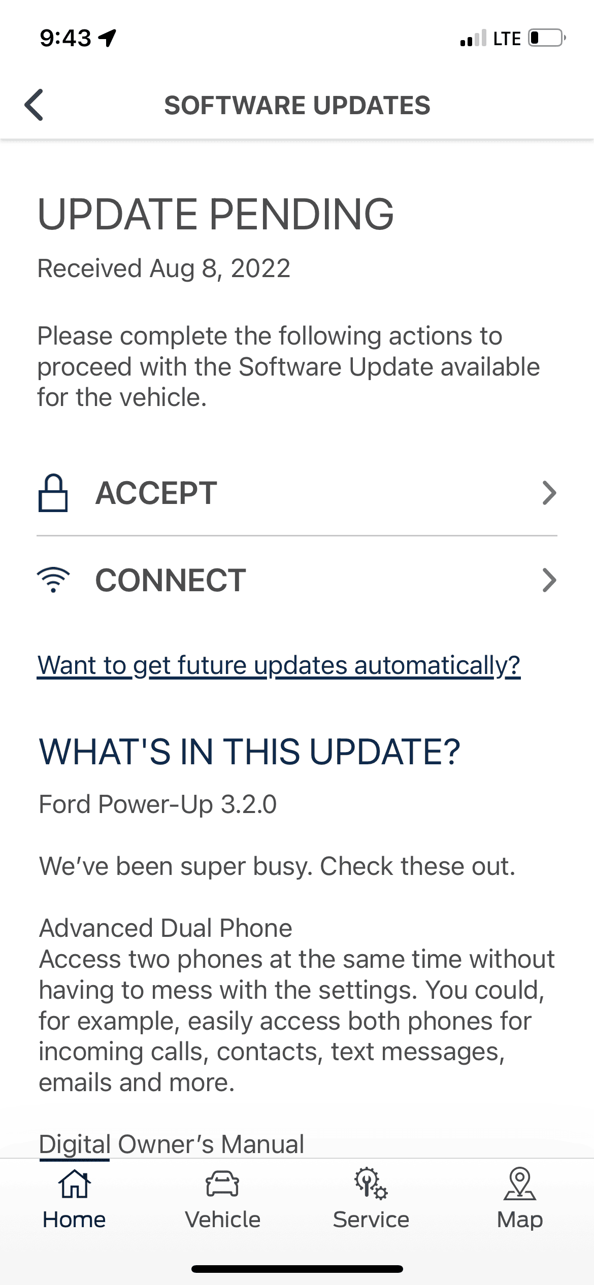

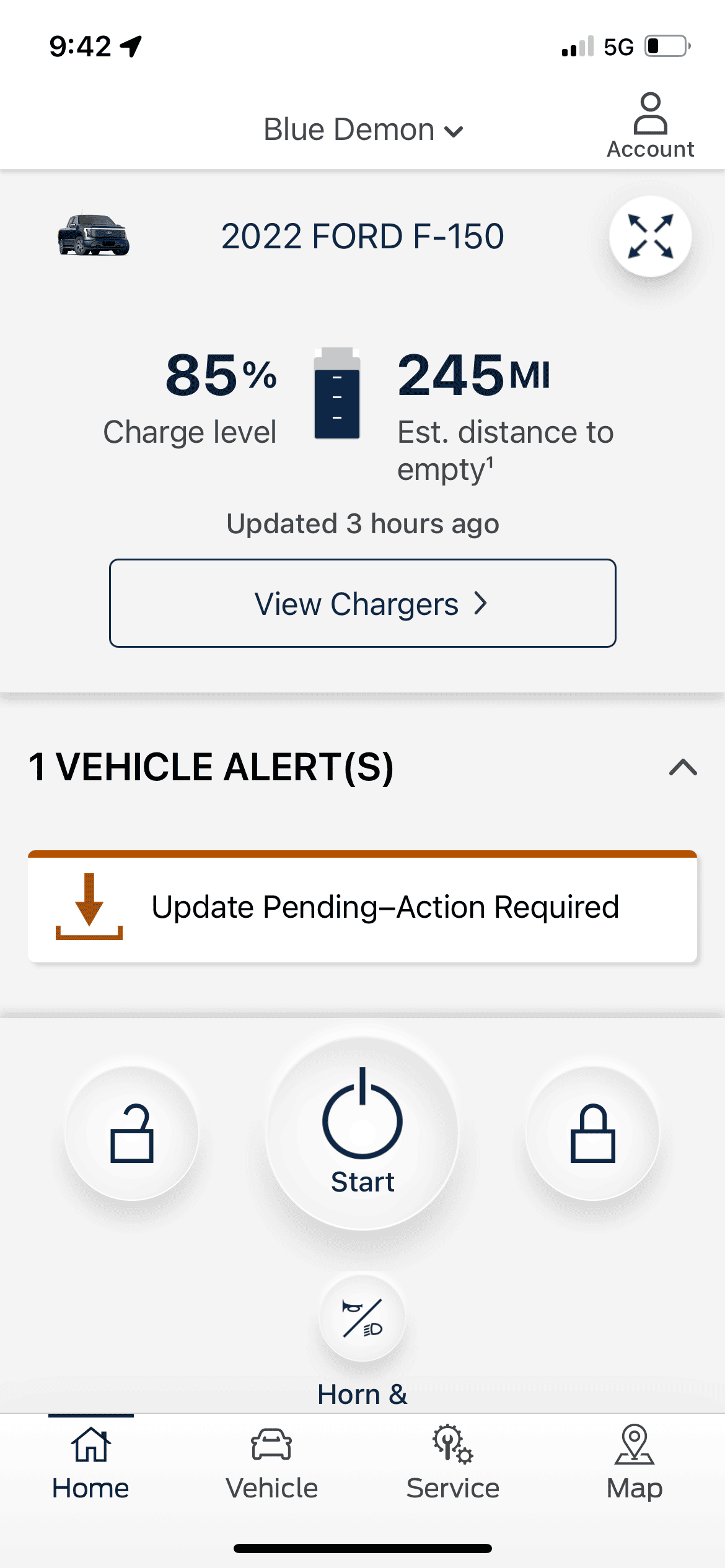

Trying to trigger this update tonight I reset several modules using Forscan, including APIM and the Gateway. Nothing happened in the truck. Just a bit ago I opened my app to see that it tells me I have an update waiting, holy heck.
Well clicking further it tells me it is 3.2.0 and the message is actually dated August 8, but nothing I can do will install the update and the truck doesn't think an update is available. This is beyond sad for Ford.
