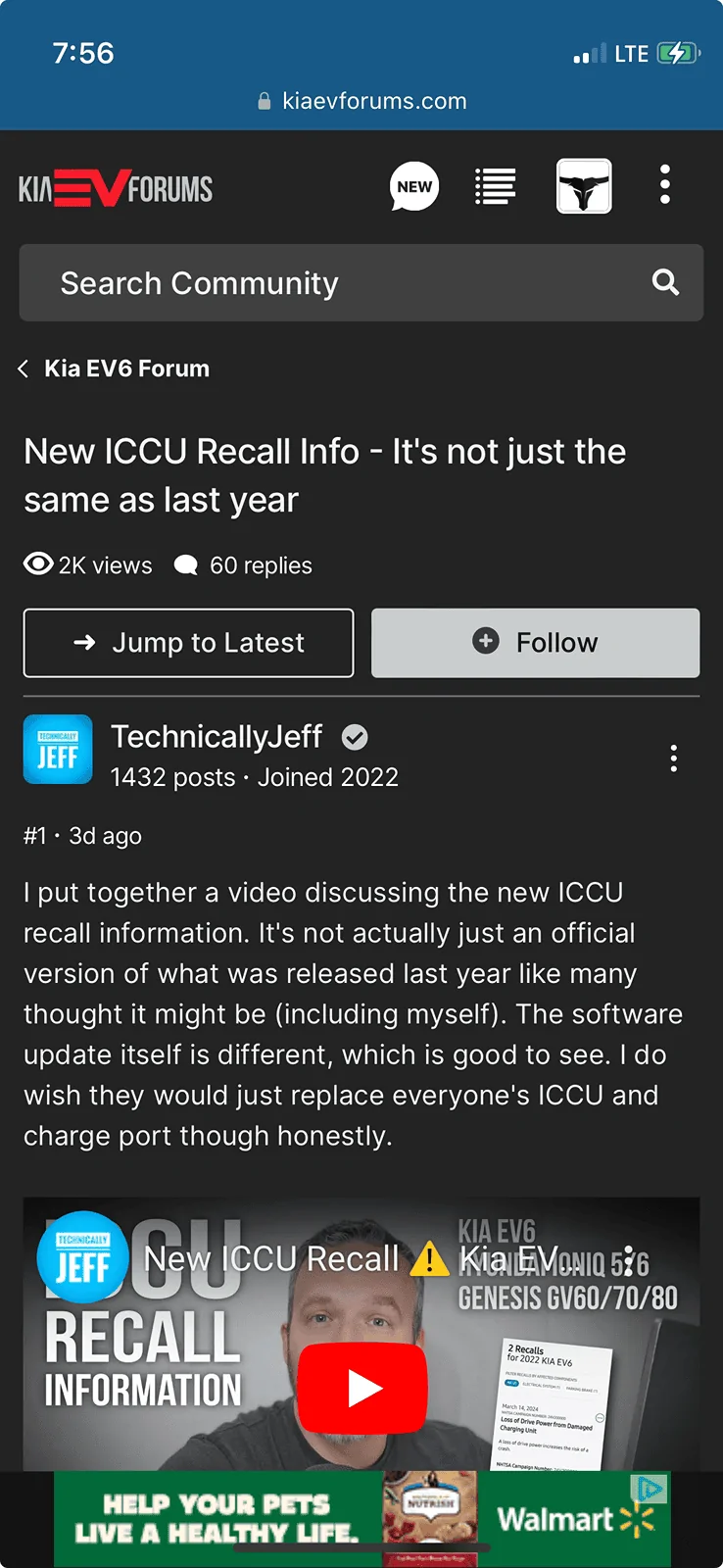

I wish I could say it was a small problem only affecting FORD, but would be a lie. Following the KiA Forum for wife’s EV6 we just purchased.

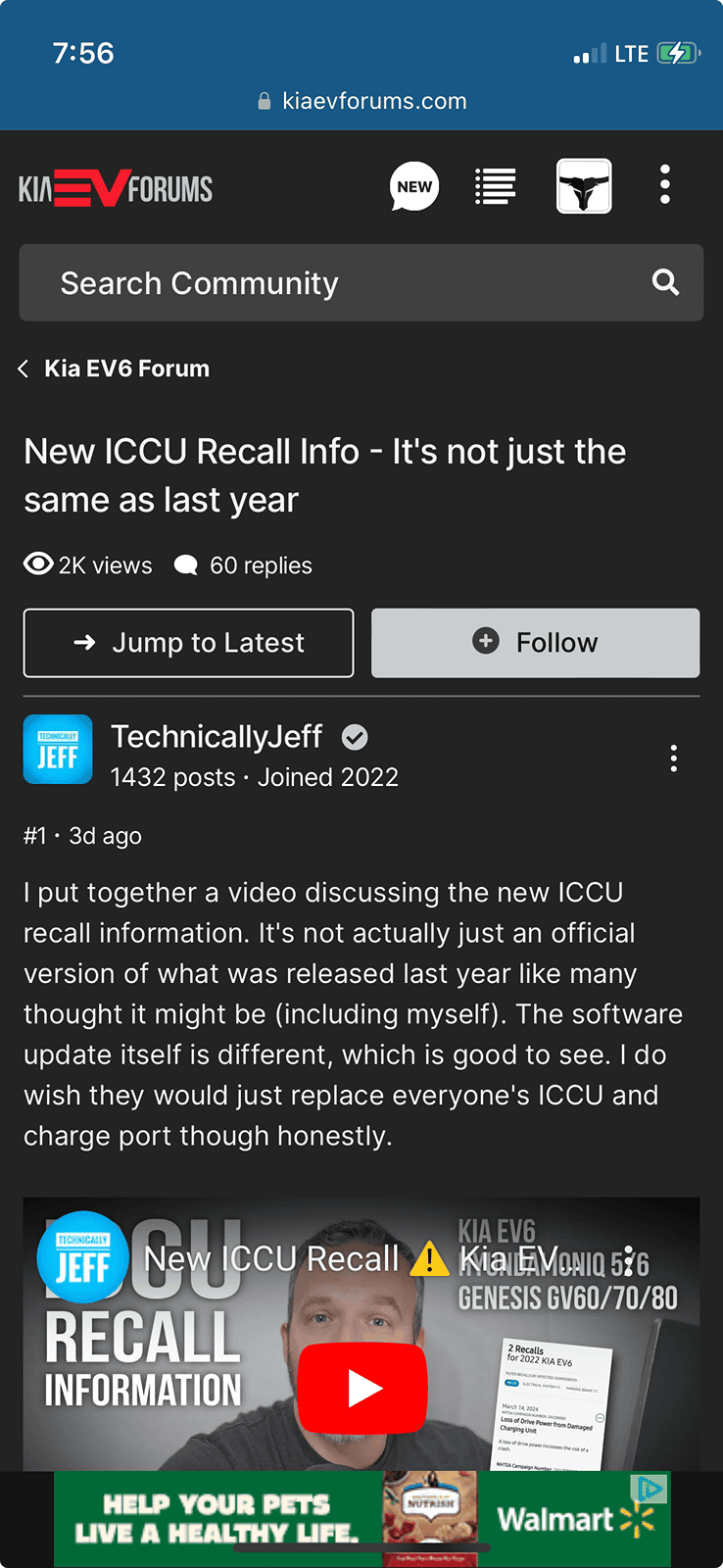

This is separate issue that is also plaguing the KIA EV’s. Similar to the BMS for FORD, but bigger. It causes the vehicles to stall out.

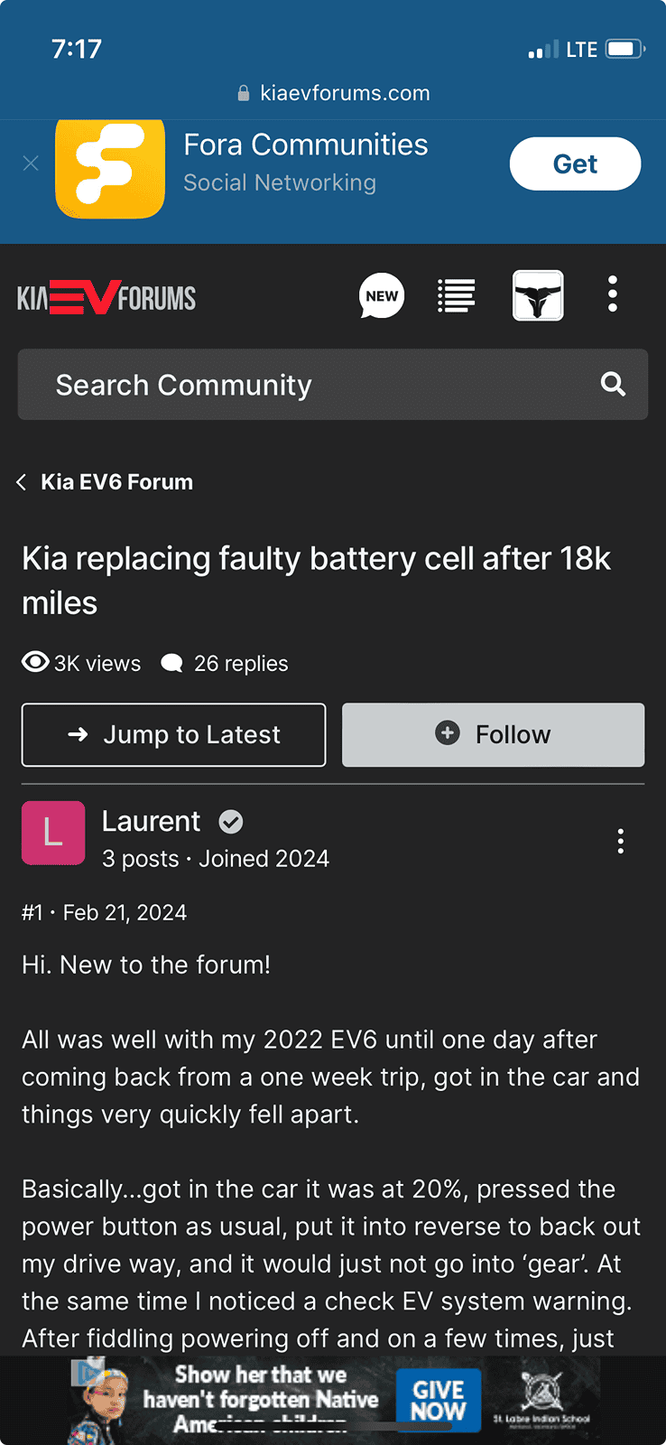

It’s always tough to get an idea of prevalence with online forums. I bought my EV6 almost two years ago and just helped my mom buy an EV9.
By the time I sold mine, I could only find a single thread complaining about battery failures. I checked again through the Kia EV forums in late December before mom’s purchase and could only find one or two more. The EV6/Ioniq5 are some of the top-selling EVs in the world.
Compare that with this:
I am counting at least 162 battery module fails reported in this forum. About 52 in another forum. And 22 in the last few months reported on Facebook.
This article shows about 40,000 sold in 2022-23:
ford-f-150-lightning-sales-numbers-figures-results-fourth-quarter-2023-q4
So we see about 230 units, that we know of, failed which would be about only 0.6% of trucks have had a battery module problem so far.
Nope. I’m afraid they’re not even in the same ballpark
