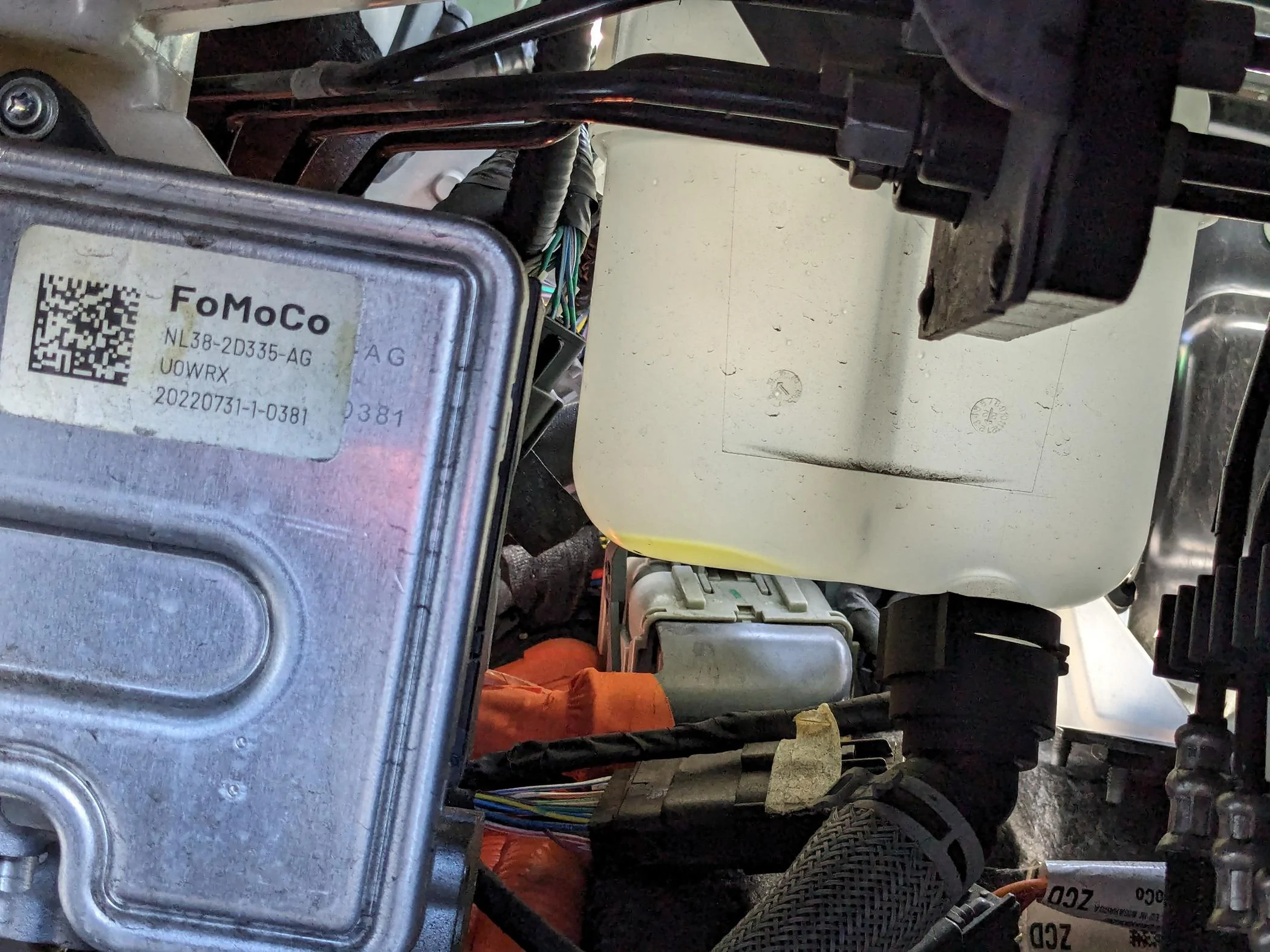

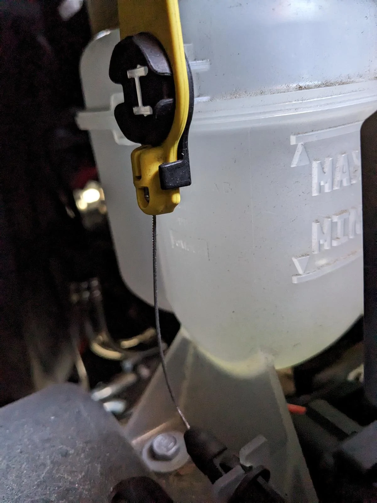

Had the truck back 2 weeks. Was grabbing something out of the frunk and poked my head in to see the coolant level.
All coolant has gone... Somewhere...
@Ford Motor Company who's gonna compensate my time for dealing with this? I know the dealer will remedy, but I don't have a day to deliver, Uber around places, and then pick up a vehicle. Maybe send people home with a jug of coolant if they're not going to bleed air out of the system properly??
I'm thinking it has been noted that there could be air in the system and as that works it way out, it will empty the reservoir. Thinking they needed to give better instructions to check it or stop back by.
