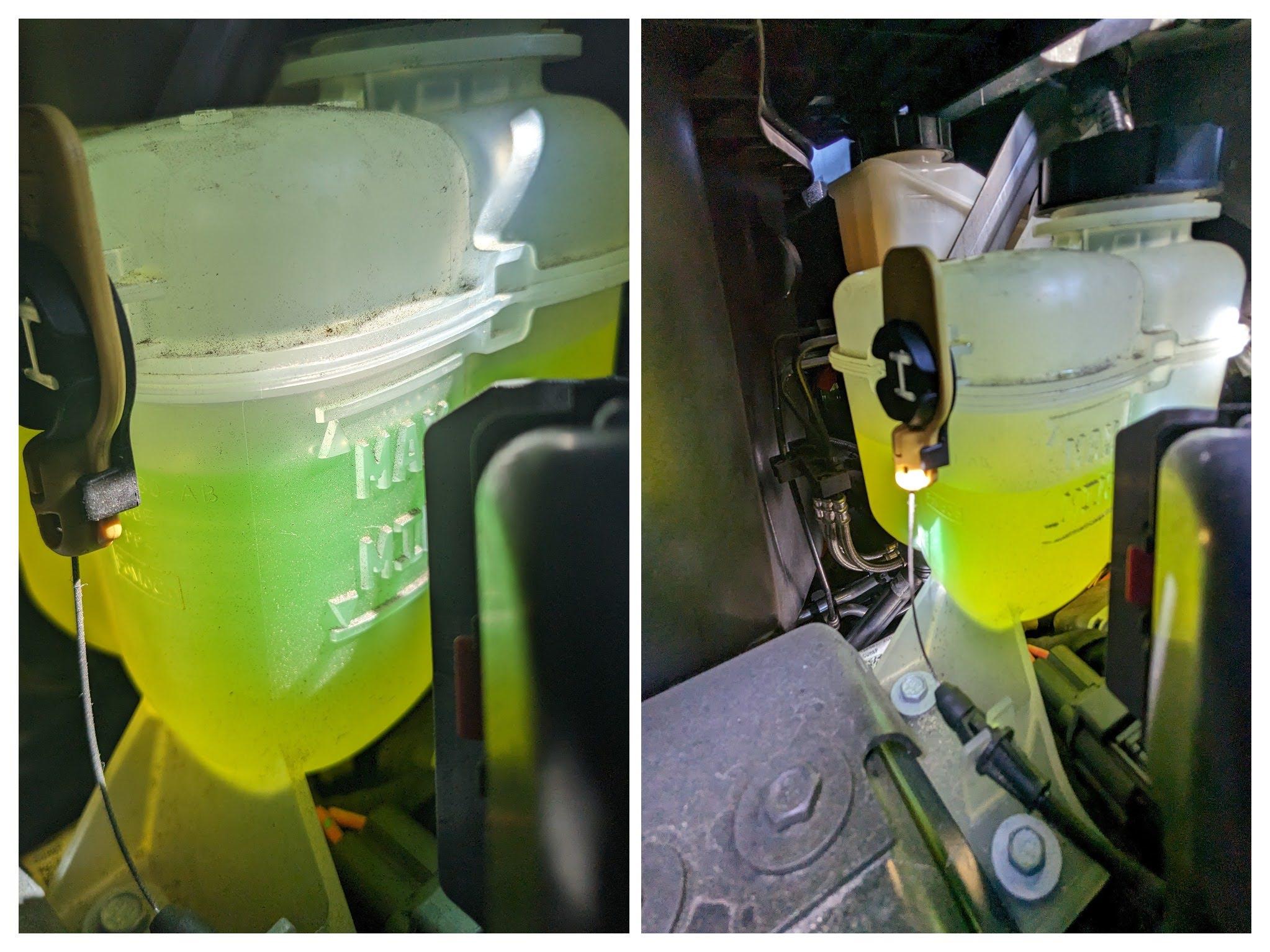

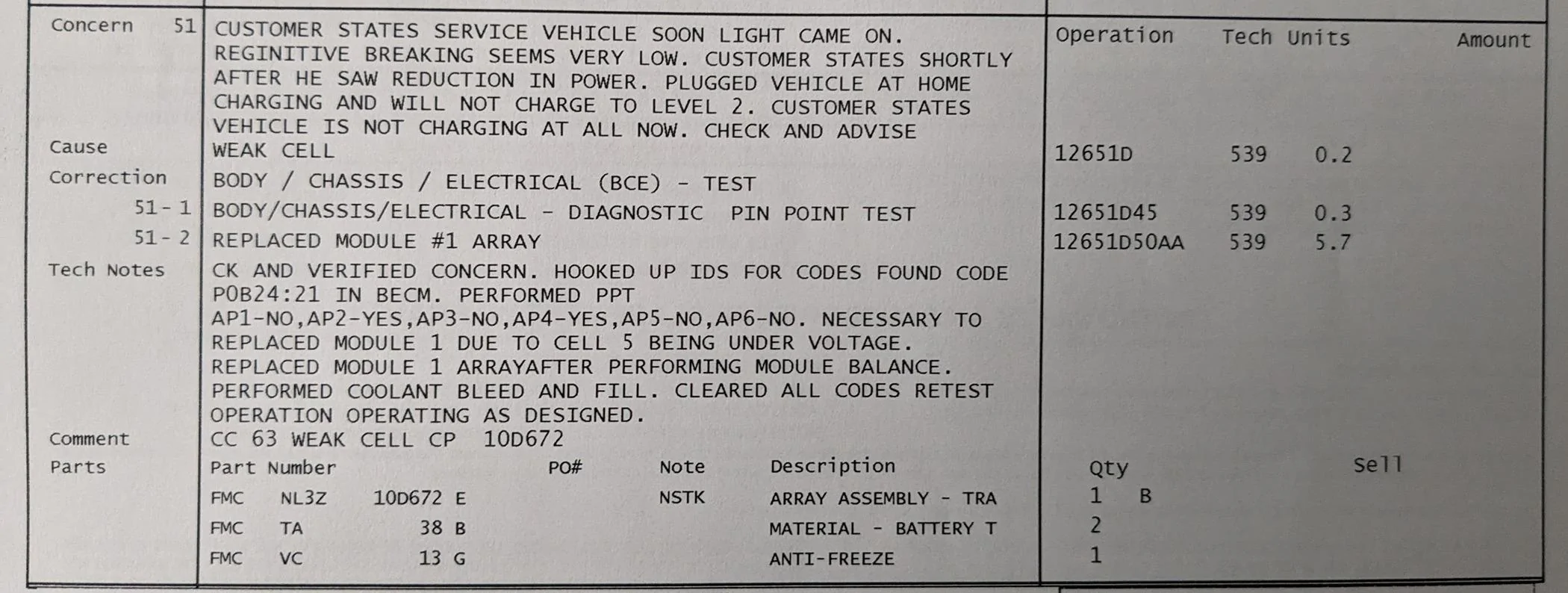

Ok, got her back today. 17 days to replace the module. Dealer, I will say, very communicative, gave a loaner... happy overall. Little disappointed they didnt do the 12v BMS recall or the pending software recall. We discussed both, but neither made it on the ticket, so they didn't get done.
All that said... I kinda have doubts they finished the repair correctly. I got the truck back at the same SoC I delivered it at. Its pretty clear it wasn't road tested (or wasn't tested much). I noticed when I dropped it, the coolant was near empty. When picking it up, it was at MAX. But after plugging it in to charge... its clear there is air in the system and the level is dropping quick.
Pickup from Dealer (left); As it sits 5 miles later charging in my driveway (right)

Copy of W/O

This sound like air to you guys?
