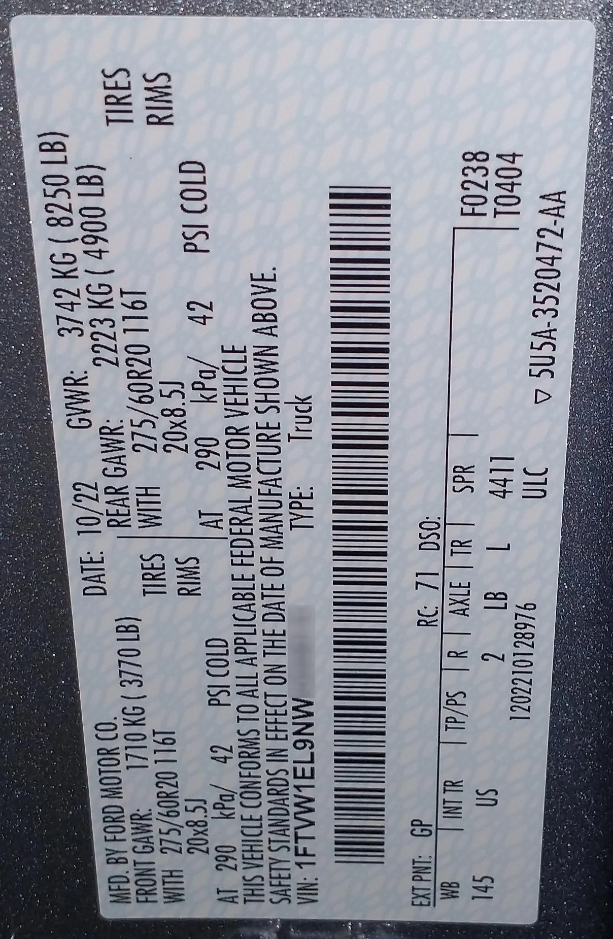

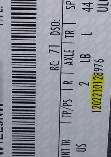

top line of VIN sticker at driver's door:
IMG_20221117_203739733 VIN sticker inside door Ford F-150 Lightning XLT 1ftvw1el9nwg09816 gvwr...jpg
Also the planned blend day is on the bottom center, 10/12/2022 in this example

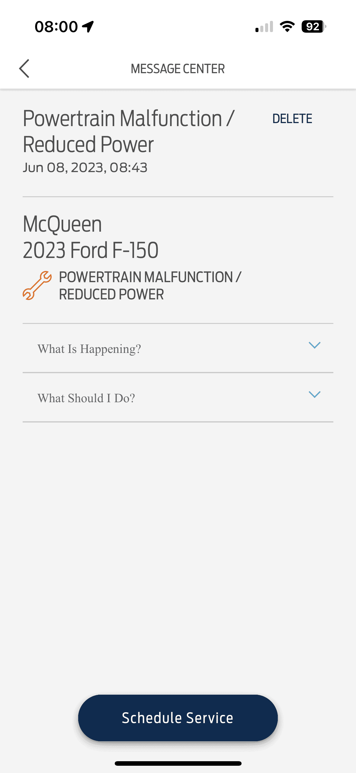

I had this happen once early last summer:
Ford F-150 Lightning Powertrain Malfunction/Reduced Power Poll IMG_0623
I cycled truck and it’s never happened since - but it did go thru several Ford OTAs and minor recall work at the dealer since then. Also, I believe this happened right after an OTA and others on the forum indicated that they saw it happen close to a OTA. So not sure the root cause but but truck now has almost 32,000 miles and no issues.
