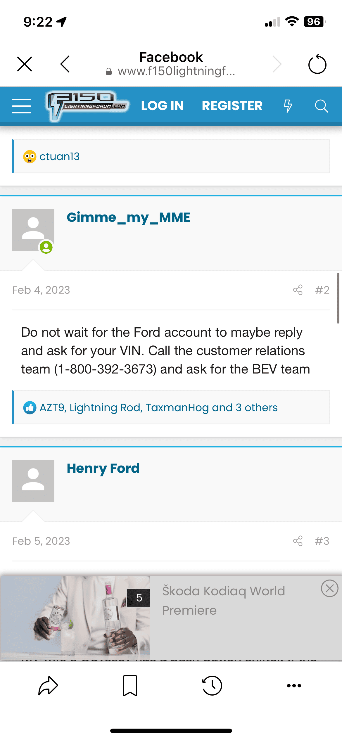

You need to call the Ford EV support hotline and tell them you need a truck.
87
3,409
4,258
oh theres a hotline! where could I find that number?
This is from here on the forum, I made a phone screen shot of it. I don't recall the thread it was in.
Ford F-150 Lightning Powertrain Malfunction/ Reduced Power IMG_5503.PNG

Ford BEV Team: +1 800-392-3673
Came across it in one of these posts and saved it as a contact jic.
