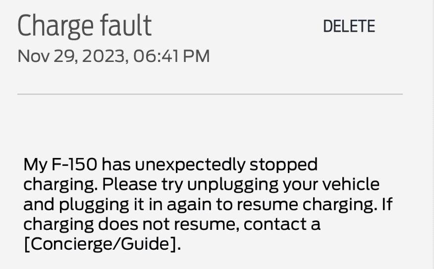

Well, it finally happened to me too. XLT SR with 8k on the truck, morning after the 6.8.0 update had powertrain malfunction on the app and service soon on the dash. power reduced to only 53% so still drove just fine, called the dealership and they said give it a couple days if it's driving soon and see if theres a new OTA or it clears but now I have a charging fault on my home charger and won't charge.
guess I'm going to try DCFC to see if I can get through xmas before having to bring it in.
I am sad about it.

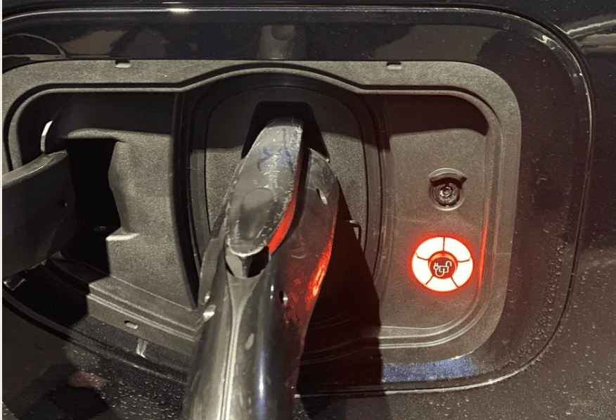

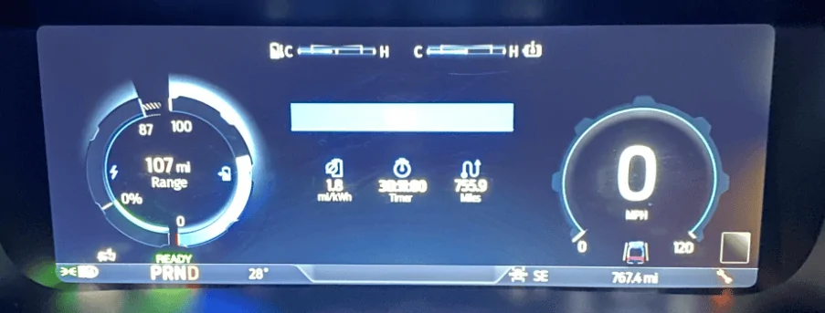

Thank you TaxmanHog for your reply. I truly appreciate your help. My original problem started Sunday evening and hasn’t changed. I haven’t received any updates or notices that I’m aware of.
My current SOC is 53%. I’m attaching pics.
Update:
after a three week wait for my repair they “fixed” it by installing critical updates.
It drove fine for about five miles then the Powertrain malfunction warning came back with the red ring of death.
They are closed up for the holidays now. No tech available for 4 days.
getting really upset with the situation at this point! Back to the DCFC I go.
