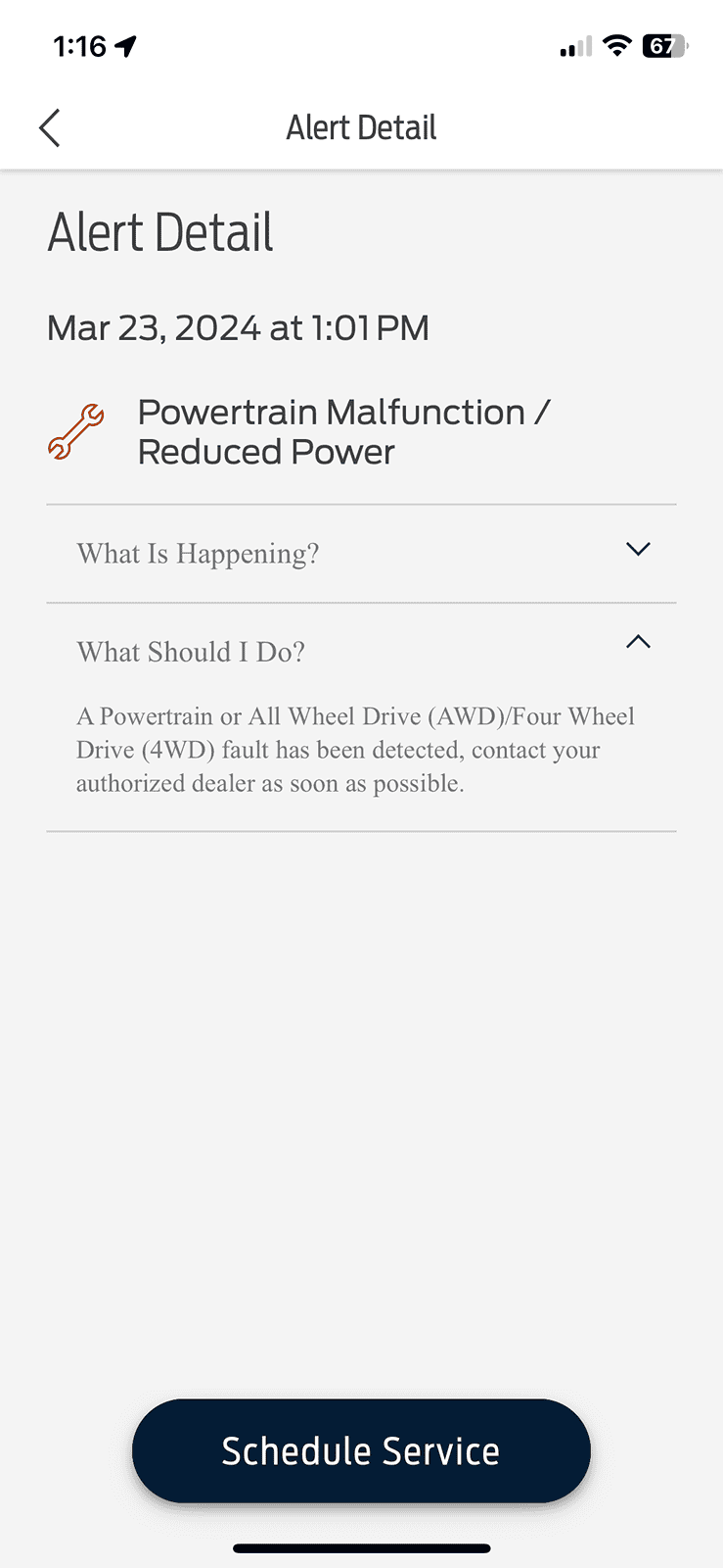

I gotta be in the top 1% of least lucky Lightning owners out there. @Ford Motor Company. Lightning stopped charging yesterday, threw a wrench and limited power to 53%. I read the code (forgot exactly what it was) and it referred to unstable voltage. I deleted the code and hoped it was a fluke. It came back immediately. Just dropped it off at the dealer. This is potentially the third module that is going to be replaced. This is becoming a running joke. I’m going to press the dealer hard to replace the whole battery or else I’m going to lemon law it. So disappointed.

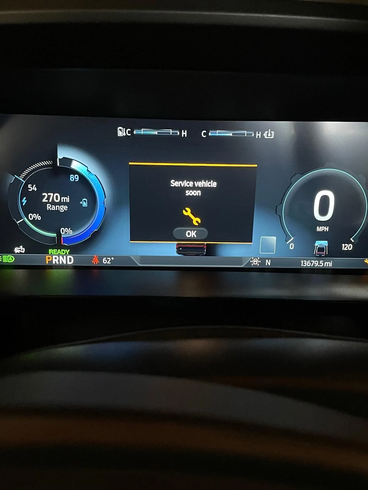

I was blended on May 24, 2022. That was the day or day after the factory came to a stand still for a few weeks. 13679 miles. Charged to 90%, unplugged and got into the error message and reduced power to 54%

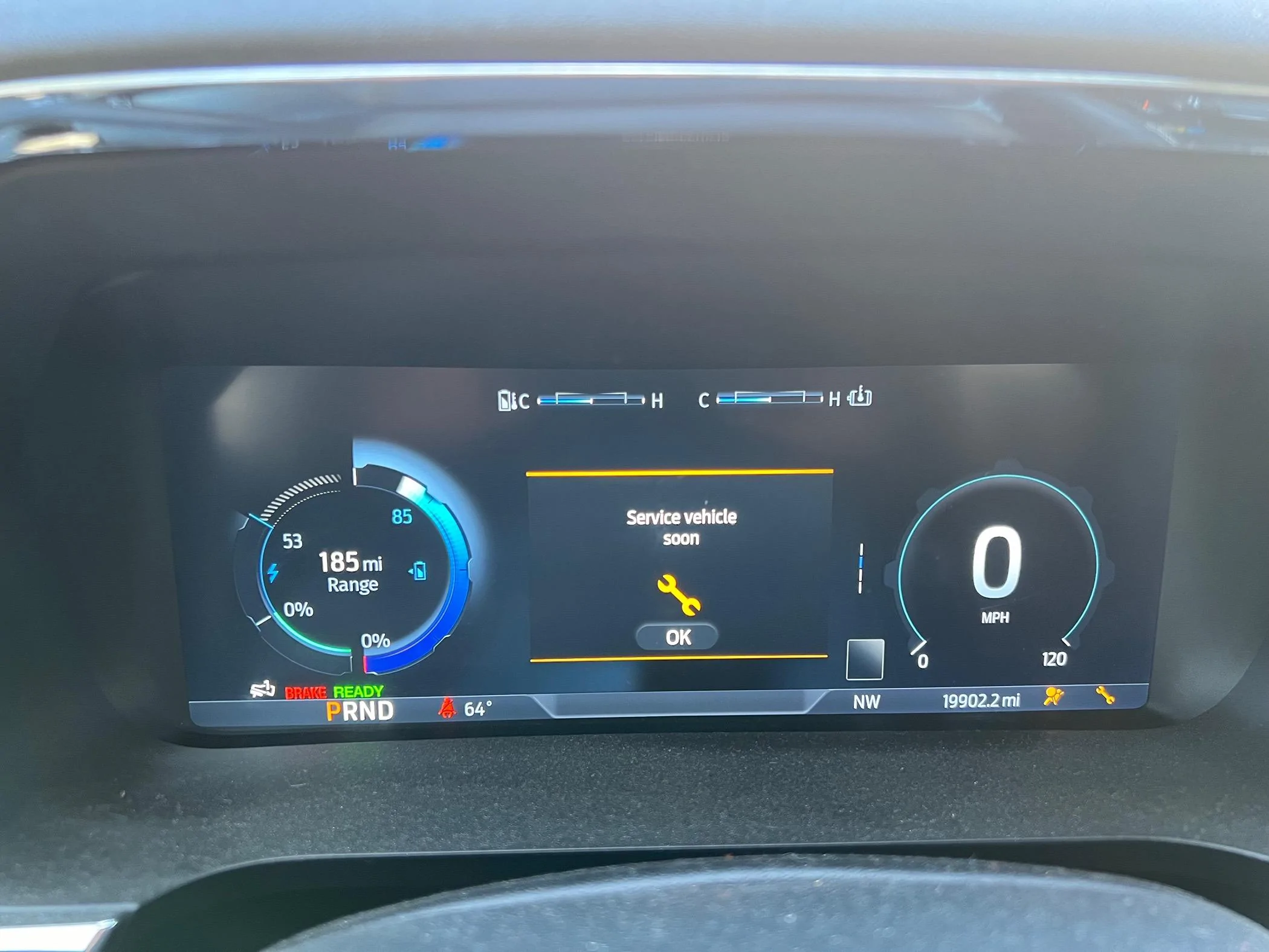

I have the same issue here as well. I don't live near a Ford dealer so I called around to get an service appointment before having my truck towed. They said they had an opening the next day. Truck towed, and then was called and told it would be 4-6 weeks before they would even look at it since the EV service guys are that backed up. Filed complaint with Ford. Will update more when I have it.
