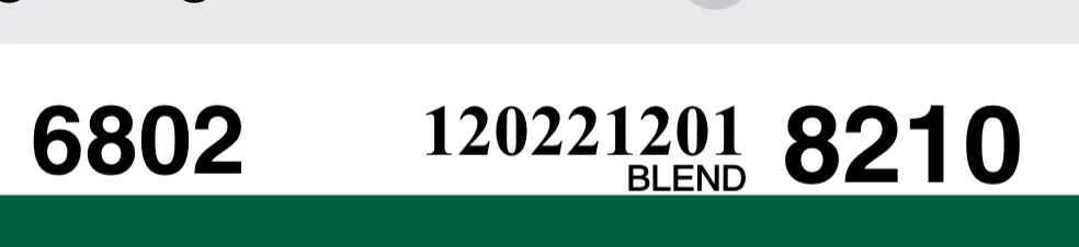

is the above indication my build date:
120221201 = December 1, 2022 build date..??
still not sure I’m understanding exactly when my 2023 was built. I purchased it on 01/16/2023. Thank you.
Yes that’s right. The last 4 numbers are your month and day. Mine was 120221102. So my build date was 11/2/2022. Technically though that’s just the start date. It gets built over the following week or so.

The blend date is the ~planned~ date everything is going together, it's usually accurate except when it's not, that is why I intently watched the modules popping date, that was a sure sign that our trucks had just transited the main line.
