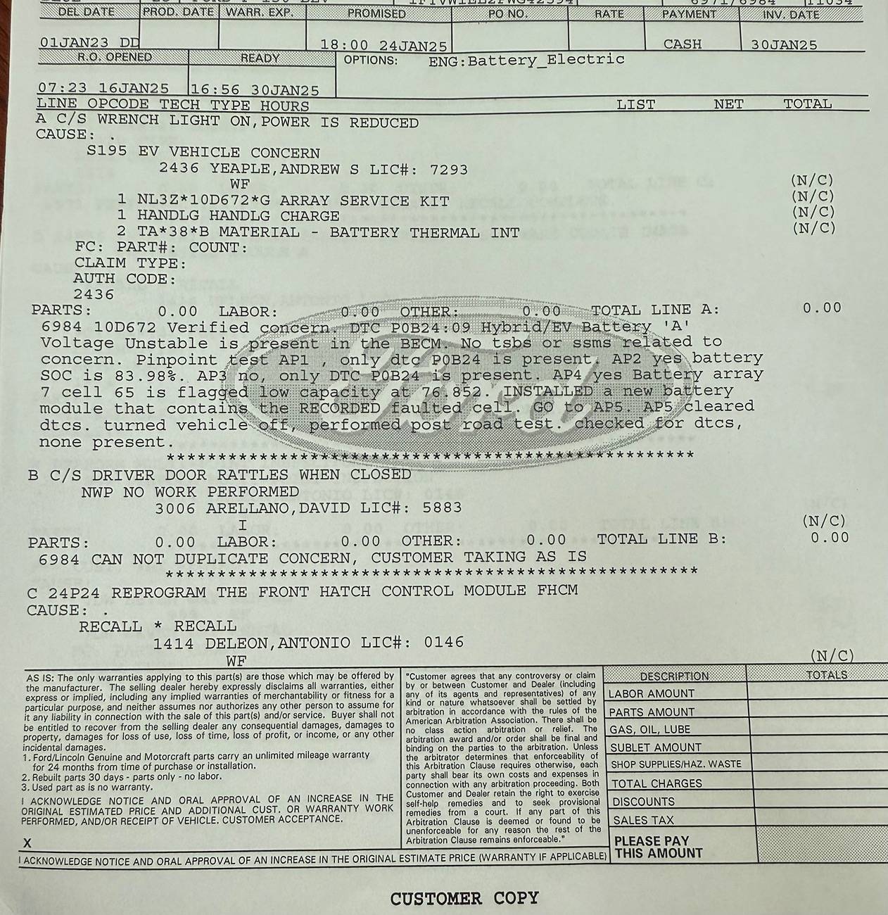

Just spoke with my service rep, the battery array is on back order (sigh). He didn't have the proper part ID to give me but he said they are on backorder until early Feb to Detroit and will be shipped to AZ then so probably will be in my loaner for 2 weeks which I pick up tomorrow. My dealer told me the part doesn’t come from Ford directly but a third party so they have no exact eta. Just guesses
Welp…..if you have been following my saga. Dropped of 1/16. Vehicle diagnostic 1/20, module 7 array 65 failed. Part ordered. Was called 1/24 saying the part had arrived ahead of schedule and would get installed and I’d be on my way by 1/28. I couldn’t be happier
Got a call 1/27 from a distraught rep (who’s not been the problem, he’s been fine) saying the wrong part was sent and they don’t have an eta. Eff me man. Get it together @Ford Motor Company
mgmessner89
Matt
Jul 30, 2024
Phoenix
2023 XLT Lightning SR
Well some good news. Finally got my truck back. Dropped off 1/16 for a failed Module 7 cell 65. Im a tad concerned because they got it back to me within one day of getting the part. Not sure if there’s any settling or balancing they need to do but for now it’s driving just fine. Here’s there work order, had some other things done while there. Maybe they had it disassembled and ready to go before the part arrived.
Ford F-150 Lightning Powertrain Malfunction/ Reduced Power IMG_3284
188
14,168
15,277
Pay attention to how high you're able to charge to, what is your normal maximum SOC?
If the module is not fully in balance with the rest of the pack, but with in tolerance, the final balancing will take ~21 days.
mgmessner89
Matt
Jul 30, 2024
Phoenix
If the module is not fully in balance with the rest of the but with in tolerance, the final balancing will take ~21 days.
I’ll take a look tonight. I have a standard range and they charged it to 90 before I picked it up and it was at 215ish I want to say. Should I do anything in particular in those 21 days? Drain to a certain percentage and charge back up?
188
14,168
15,277
I wouldn't do anything extraordinary, 215 / .9 = 238 sounds right on track for a warm south west environment
