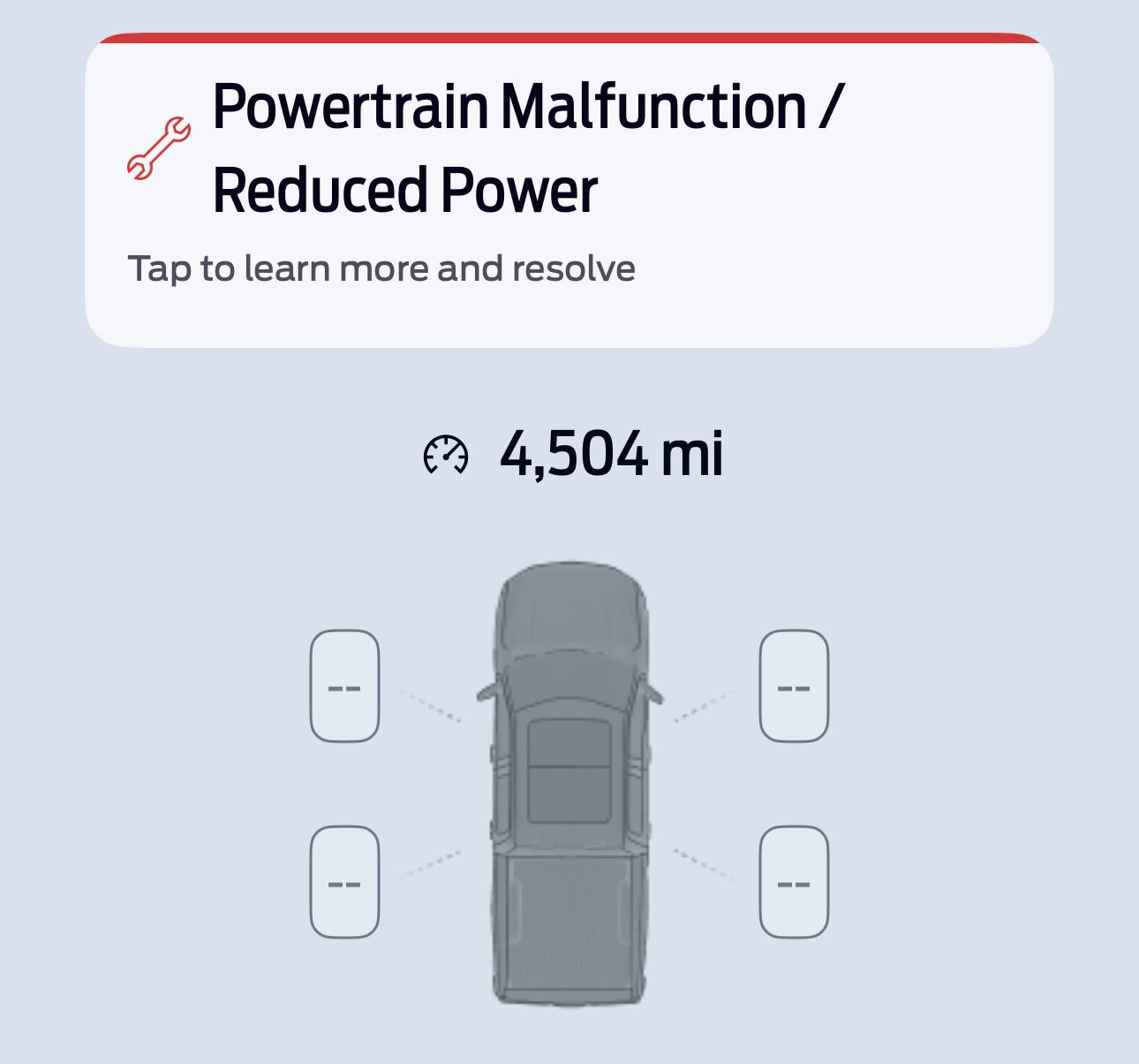

New here. Found this forum due to the error.
Got the service wrench on Friday. Truck wouldn’t charge past 60% but didn’t notice any loss of power for the very short period of time i drove it with the light on. 2024 lariat. 4500 miles.
Service wrench came up and said “service truck soon”. I figured it was a tire rotation as it didn’t sound like there was an real issue with the truck. When charging, it stopped charging around 60% with an error and I looked at the app i saw the error. Feel like something this severe should be better worded than "Service truck soon" on the dash.
Dealership has my truck and they were somewhat vague on what they were replacing. i pressed for info but they just said they were "emergency shipping" parts as the truck is under warranty. They provided me with a loaner.

Ford F-150 Lightning Powertrain Malfunction/ Reduced Power IMG_4332

Sounds like a bad battery module...hard to believe this is still a problem on '24s. At least it seems the dealership is treating you well, minus the vague feedback. Hopefully shipping is fast, that is usually the biggest hold time.

steveoooo
steve
Mar 25, 2025
f150 lightning
It was a bad battery module. Dealer gave me a loaner . Fixed in less than 5 days.
