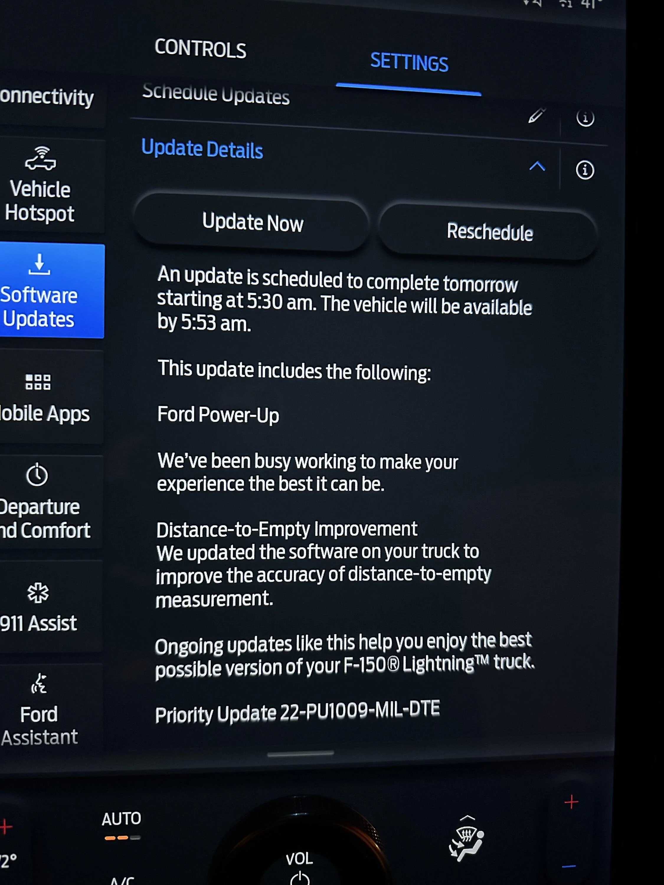

I just got the update today/tonight. I went to pickup my little guy and it showed I had a update pending install. So I installed it now vs waiting till my usual time for all installs.
Ford F-150 Lightning Priority Update: 22-PU-1009-MIL-DTE Calculation C69916E3-42FD-4842-B417-6757875BD1E7
Ford F-150 Lightning Priority Update: 22-PU-1009-MIL-DTE Calculation 0CB626A4-0BF3-4025-B77C-3E47363865CC

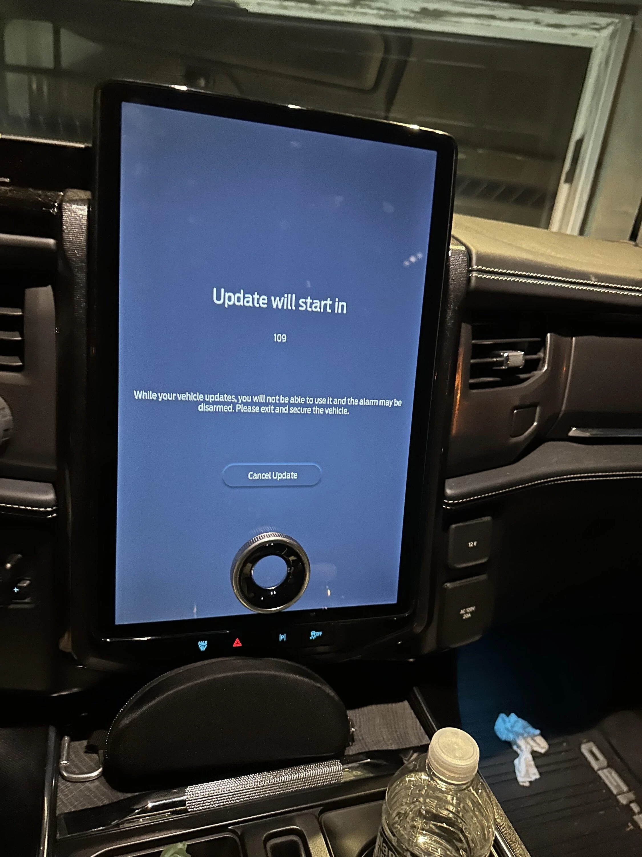

truck asked for update and confirmed times and dates.
- pushed updated from truck at 80% SOC plugged in. FAILED
- this Time went on FordPass to start charging from 80% to 100% ( maybe to boost LVB). This time it took longer but it still failed.
- I went out now at 82% SOC and restarted the update. killed every light , threw every key fob down the way.
It took longer but I just got a failed to update. It’s funny this time of the year I haven’t drove since like 5 days ago. Maybe this update isn’t meant for me.

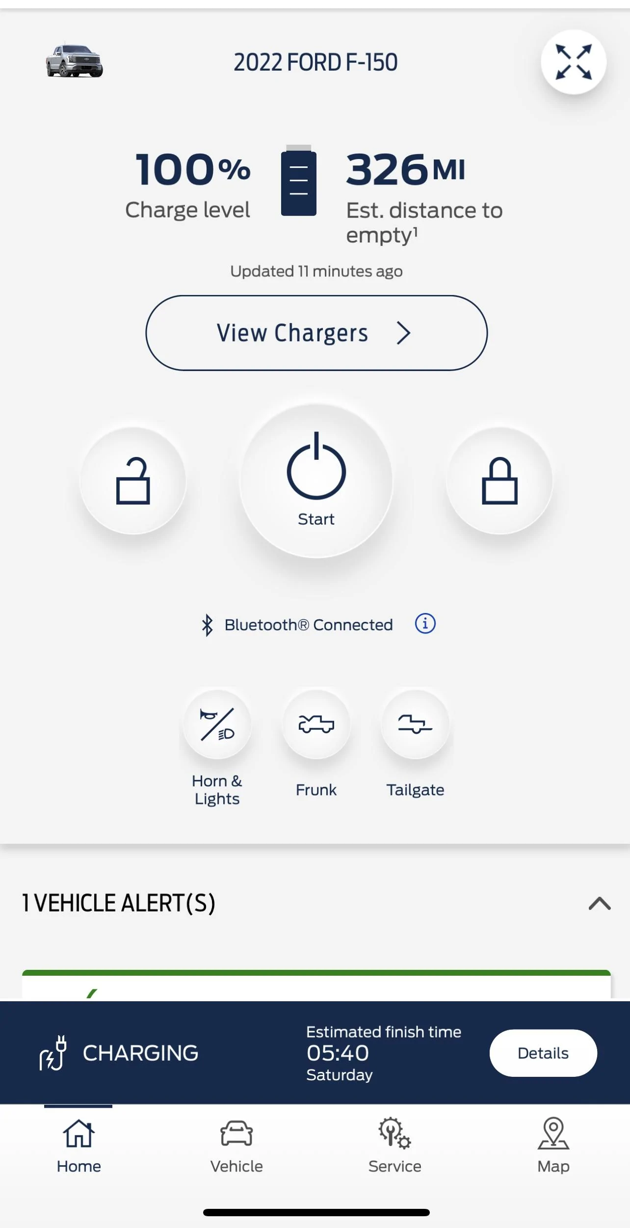

Updated successfully. Charge settings still showing 90% on the app, should I trust it?

Yeah I should have gone I to the truck and changed all my setting again. Although the App had 90% it still went to 100%
