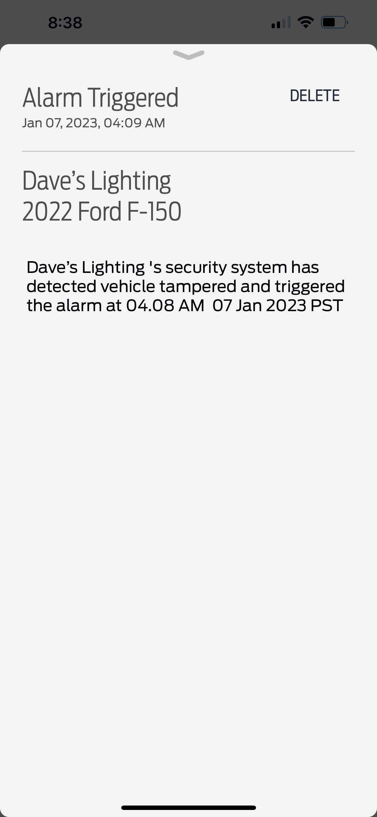

I got mine at at exactly 4:09 this morning! How do I know you ask. Well, the update caused my the alarm to go off and I couldn't get it to stop until I unlocked the truck and physically opened the door.
I've received other updates without this unwelcome feature. All of my neighbors thank you, Ford.
Anybody else seen this?
