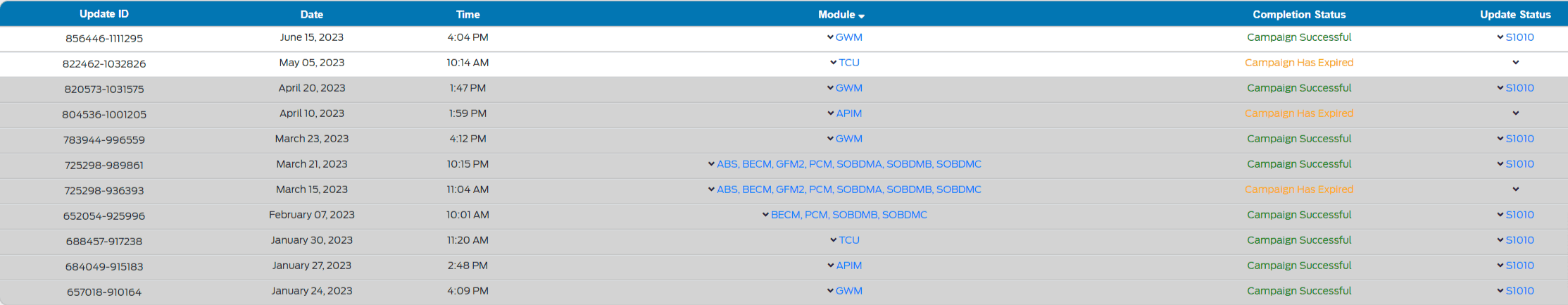

ziptbm
Jan 4, 2023
92
37
'22 MME GT & '22 F150 Lightning Lariat ER
It will not be marked complete in Oasis...it will just say Campaign Has Expired
So module details ARE available in Oasis... The misinformation and/or lack of education consistency across Ford reps and their Franchise Dealer Service Advisors is just infuriating.
I can only assume this is what my vehicle should look like in the system. 2 Days after I installed all FDRS updates (Except for DSP) the errors in app and ability to "update" from my vehicle have gone away. However, my update screen in-vehicle does still show this update information as "Not Completed" but with no ability to force the update from that screen. So hopefully the correct module was updated.
