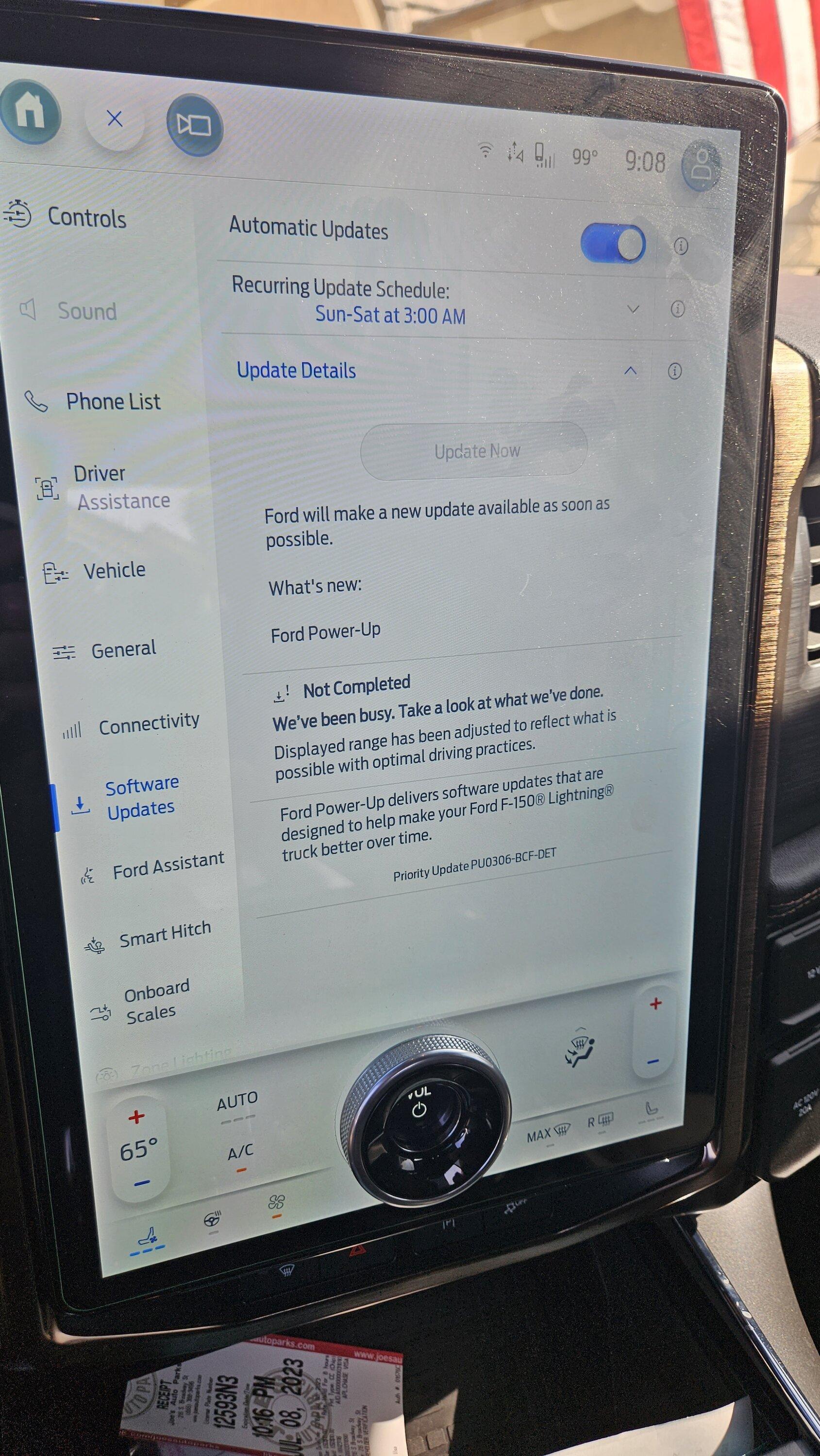

Mine finally stopped trying to update and won't let me try to manually update anymore. Ford must have pulled the update.
I have the same situation - it shows “Not Completed” but no option to retry or manually update. I never got the manual update option. Just an update failed notification and this screen on sync.
Anyone had the update eventually come through after this screen?
