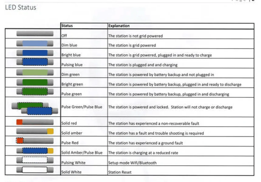

AFTER CONNECTING WITH MY TRUCK ,PRO STATION HAS SOLID AMBER LIGHT
I’ve had my FCSP for about a year now and I’ve never had a problem with it until this weekend. Now I am getting the amber/blue light, indicating charging at a reduced rate when connected. I am on a 100 amp circuit, so it usually charges my truck very fast. Now it only charges at a slow 3 kW rate. On the Fordpass app, it also gives me a “connection lost” message when I go to charge station menu. Prior to this, it was connected to my Wi-Fi just fine.What color is the light? See below for ALL the options (includes dim, bright and pulsing)

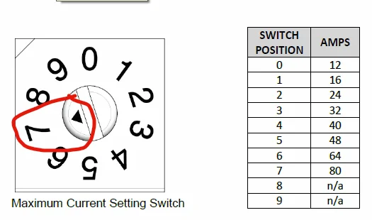

Man, I don't know. Mine was reliable for a year until I sold it. If nothing else works, you might try a factory reset. Instructions in manual. You have to remove some screws and take the cover off to get to the button (turn off breaker!). While the cover is off re-tighten all the lugs. Thermal expansion can make them loose. The selection for max current is also a small rotary switch. Just for grins, rotate that a couple of times and back to 7. You'll need to reset up WiFi. Wait 10 minutes afer repowering for it to fully boot before trying the setup program.I’ve had my FCSP for about a year now and I’ve never had a problem with it until this weekend. Now I am getting the amber/blue light, indicating charging at a reduced rate when connected. ...

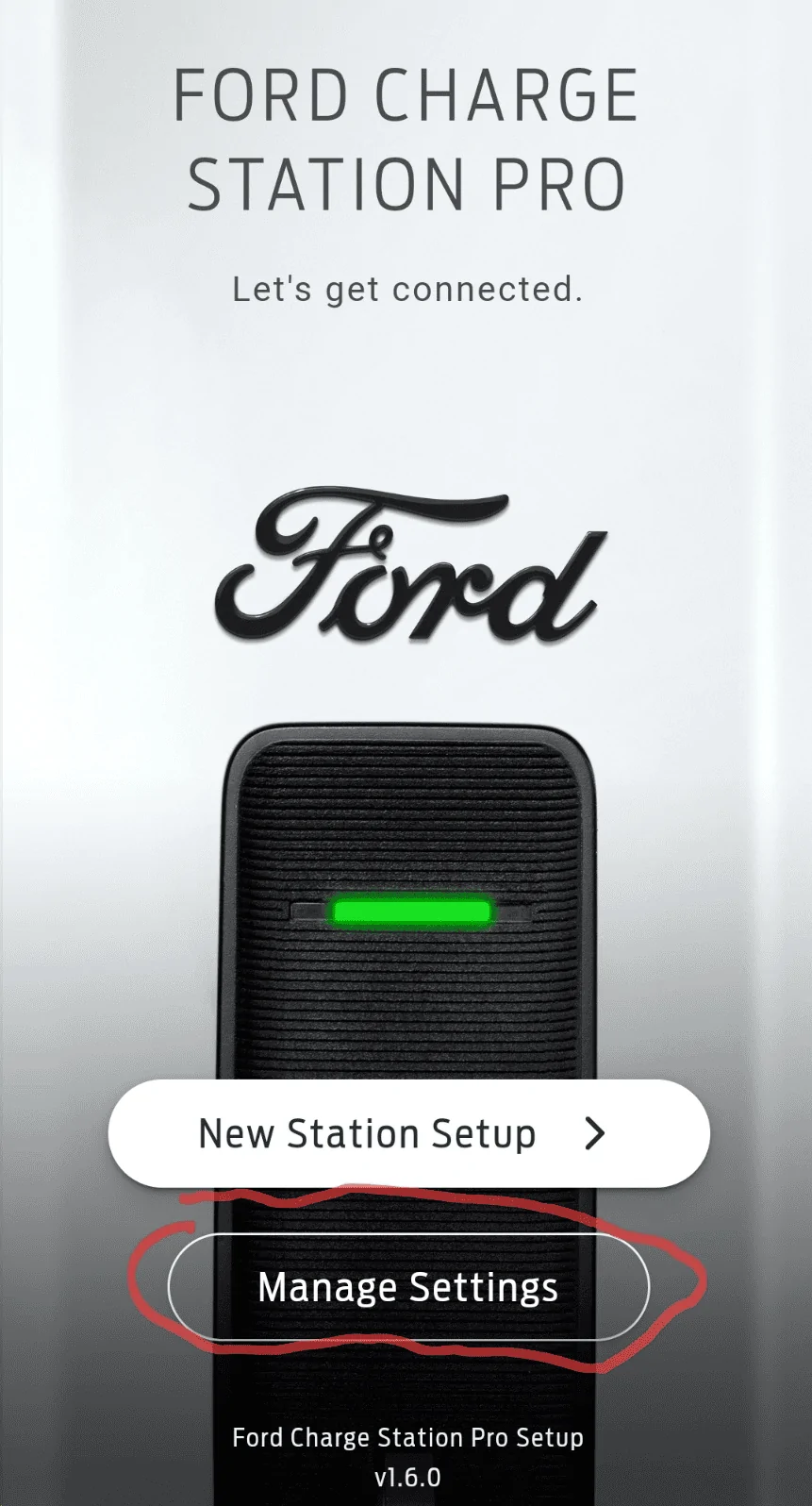

I tried the setup utility, and it says “no stations found.” It’s definitely not a problem with my home Wi-Fi, I have a strong signal, and a mesh router right next to the garage.Can you log onto the FCSP via the setup utility?

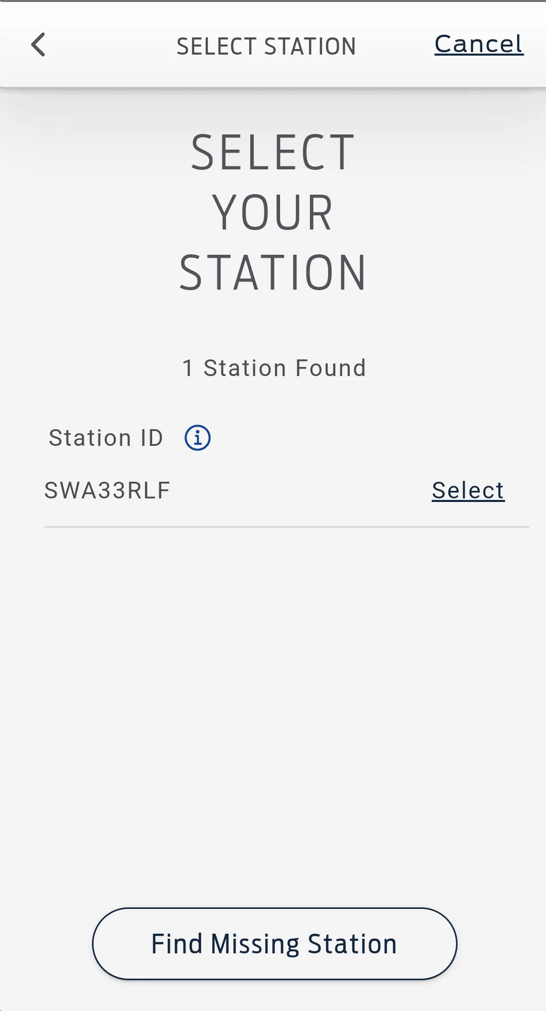

Remember to turn on your phone wifi and make sure to first log onto your wifi network, then using the setup utility try the "Manage Settings" link in the app, you should be able to see your FCSP system name, select it and log onto it with the device password.
If you're not able to see it, then I would suggest confirming the wifi range in your home is not the problem, if you have a strong signal to where the FCSP is, try running a new setup process, you could start from scratch by resetting the device by pressing the reset button under the cover.
Once you have reconfigured and associated the FCSP with your Fordpass account / Truck, try using the Connected Charge Station tile under [Account] in the Fordpass app, you may need to wait a few hours for the associations & communications between the FCSP cloud and the Ford cloud to link up. When it's active, double check your charge rate settings, make sure it's set to 80 amps.
