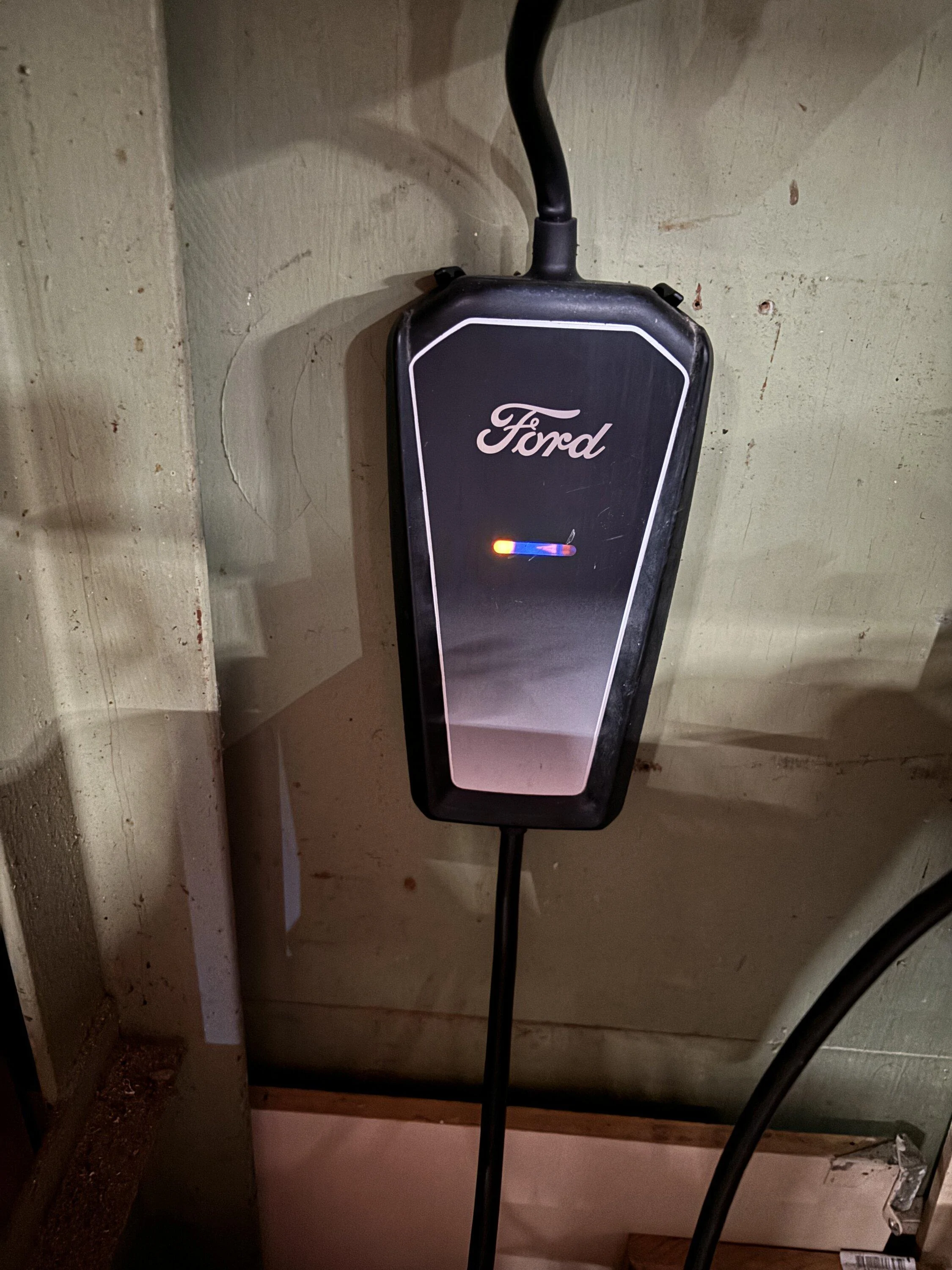

My portable charger stays plugged in to a 240V outlet on a 60a 50a dedicated circuit. It is my only home charging device for the past year. Lately, more and more, I am noticing that I don't consistently get the 6 kW charge speed that I should get. Instead I get 3 kW. The display shows part orange instead of the solid blue light. It will sometimes flip back and forth between 6 and 3 kW.
Anyone have any input or suggestions?

You are experiencing what many have experienced, the Ford Mobile Charger failing after constant usage. If the neck is seated properly, then get the charger replaced by your dealership and get a high quality charger like Emporia, JuiceBox or Chargepoint.

I have been having issues with mine as well. Charges fine on 110v, but 220v is inconsistent. Was doing fine for a month, then I returned home from vacation to find it blinking an error code.

Ya, it's overheating and derating. It could be a bad connection at the wall or dongle but it could be internally overheating and causing the derating. Try warranty first but there are many other options now like amproad, electron, etc.

Wall connection is brand new and installed by licensed electrician. Charger showed an error the first time we plugged it into 220v, and the next day it worked fine. Was good for a whole month, then I left for a week and now it is acting up again. Will certainly try to get it replaced by the dealer.

I've used my Ford Mobile Charger EVSE from day one, FULL TIME, at my home, and after 39,000 miles over 16 months, it has had no problems giving me the power I need, anytime. I dare say that those who simply assume that it somehow 'can't' do the job is just unjustified. I believe that more of the 'issues' are due to other problems..whether the outlet, the power, the truck, or even the 'seating' of the plug adapter into the base of the unit, etc.
I have, though, seen this 'yellow' color highlighted one time, and I simply unplugged the unit from the outlet, reset the 'collar' of the 240v adapter into the base of the unit, replugged, and have had no issues since.

I have used the Mobile only for 15k as well. The Ford dealer tried to tell me that the Mobile isn't designed to be used daily when I brought it in when it started acting up (same issues the OP is reporting.) I called BS and told them to replace the charger under warranty. The replacement hasn't had a single issue, and I continue to use it as my daily. Don't let the dealer BS you.

You've been lucky. The Mach-E forum is full of people having problems with their mobile charger. I hope you keep having good luck with it, especially now that it's out of warranty.

Ours went south after 43,000 miles, near daily use w/SR MME over 19 months. Replaced with a ChargePoint HomeFlex. As the defective charger came with the MME at purchase, summer of ‘21. Ford replaced it. The S.O. now uses it at 120V charging maybe once a week. The CP Home Flex now dedicated to the 7 month old LT.
