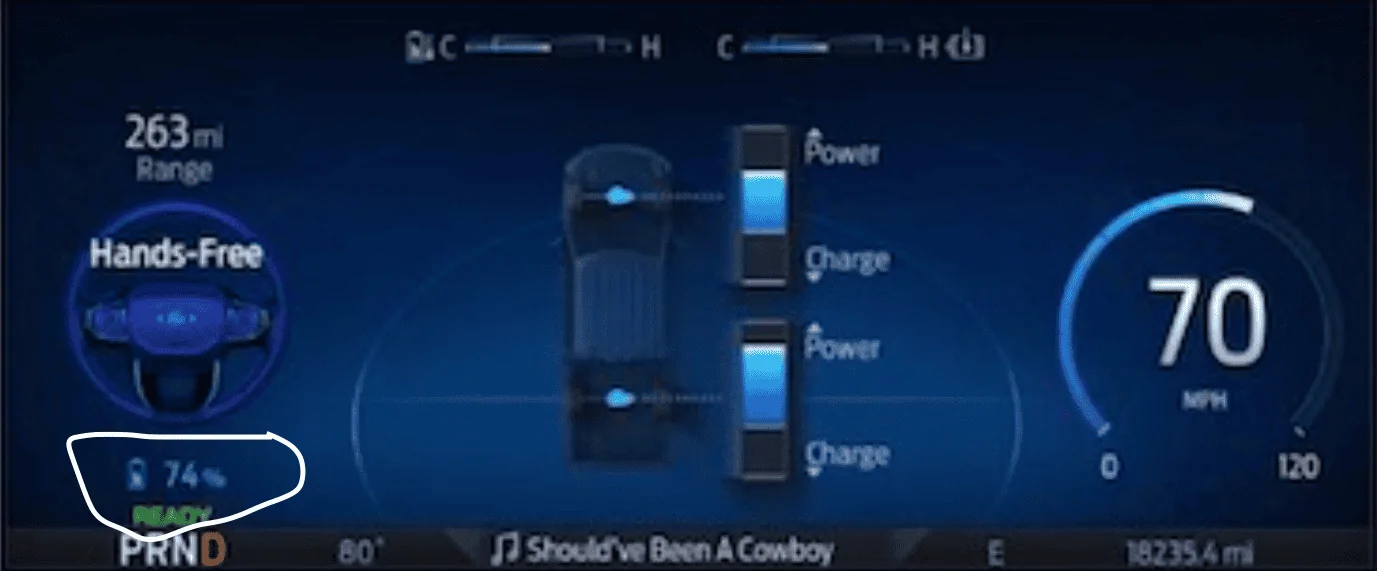

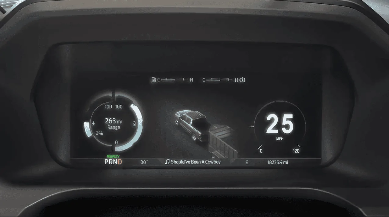

I’ve read somewhere during cool weather 95% charge is fine so I’ve set mine there. Ford charge station home charging. But my guess oh meter never says range is better then 285-291 at best. Live in the maintains plus heavy foot. I did have to wipe history clean after a good bit towing. I also find if I hit Tow/Haul rather then setting truck to pull my trailer I get more realistic range guesstimate.

Thread is nearly 3 years old.
Charge to 90% regardless of weather, unless you need the range.
Towing you should be setting up a trailer AND using Tow/Haul.
My range never gets higher than yours.
