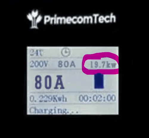

You seem very invested in defending this manufacturer regardless of the false claims made on the Amazon web page :rolleyes:
Even if you had an extended range, you would not reach the 22kW it says it can do.
Yes, the screen shows 80 A, but that is not what you are pulling from the EVSE. It clearly states you are getting ~ 46 A, which is slightly less than expected on a standard range pack.
Are you looking for validation or approval for your choice in an EVSE?

Looks like you're maxing her out. You must have a standard range battery?
It looks like the second line of your charger display has solved this mystery, as it shows that you have 246 volts coming into the unit and are pulling 46.7 amps for a total power of 11.6 kw going to your truck.

The EVSE is working as expected on your SR LIGHTNING, enough said.
Late to this party so excuse the pile-on. Let's keep it going. In post #1 OP claimed the display was showing 22 kwh [sic] and now showing 11 kwh [sic] after the motor was replaced. So still a mystery.
I think he happened to look at line 4 on the display after 1.9 hours of charging and noticed it said 22 kWh [no sic] :).
