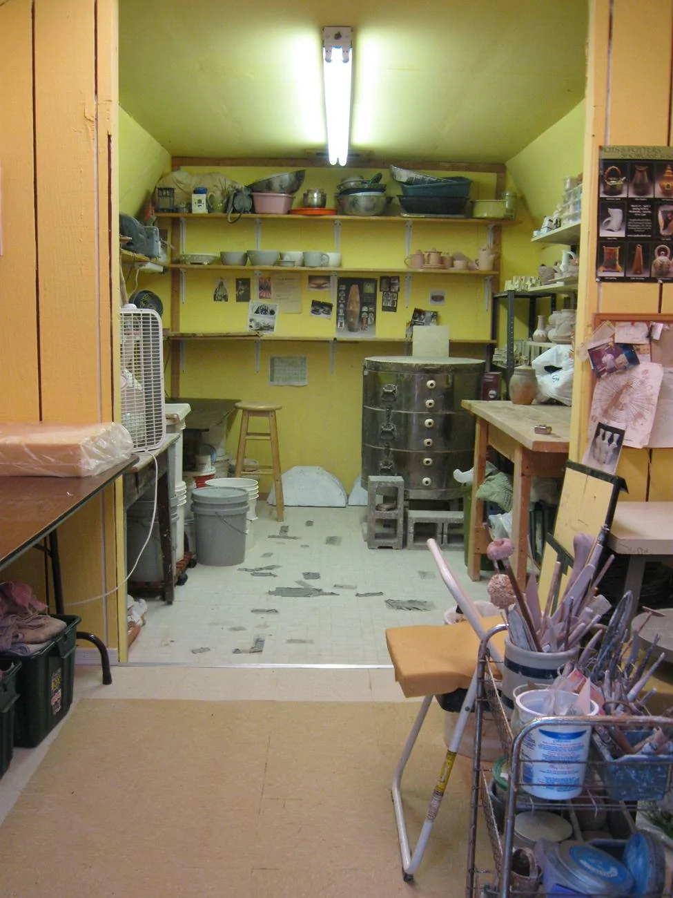

At home your voltage is probably a nominal 240V single phase (through a split phase service panel), but many/most industrial installations have a 208V three-phase service.
My wife makes pottery.
She has a kiln she used to use at a warehouse converted to a pottery studio and there the voltage was 208V.
When I built her an out building (she-shed) we wired it up to the house via a split phase sub-panel. At home our voltage is 240V, so we had to rewire the kiln to 240V to make the best use of it.
The Skutt kiln was made so one could easily switch between the two voltages with a kit that changed the wiring internally using a different terminal block and cord.
We retired that kiln after about 15 years use and got an L&L kiln with digital controls. Because it opens differently from the top we had to move the kiln to the nearer the middle of that back room section.

Ha! Thanks for posting that photo. We had two kilns for years, and still have the largest hidden away in the garage ... your photo makes me wanting to get back to it. But I would have to push the Lightning out of the garage :question:
Well building the shed was our solution to the space issue, we considered converting the small attached one-car garage, but then we read about someone who had a kiln fire and said nope.
There are lots of plans for sheds on line for free. The shed structure cost about $1000 and was put up by one guy in one day! It amazed me so much I said "I could do that!" So I built a second shed for my tools etc. a year later (2001).
The electrical contractor we hired (I was still working in patents full time then) dug a trench from the house to the shed and installed a panel and wiring, one overhead light, outlets, roughed in before we put on drywall. But get this - he mixed up one of the hots and the neutral! I plugged in a drill to screw in drywall and POW! The drill burned up. Seems it preferred 120V to 240V. I check the outlet voltage and sure enough, 240V.
