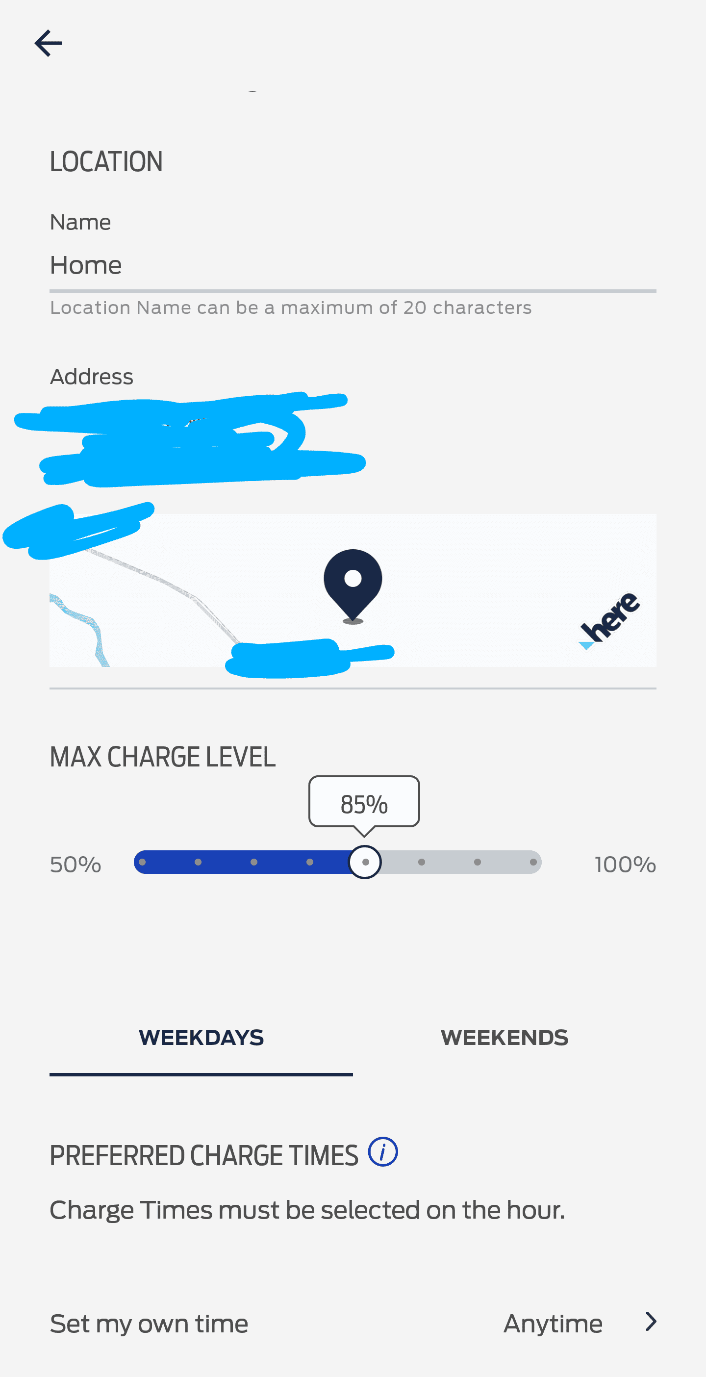

I don't drive every day so I don't charge daily. And my charging location in the apartmeent garage is not handy, so that's anoter reason I don't charge every day. When I do charge, I charge to 100% (even though in the FordPass app, I have the preference set to 90%. I cannot figure out why it's charging to 100 when I ask it to only charge to 90.

You didn't actually ask a question to be clear. But if I can infer what you intend, "going on the record" won't do much. Your battery has a certain initial useable capacity. The BMS will track how much actual capacity you have in kWh. As long as you have above 70% through the end of your battery warranty, Ford isn't required to do anything.
I can answer your charging issue though. By default, the Lightning will charge to 100% on L2 and 90% on DC. There are two ways to change this:
1) Before each charge session, you can set the one time charge limit to your desired charge level. This only applies to your next charging session (and it might reset if you drive, not sure on that...). You can also do this through the FordPass app, though generally I think you only get the option to "Charge to 100%" and only after you have plugged in.
2) For L2 charging, you can set up a "Preferred Charging Location". You do this in the infotainment or in the FordPass app. One of the preferences for the charge location is the charge limit at that location. Looks like this in the app.
Ford F-150 Lightning Range took a huge drop Screenshot_20221018-195002
