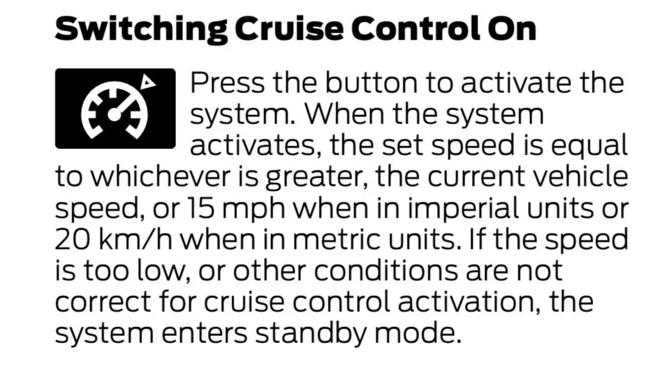

Keep in mind that unless you already have cruise turned on but disengaged and it‘s set to a higher speed, accidentally hitting the “Activate” (left) button will only engage at current speed - not accelerate.
If it was already on, accidentally hitting the left button simply turns it off. In this state, you would have to accidentally hit “Resume” to cause unexpected acceleration.

I just had my cruise control activate while stopped. When it occurred, I had NOT touched the steering wheel.
I entered the vehicle, pressed start, shifted to reverse, backed up 10 feet, shifted to drive, and cruise came on at 15mph. This was done with no contact with the steering wheel at any time.
I have had it happen 4 prior times but those may have been me brushing the cruise button. This time, I had not touched the steering wheel.

If they changed it so it will only activate when the steering wheel is (almost) straight ahead that could solve the problem of palming the button during turns, while still leaving the super convenient one touch activation.

You're just going backwards and forwards without turning at all? Seems odd, but I'm sure you had a reason. I wonder if you can try to replicate this over and over, I can't believe it's entirely random, but maybe some sort of bug in response to pedal inputs? a weird timing bug related to shifting? Are you using 1PD? The only way we're going to get Ford to fix this is with reliable steps to reproduce the error.

I was using one pedal mode. As far as the movement pattern, that is why I know I did not touch the steering wheel when the cruise engaged. I merely backed up to allow a larger vehicle to move safely and then moved back to where I was parked. I have had other instances where the cruise has engaged unintentionally, but I couldn't say they occurred without input. This time, I was able to verify the cruise engaged without input.
