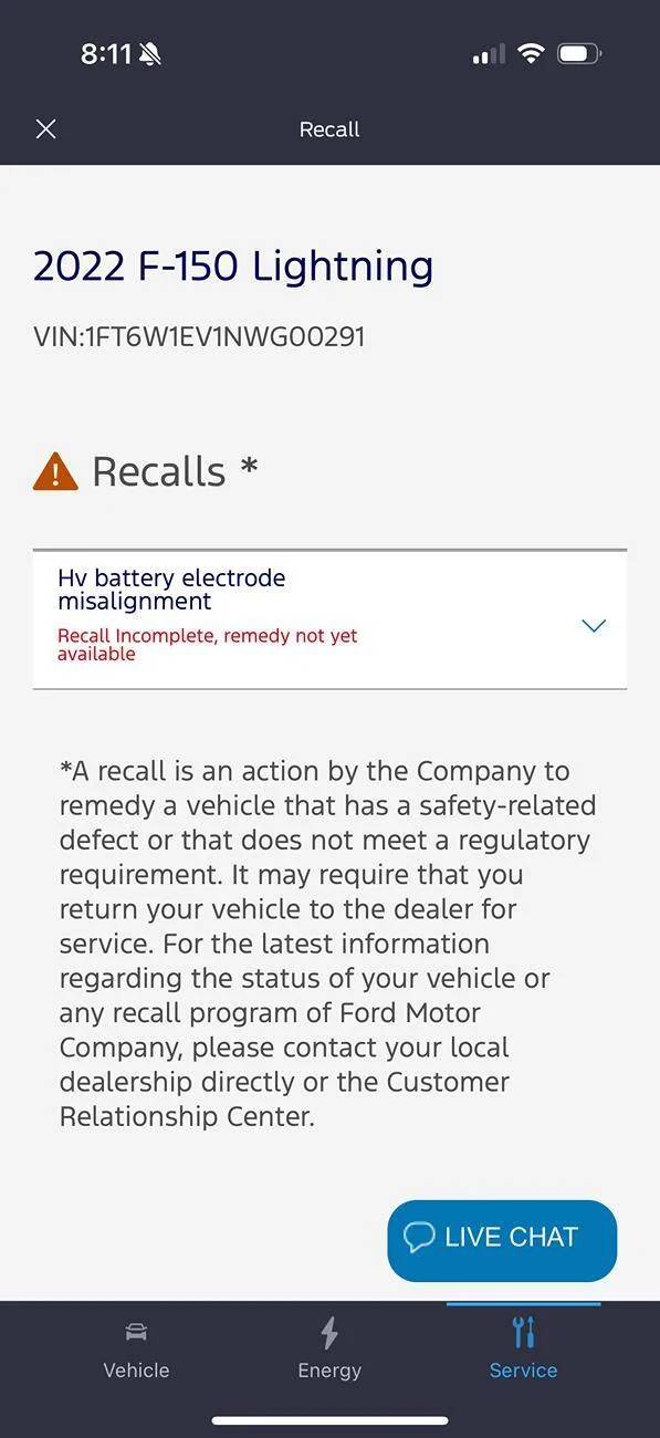

Our early build '22 Mannequin is on the recall list. We are on vacation for another couple weeks and it's sitting in our garage unplugged at 51%. I'll look to see if I have a photo of the blend date otherwise I'll update here in a couple of weeks. We had a module replaced in September of '23 and truck has been fine since. Lots of DCFC sometimes up to 95%. L2 charging to 100% the night before road trips.
Ford F-150 Lightning Safety Program: 25S18 aka 25V131: HV Battery Electrode Misalignment Discussion IMG_0471
Ford F-150 Lightning Safety Program: 25S18 aka 25V131: HV Battery Electrode Misalignment Discussion IMG_0472
