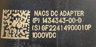

Read the 2nd line from the bottom on the adapter's label. This pic fragment stolen from Tom M's post on the previous thread page:
Ford F-150 Lightning Tesla NACS Adapter Recall / Replacement Notice (10/24/24) 1730171140007-a2
Starting at the 24, the 5 digits read "24149." 24 is the year of manufacture and it's a Julian date, so 149 is the number of days in the year from 1/1/24. But 2024 is a leap year. So, ask your favorite AI chatbot what date is 149 days from the start of a leap year. In Tom M's case, it's May 29th, according to MS Copilot.
So, after you find the date of manufacture of your adapter, see @bmwhitetx's post to see if the date falls in the apparent batch window determined so far (other posts suggest the part number label might be important, but the evidence there seems inconclusive): https://www.f150lightningforum.com/...replacement-notice-10-24-24.21940/post-430570. You should have gotten an e-mail from Ford, too, if your adapter is in the bad batch.

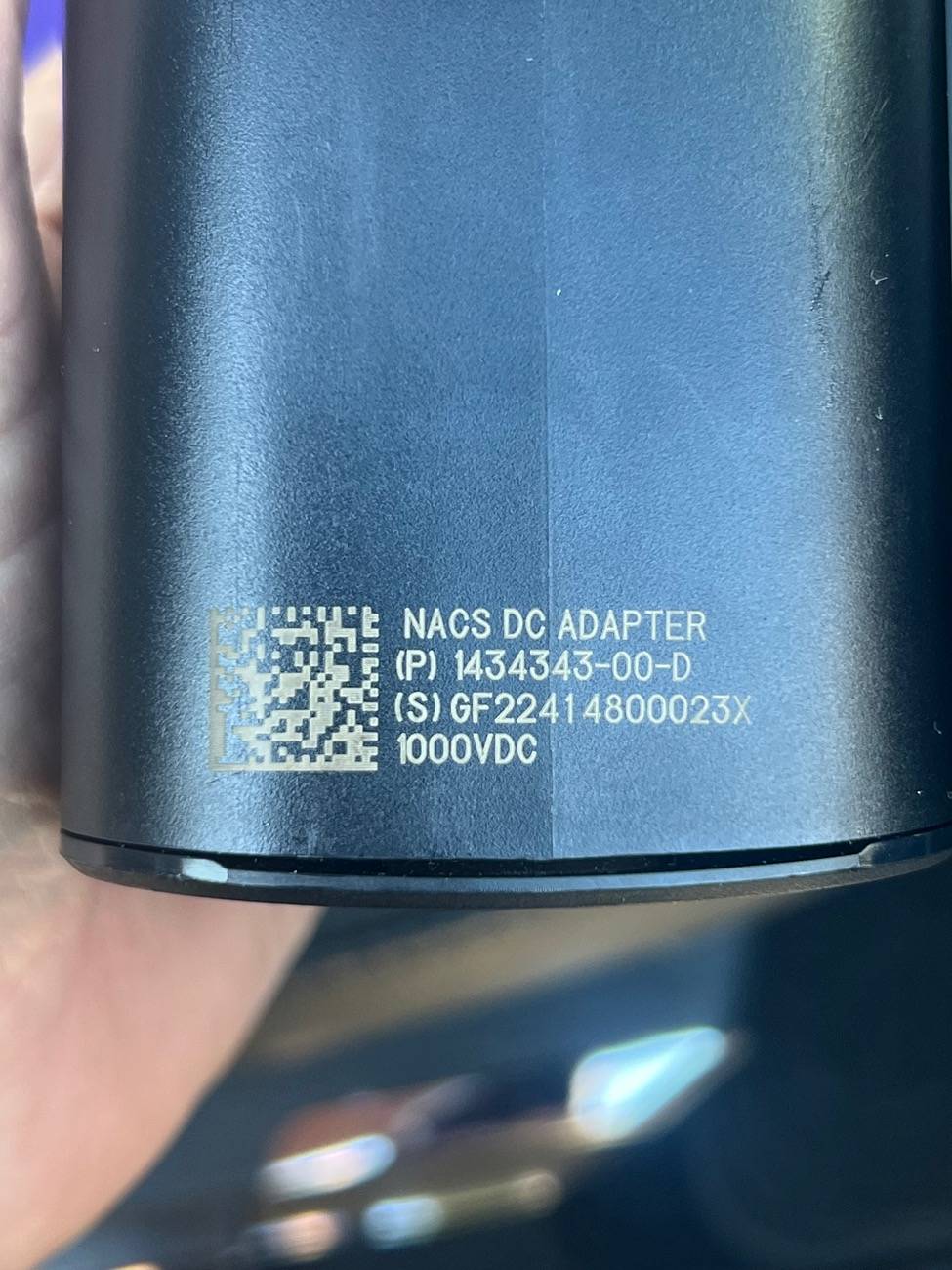

Not a lot of new reports of recall emails that can be tied to a specific adapter (and thus date code). Here's is what y'all have reported so far:
See this post on where to find date code.
Finally looked at mine add me to 5/27/24 😂

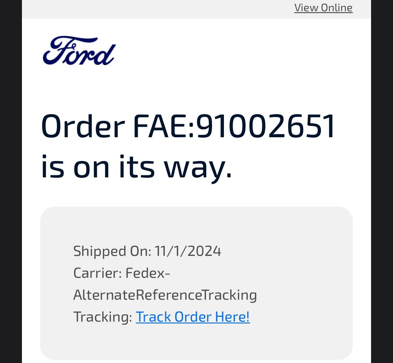

assume no one has been notified of these actually shipping or this thread would have been lit up. Obviously week of 10/28 is nearly done.
