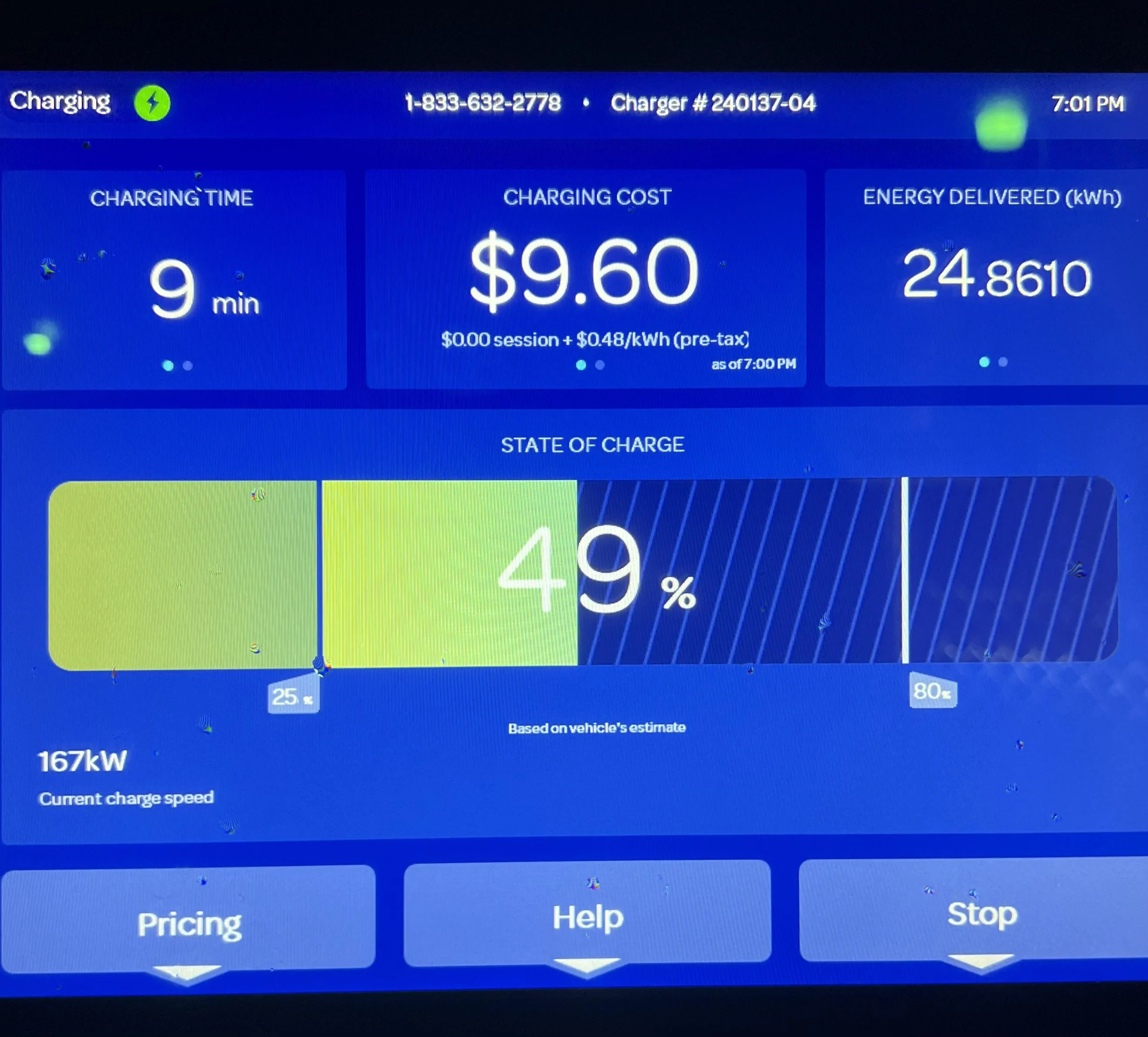

I’ve seen upwards of 160-170kW on my SR at EA “Hyperfast” 350kW chargers. Two things are true:
1) the early spec floating around out there that said the SR could only charge up to 120kW is just wrong. Here’s a recent example where I averaged 165.7kW while adding almost 25kWh in 9min:
2) I think the key to high charge speeds is current (amps), not kW rating. Due to the relatively low pack voltage of our Lightnings (low to mid-300V), we need a 500A charger output to be able to reach charge speed nirvana. The math is kW = V x A, so 165kW requires 500A to git ‘er done: 165,000W = 330V x 500A. EA “Hyperfast” 350kW, and Tesla Gen3 Superchargers, are capable of delivering the 500A we need- but the “150kW” chargers are not.

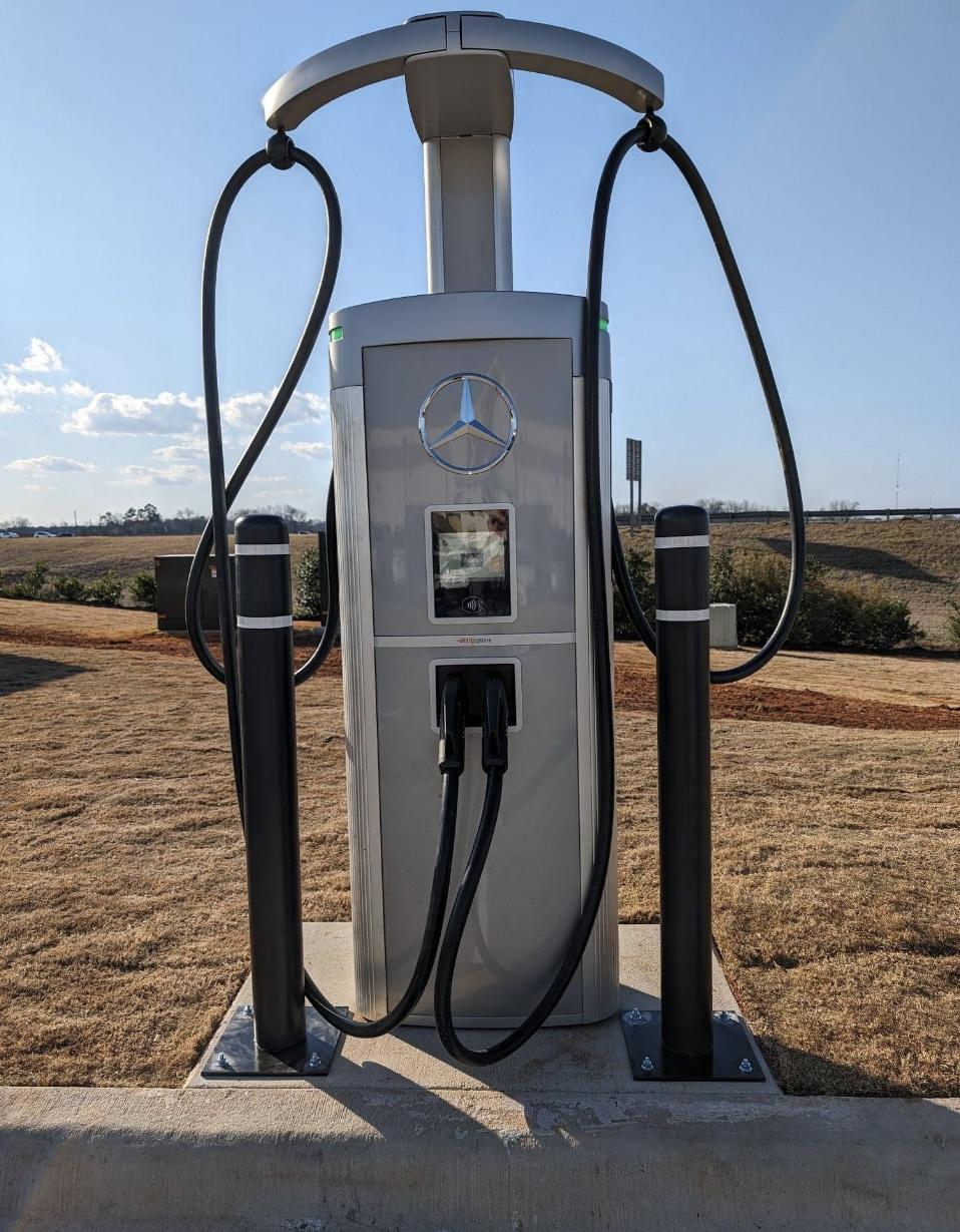

With this in mind, I noticed today that a Buc-ees' on I75 South of WarnerRobins GEORGIA, and a VERY busy and visited location, has now installed THREE Mercedes branded CHARGEPOINT 'dual' 400kw units, right near the almost-new row of SIXTEEN SUPERCHARGERs. I'm now wondering if they are realizing that these new CCS chargers might not be as big of a 'deal' now that most manufacturers are moving toward NACS, and the soon-to-be-open Tesla Supercharger option. Oh well. It's good to have both, no matter. Mercedes can afford it.
Any idea if this open to us?

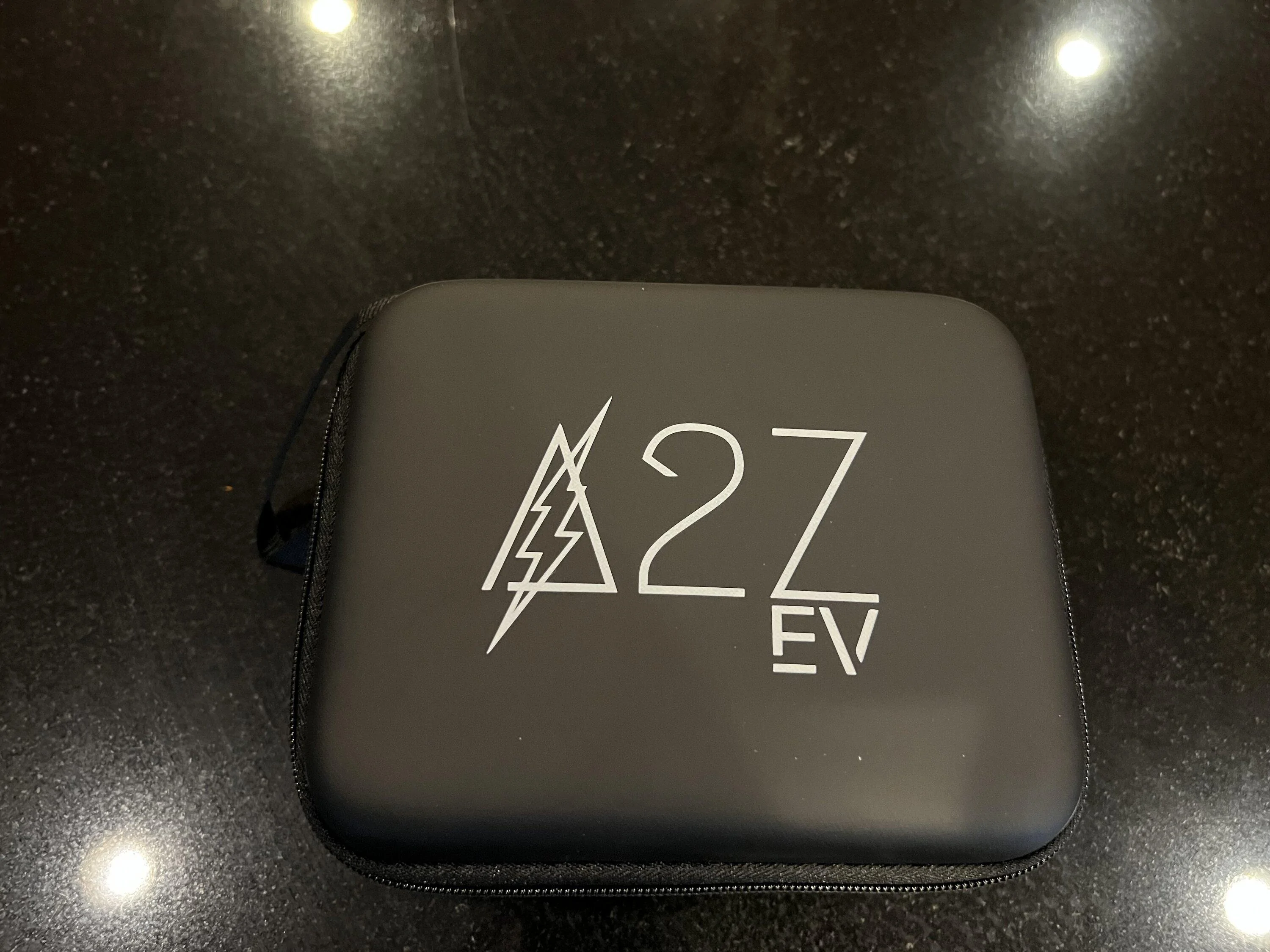

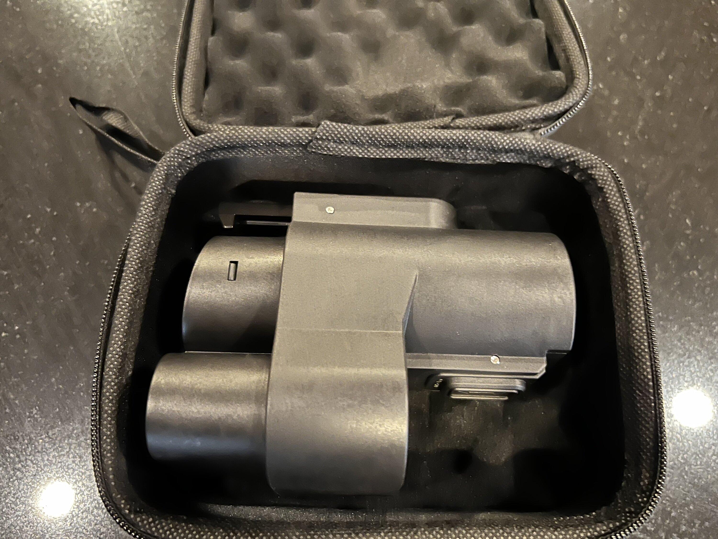

I received the production version of the A2Z Typhoon adapter. Now I’m waiting on Tesla and the Blue Oval charge network to activate.
