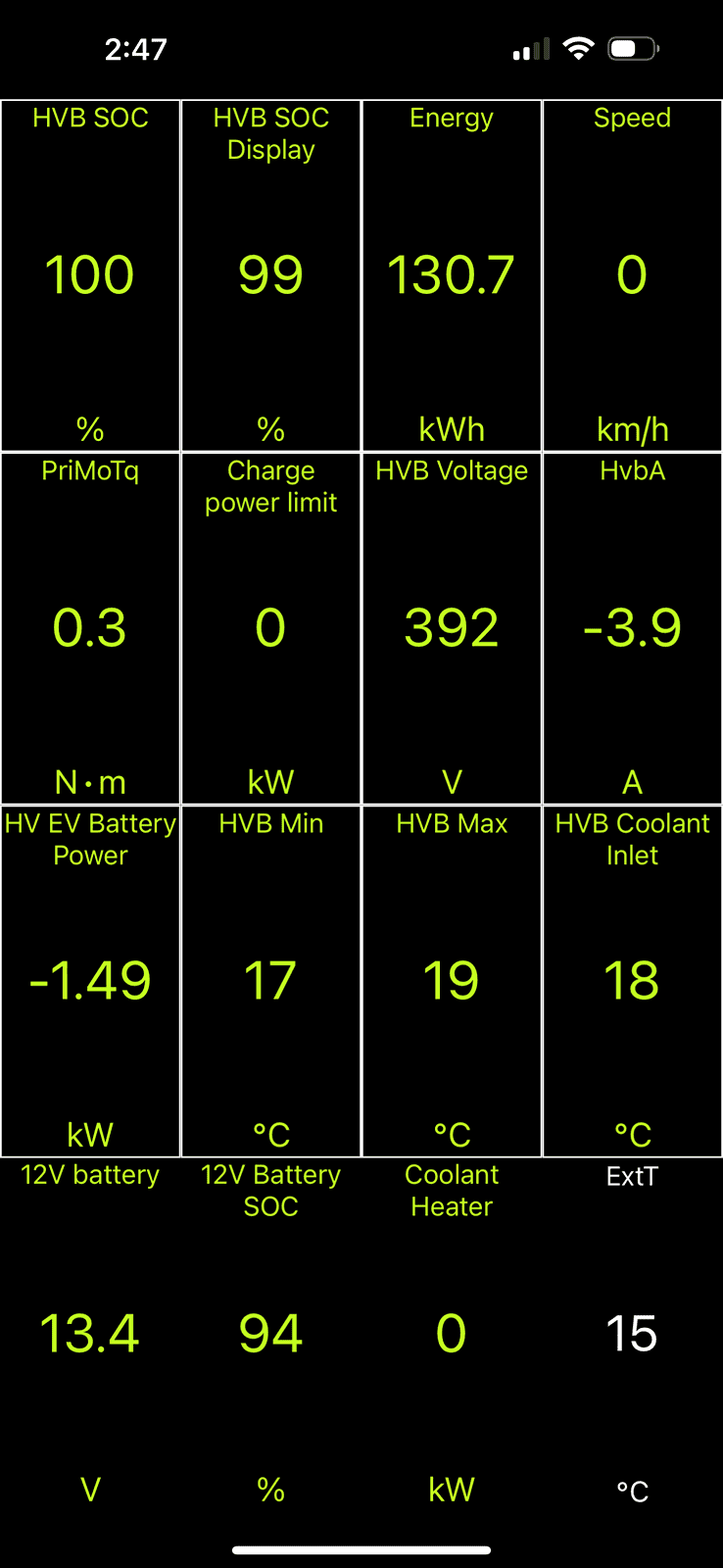

The battery pack is 144.3kWh. It's 131kWh usable. the SOC on my ODB reader is not based on the physical limits. If it 127kWh (100% display SOC) would read 89% on the ODB reader, but it reads 97%.
Here's another example, when my truck glitched and wouldn't get to 100% display which allow me to charge to the full 130.7kWh. Note the HVB SOC reading and at this point, the battery wouldn't take any additional charge, it just hovered at 130.7kWh for the next 10-15 minutes.
Getting stuck at 99% display for several hours is not uncommon, as the BMS tries to balance all the cells. Nothing unusual there, however the SOC actual reading also showing 100 is baffling. I haven't seen anyone else get a reading like that. I have to ask the obvious, have you double checked that your pulling the right data? If the actual SOC is hitting 100%, I would take that to the dealership.

Getting stuck at 99% display for several hours is not uncommon, as the BMS tries to balance all the cells. Nothing unusual there, however, the SOC actual reading also showing 100 is baffling. I haven't seen anyone else get a reading like that. I have to ask the obvious, have you double checked that your pulling the right data? If the actual SOC is hitting 100%, I would take that to the dealership.
It only happened once. Ever since the highest I've seen is 97% SOC and 127kWh.
Took it to the dealer to run diagnostics and everything checked out.
Ford needs to fix its BMS information on both ends of the spectrum.

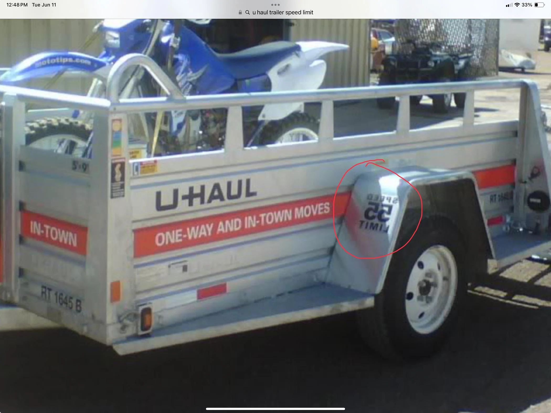

How do you tow anything with a U-Haul trailer, then?
