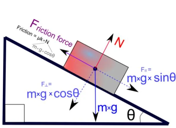

Physics would say that’s not a factor.
Really... more weight + same contact area (resistance) = more likely to move
Simple physics experiment: take an empty container, put it on a steep slope, slowly add weight and see what happens.
My money is on the additional ton of weight.
4,231
5,635
The key is “steep”. At a 45 degree slope, the required force to overcome the friction increases at the same rate as the gravitational force as you add mass. At anything less than 45, the frictional component increases more than the gravitational force. I can’t believe his driveway slope is over 45 degrees.
