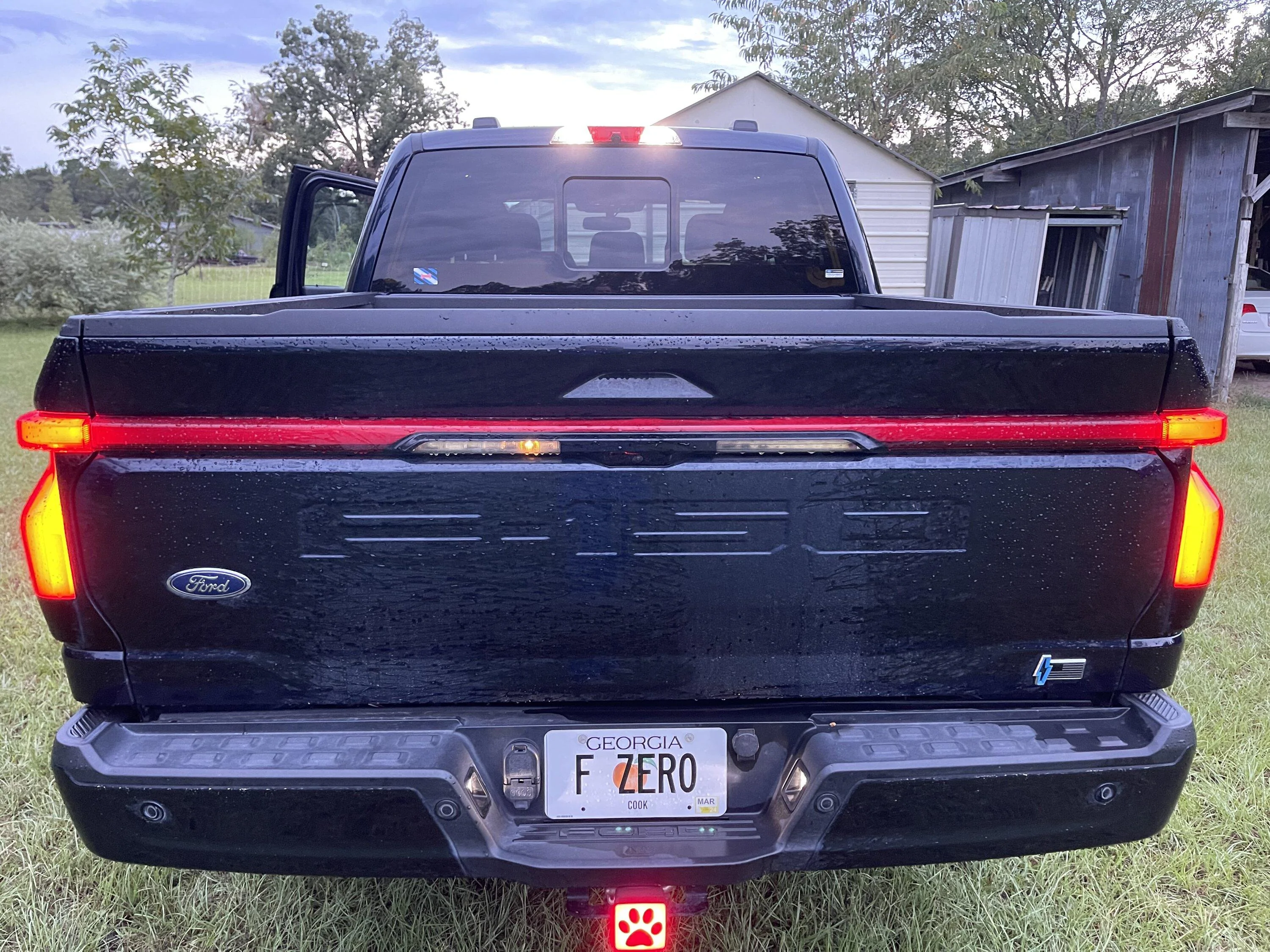

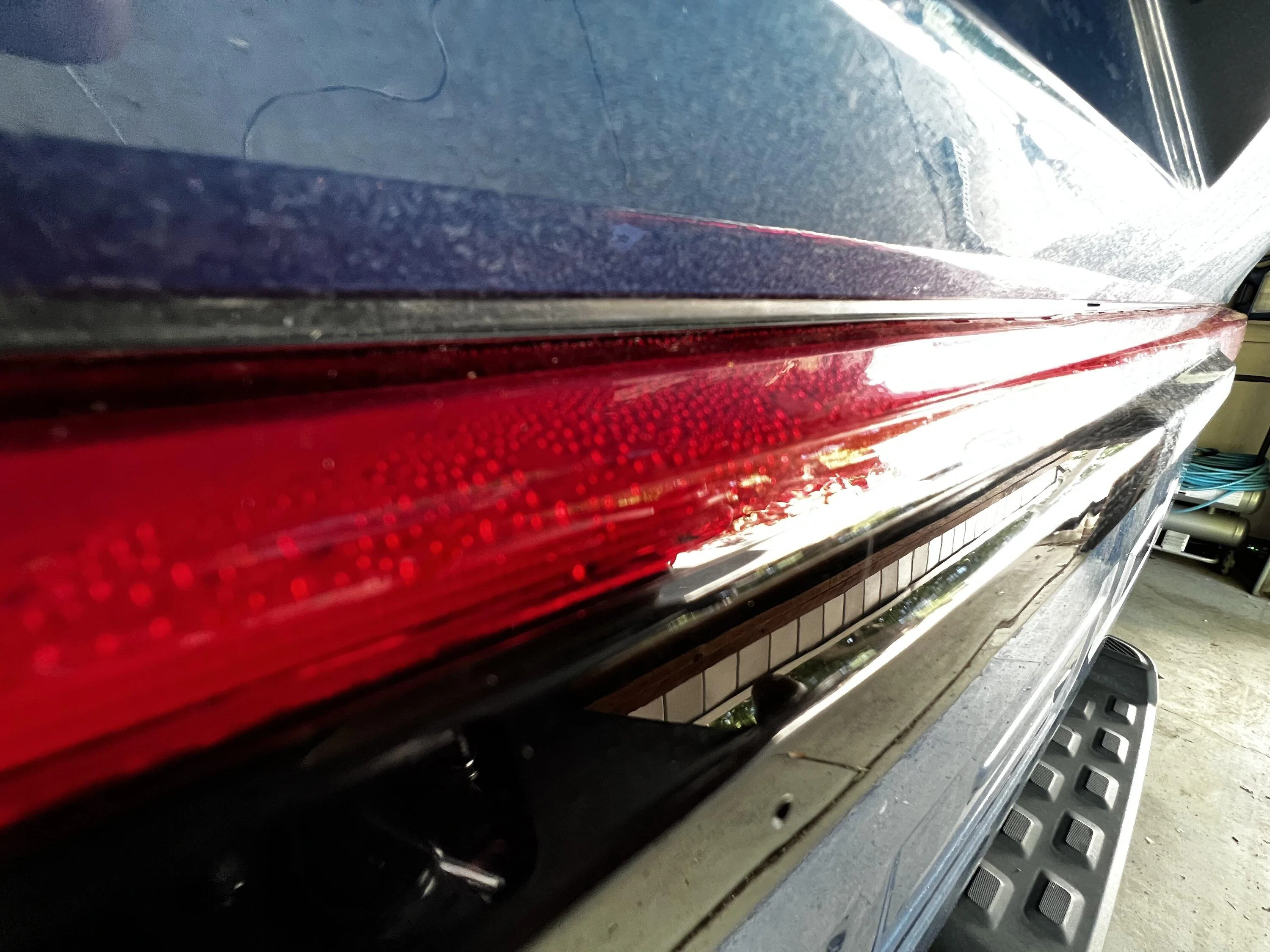

Can confirm the white lights below the red light bar are burning out from moisture intrusion. I noticed it a few days before the recall letter came in. I had my phone in my pocket while walking towards the rear of the truck. Proximity triggers the lights to come on, and the light bar was flickering. Honestly it looked kinda like lightning in a bottle (or bar, lol).
There are definitely burned out LEDs in the white reverse bar. I can’t recall about the break bar, but do believe there is a section burned out there as well.
I’m going to check exactly what all is burned out tonight and talk with my dealer when I take it in to get the tires rotated (30k so far!). I took delivery of my truck July 2022.
Updated to include pics: rear lightbar completely burned out and reverse bar nearly dead too. At least it hasn’t affected the break lights.
