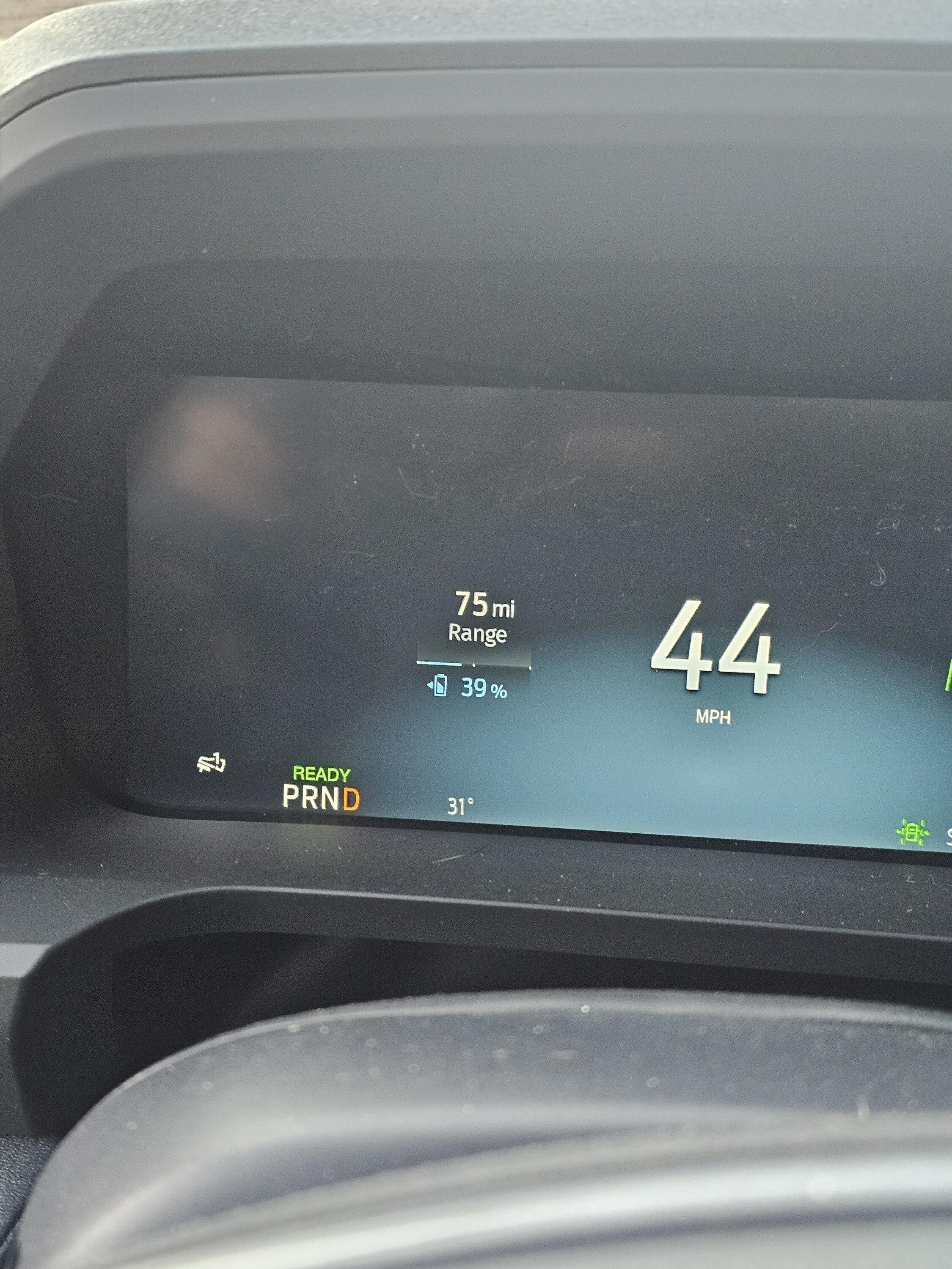

I purchased a Lariat ER two weeks ago. I love the truck, but I'm getting 1.3-1.5 m/kwh. I have a usable range of 150 miles. I know I'm not going to get the advertised 300+, but I expected somewhere between 200-250. This is at 70mph, bluecruise, heat at 67 and everything else turned off. I set tire pressure to the recommended 42psi cold and I have a cover on the bed. I went back to the dealership today. They wouldn't bring it in to check for updates, and the salesman offered me $60k to trade it in. To me both responses are completely unacceptable. What am I doing wrong?

Are you sure you're driving 70mph? :)
Just some quick math. My Trip 1 is at 1900 miles and 2.0mpk since October. 73% driving energy. So I've expended 950kWh driving 1900 miles. only 73% is driving, so it's 694kWh for 1900 miles, or 2.74mpk for driving only.
If you've driven 1600 miles at 1.5mpk (78% driving energy) that comes out to 1.92mpk for driving only. 2.74 to 1.92 is a pretty big gap. Also, I drive FAST. I'm regularly driving over 80 on the highway and most of my driving is commute which is 80% highway (though can be slow at times due to traffic).
I'd be very surprised if you were having efficiency that low for just 70mph highway driving. Tom Moloughney did a flat out winter range test in his Lariat ER and went 210+ miles at 17F and he has A/T tires on his truck so he loses some efficiency for the tires, too. His trip also included 1100 ft of elevation gain. That trip was 1.7mpk.
That's pretty much in line with my experience in the winter in New England. I do a 160 mile round trip up to the ski mountain most weekends in the winter and it never takes more than 70% of the battery, that would calculate out to about 230mi of range in very cold weather.
If you can confirm that you're actually only getting 1.5mpk (and it's not just a software glitch) then it's worth having the truck looked at.
IMPORTANT NOTE: When it's cold out and you start out at 100% (or close) the truck gives you an unrealistic range estimate (250 or 280 or whatever). It makes up for it by aggressively dropping range in the first half of the battery. You'll probably drop from 280 to 100 miles in the first 50% of the battery but in the second half the range estimate will be much more accurate and you'll probably get OVER 100 miles of driving from the time it says you have 100 miles left. It's just bad software design by Ford. They made that change last year because people were complaining that their truck was giving them a 220 mile range estimate when it was very cold out (even though that was pretty accurate).
The estimate being wrong is less of a problem than the fact that I'm actually getting the 150 mile range. It's a problem yes, but I'd rather get a little more and have the estimate be wrong than get less and have the estimate be right.
