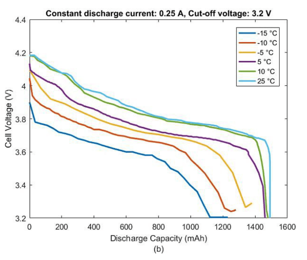

The battery has the same amount of energy regardless of temperature. 80% is 80%, whether it's at 0º or 80º.
That's not exactly it. One may have pumped the same amount of electrons into the battery to achieve 80% charge but the main factor at play, as battery temperature drops, the delivered voltage, hence power per amount of electrons drained, drops drastically.
Everything below is a quote from How to read battery discharge curves - Battery Power Tips
The graph below shows the impact on Li-ion performance at varying temperatures. At very low temperatures, the performance can be greatly reduced. But battery discharge curves are only one part of the story regarding battery performance. For example, the further the operating temperature of a Li-ion battery is from room temperature (both higher temperatures and lower temperatures), the more the cycle life degrades. A complete analysis of all the factors impacting the suitability of various battery chemistries for specific applications is beyond the scope of this look into battery discharge curves. An example of other ways to analyze the performance of different batteries is the Ragone plot.
Ford F-150 Lightning Unexpectedly low range Battery-voltage-capacity-and-temp-1024x545
Battery voltage and capacity are temperature dependent.
(Image: Richtek)https://www.richtek.com/Design Support/Technical Document/AN024

You’re confusing maximum charge/discharge rates with energy storage. A cold battery has the same amount of energy, but it can’t be released as quickly or efficiently. Hence the lower maximum power and regen.

Go along any horizontal voltage line in the graph in my previous post, say the 3.4 volt line and you will effectively see the reduced power of the battery by the ability to output electrons down to a useable voltage. At 0 degrees C, there are only about 1700 mAh of useable electrons down to 3.4 volts, whereas at 23 deg C, there are about 1930 mAh or more of useable electrons down to 3.4 volts. The graph is probably for a phone battery; the higher voltage in an EV battery is just achieved by stacking cells in series that follow the same chemistry and temperature dependencies.

I'm wrong. It's tough to find anything more than generic information, but I dug up a couple of interesting research studies that addressed this. This one from 2016 found only 82% of the test cell's capacity was available at -15º C. It doesn't identify the cell used. This one from 2018 cited to the previous one, and mentioned that low-temperature electrolytes can significantly increase performance.
Ford F-150 Lightning Unexpectedly low range 1702250823118
Battery tech has improved by leaps and bounds over the last decade, and we don't know the exact characteristics of the batteries slung under the Lightning. But whatever they are, they don't have quite as much energy when cold. I don't think the effect is as significant as people think, and the primary cause of reduced range is increased consumption because of heating loads and other factors. I had that basic principle wrong, so wanted to correct that.
