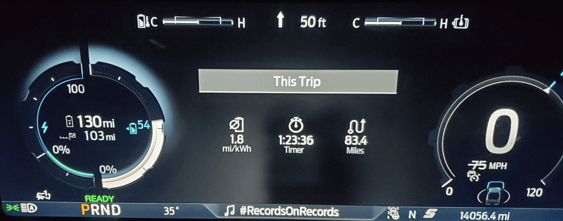

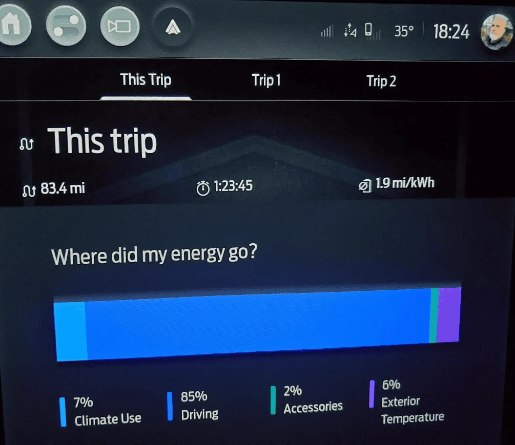

I did a round trip run to Southern NH this evening, chilly low 30's
The drive up maintained 75 MPH most of the way with heavy fast moving traffic, cabin at 70 degrees since I was driving alone and I knew I had a long trip, I conserved on the heat. I started at 90% with a projected range of 272, imputed ranged max range after this leg was 213.4 {130+83.4}, or 216.9 {130/.54*90%} Only burned up 7% for cabin heat 16.5 miles, 6% for battery losses or 14 miles of potential range at 1.8 MPK

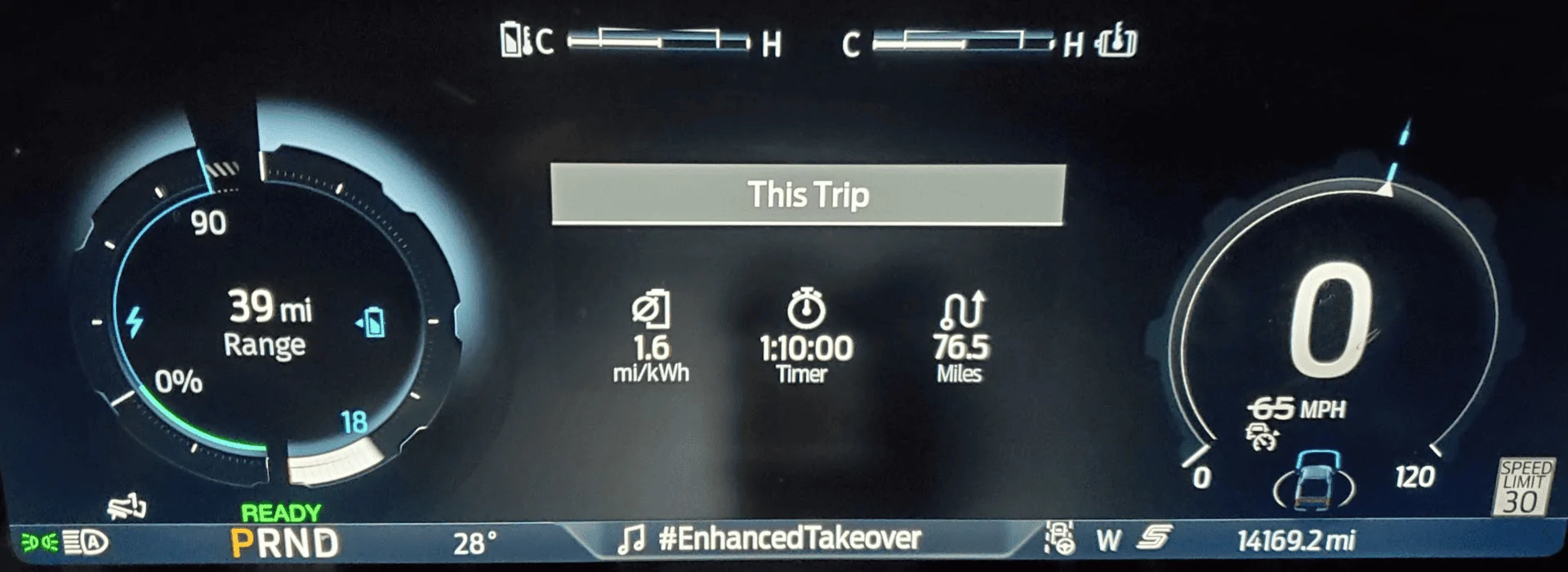

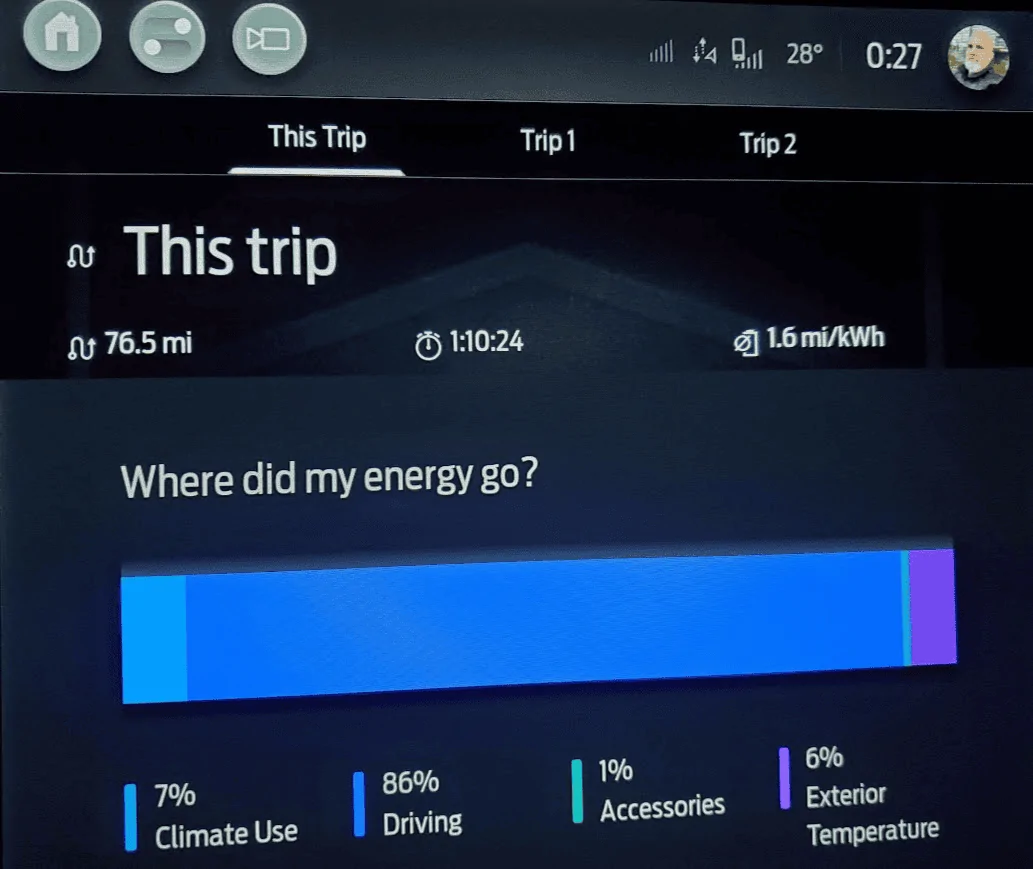

The drive home, I maintained 70 MPH with a few spirited bursts with less traffic, lowered the cabin to 65 degrees, slowed to 65 the last 3 miles. outside temps were lower at 28 degrees, my climate and battery took the same amount, driving went up to 86%, note the MPK dropped to 1.6

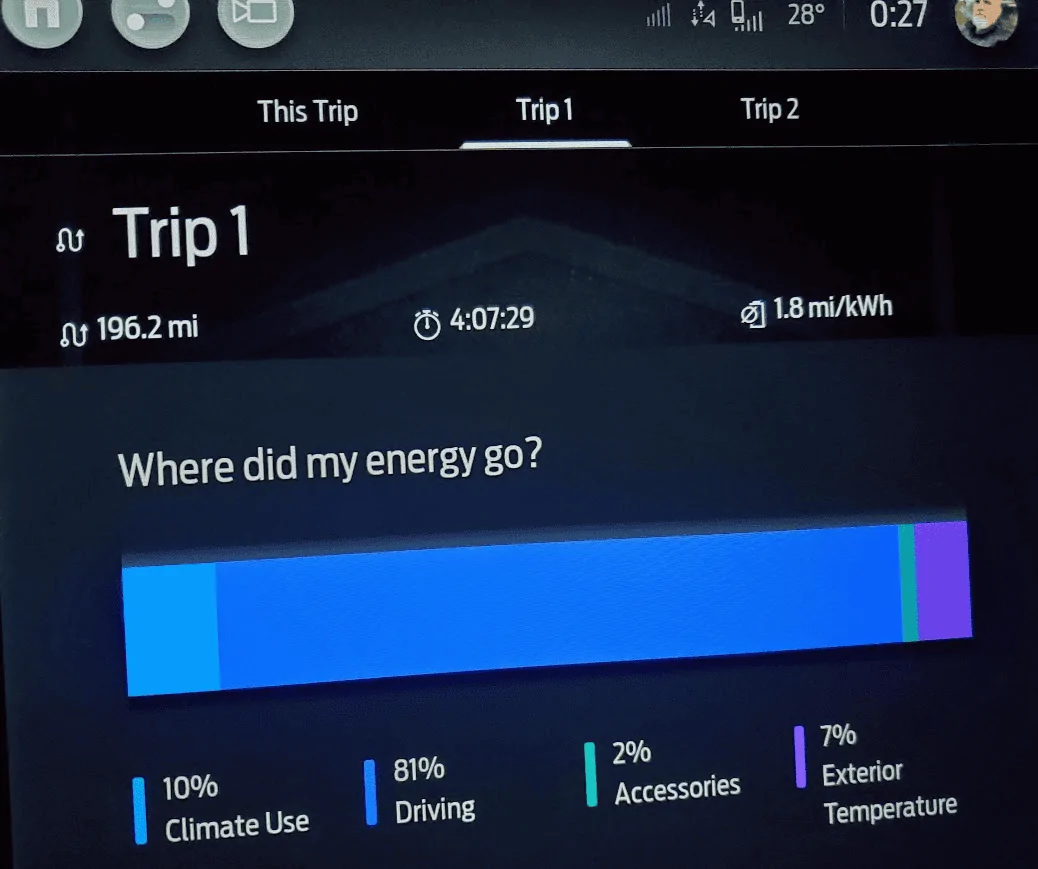

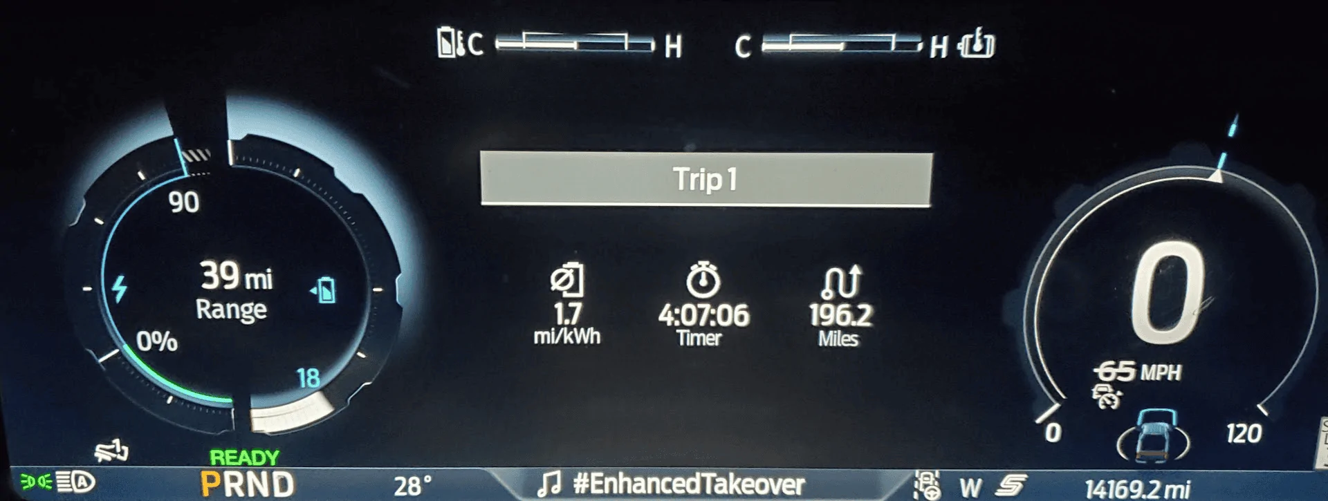

Totals for the night:

That pencils out to:
83.4/((0.9-0.54)*131*.85) = 2.08 driving mpk
76.5/((0.54-0.18)*131*.86 = 1.88 driving mpk
Interesting that the Trip 1 energy dropped to 81% for the entire trip. That must include another trip with a pre-condition?
Anyway, those numbers for driving mpk are closer to what the OP is seeing. Probably in line with what to expect for straight out 70-75mph highway driving in ~30 degree weather.

The first leg 83.4 miles was to Nashua (95n, 495n, 3n), I thought I was averaging 75 indicated, but there was congestion in section which slowed me down lessening speed impact, looking at the time lapse & miles overall speed was 59.93 MPH , I did have the truck in the garage plugged in & warming up.

Last leg 76.5 miles was from the Nashua EA to home (3s, 495s, 95s), cold soaked for a couple of hours, my driving was more spirited in some sections, likely contributed to my reduced MPK, overall speed was 65.11 MPH
Speed kills efficiency!
