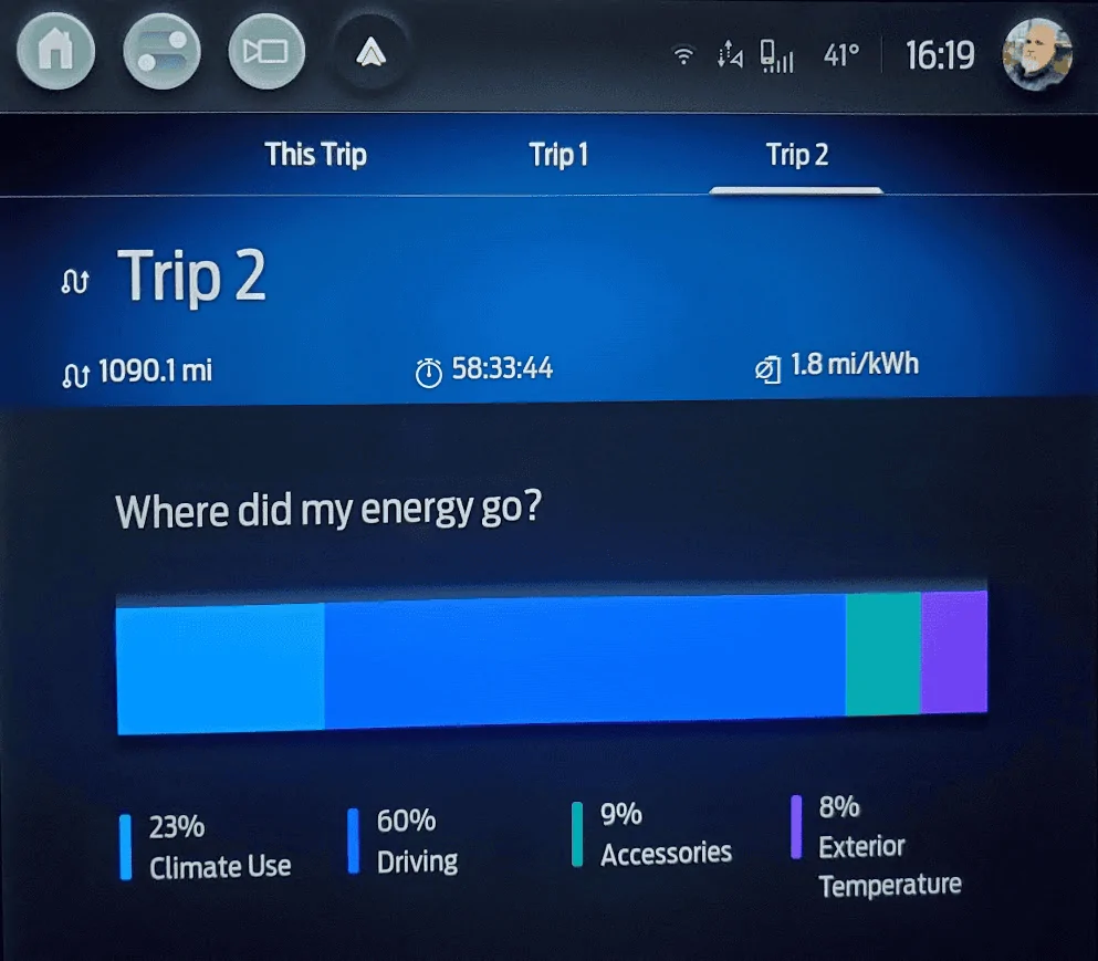

This is an example of a Lariat-ER quarterly performance to date starting 10/1/2023
Southern New England weather conditions, remote starts on level 2 about half the time (am), then unplugged afternoons. Temps ~74° for the cabin, use seat & wheel heat when needed, most of the driving is local roads 75% of the time and interstate 25%. Normal drive mode with 1PD on.
1.8 MPK over 1090 miles over 68 days
23% climate!!! @TaxmanHog likes a toasty cabin! :LOL:
Probably Mrs. Taxman while she is waiting in the cab... while he is in the bed of the truck doing his Magical kabuki dance underneath his favorite cell tower to try and get the next OTA update.
