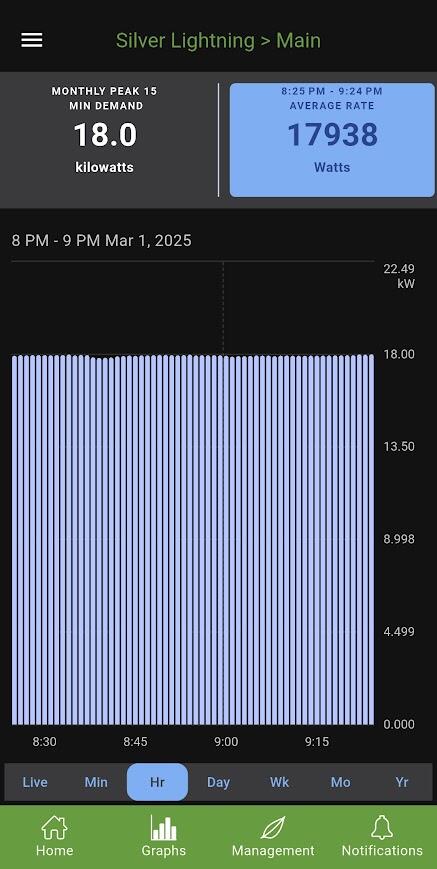

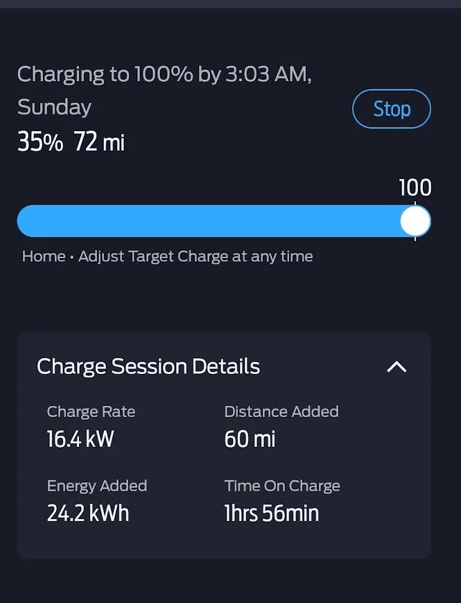

Yes ER trucks can charge at a theoretical rate of 19.2 KW, reality is about 18 kW, net to the battery ~16.4 KW
At this moment I'm doing an 8% to 100% balancing routine, this the rates and ETA for 100%
You will NOT benefit from an 80 amp EVSE, your 2024 can only process 48 amps!
If you have not bought the 2024 yet, look for new old stock deals on a 2023 ER!

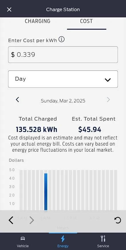

It {22 or 23 ER} would improve cycle time when recharging, I wouldn't worry so much about the PTC vs HP heating system, I haven't seen enough real world data from members, but I'm thinking the savings are marginal.

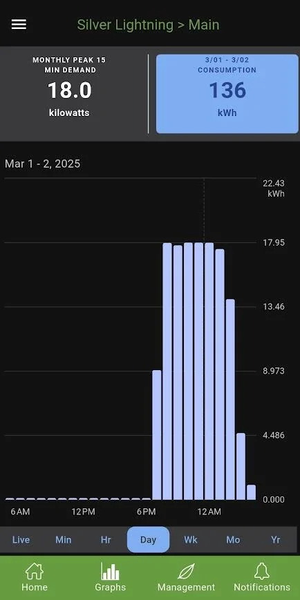

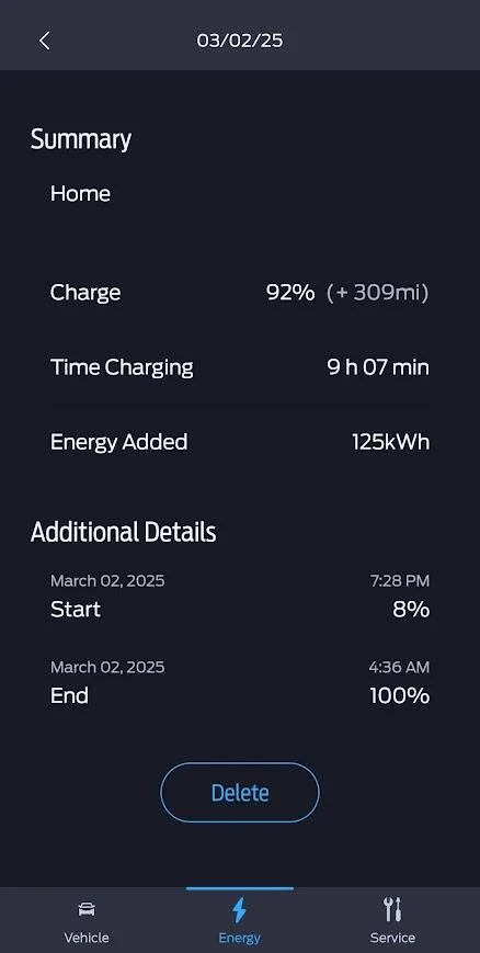

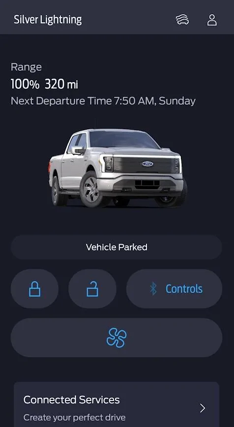

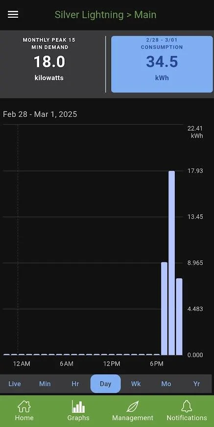

BTW, not to divert the thread, but here is the results of my 92% charge addition, finished at 0436
125 kWh of traction energy to the battery, from the grid 136 kWh
Original estimate was to be done by 0306 but it took another 1 and a half hours for balancing.
It's been a while since I did a deep cycle balancing routine.
