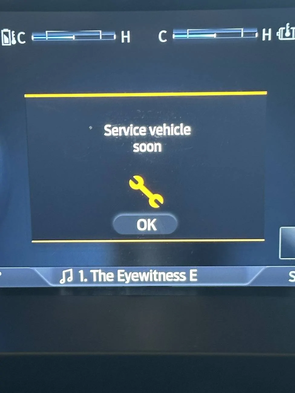

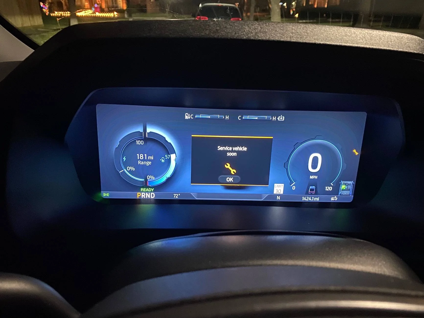

Got a “Service vehicle soon” sign on my 2024 Flash with 1400 miles on it. Will take it to the dealership tomorrow. Just wondering if anyone had any similar experience?

Thanks for the link to the thread. However, every single person that posted on those threads had their power reduced; mine is still at 100%, and everything works normally on the truck. Will post an update once I hear back from the dealer. Thanks again.

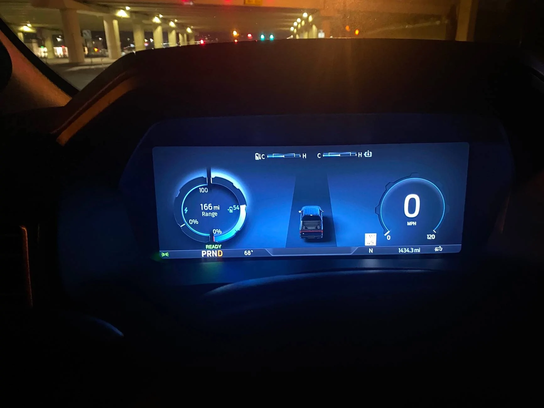

Just got back in the truck after dinner and the alert’s gone… not sure what’s going on 🤔

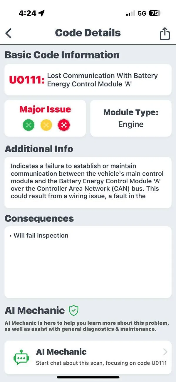

2000 miles on my BRAND NEW truck. Got the 'service vehicle soon' message when I parked. I'm just shy of 30 days ownership right now. And I need to make a 100 mile trip tomorrow.

ODB scanner results

I have gotten the U0111 twice in my Mach-E. It just a temporary glitch where communication is lost to the BECM. Both times, a restart cleared the error and a was able to drive normally. There was a BECM update available that the dealer applied (along with others) and it hasn’t happened since.
The interesting thing is that in the Mach-E, the message was “Stop Safely Now” which is much more urgent than “Service vehicle soon“ for the same code.
