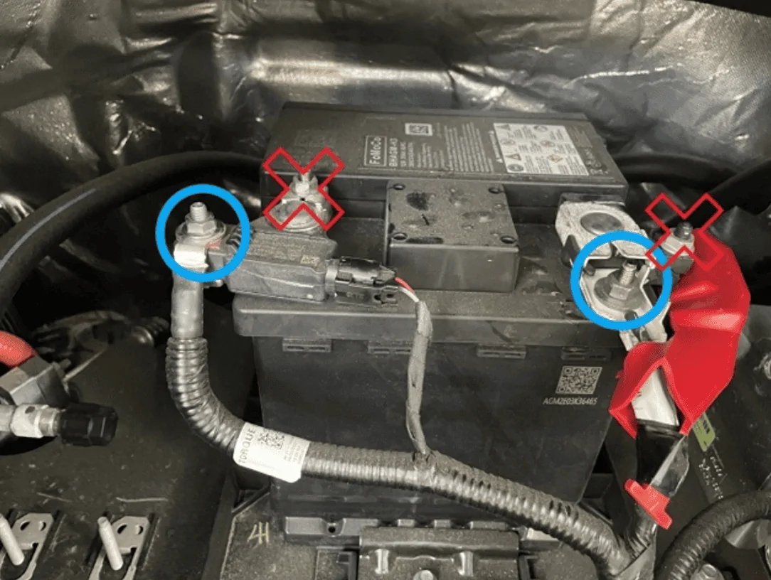

This gets more confusing the more posts I read about it. Sorry, my brain must be failing. It's a revelation to me, at least, that the Ford website dashboard SOC is the LVB (if I understand correctly from the above). So what are the best recommendations? I should try charging the LVB using Accessories mode, or with truck ON mode... with Shutown Timer off? With truck plugged in, or not? What other conditions must be set? These?: FOB and Paak out of range + don't look at FordPass + headlights off position + parking brake on + Frunk and tailgate closed . I bought a NOCO Genius2 tender charger recently, with the M6 ring connectors and I planned on attaching in battery compartment as described: https://www.f150lightningforum.com/forum/threads/charging-12v-battery.16979/#post-342220. (blue circles)
Ford F-150 Lightning 12 volt warning in cold while plugged in 2024-01-12_12-05-16
Do I need to have the Frunk shut? Will the tender power cord interfere or cause harm to Frunk? Another dumb Q: while the tender is running, I should have the truck OFF, and not in Accessories mode, right? If I'm downstream of the BMS sensor, I don't need to ever do a battery reset, yes? I see that some have connected the battery tender in the jump posts under the Frunk passenger cover (arrgh - all those clips!). Is that easier/better than the battery compartment?

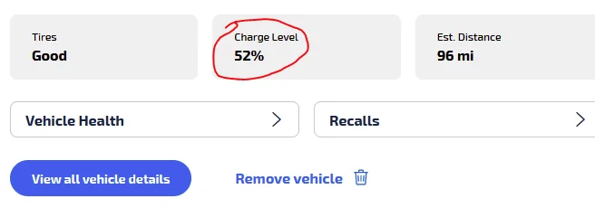

I assume this is what you are talking about? I had NO idea this was LVB SOC. I thought it is just wrong info for HVB SOC like many other places. Seriously, how am I suppose to know when it is right next to range with no specific label? In my defense in this case 52% HVB SOC getting me 96 miles is not that far off for standard battery pack. This was a big help (before the refresh, the info was four days old). Now if you can show me where to find this info on FordPass?
I seem to be loosing more than 10% SOC from LVB every day. Is this high?

Got it. Per a another post in thread I see that it is on the homepage of the dashboard as SOC, which I thought was the HVB. Even with the tender I am at 92%...
