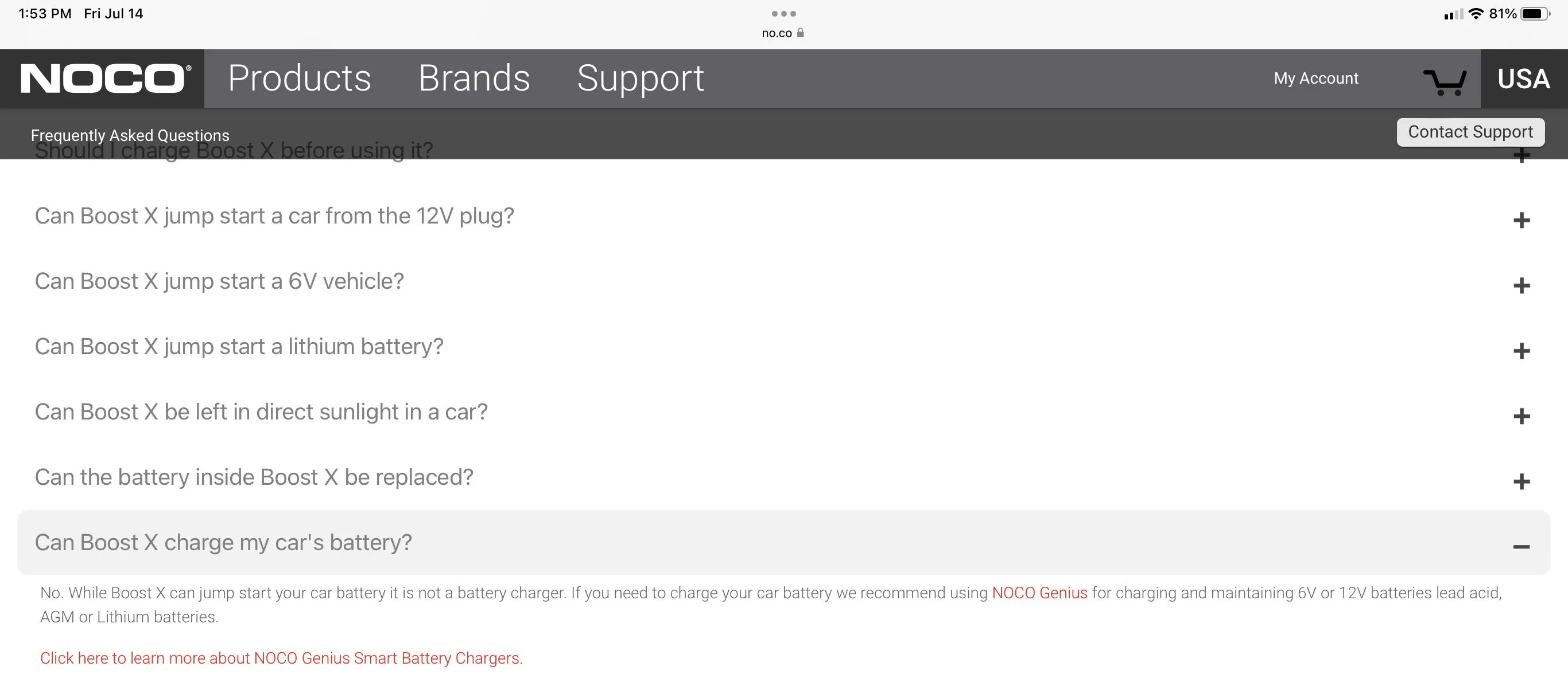

This is very helpful. The Noco GBX55 that I posted a picture of at the start of the thread has a peak current rating of 1750 amps which should be more than enough to handle that inrush current and much more. It also has a 46 watt hour lithium ion battery which may prove useful if needing to leave the jump box connected in order to drive the EV.

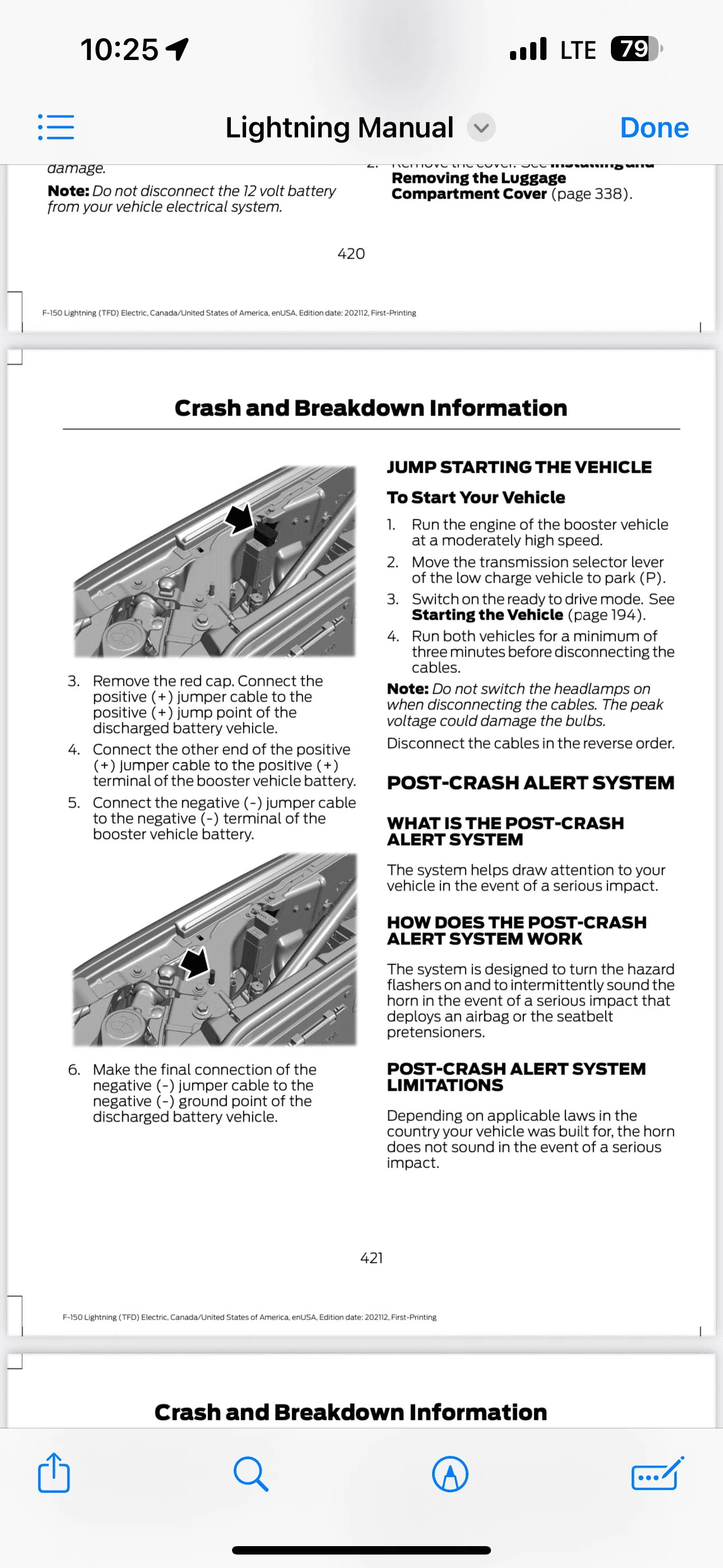

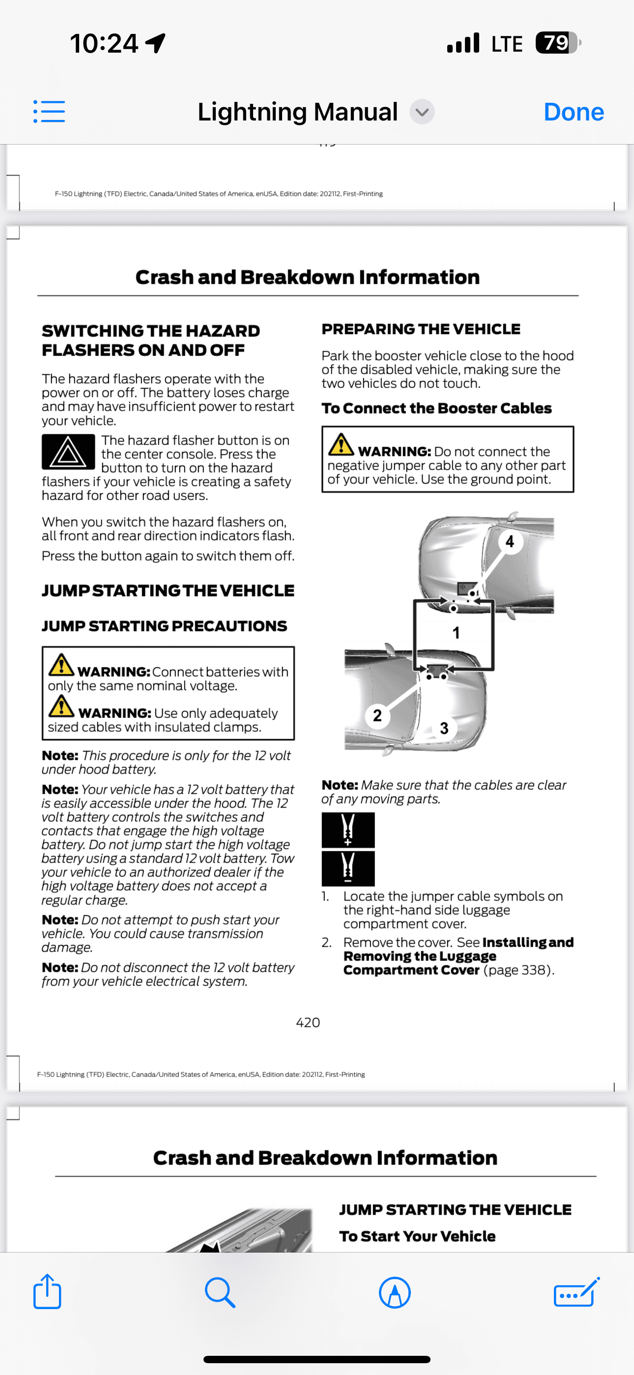

This is from a Ford SVE bulletin:
"While ignition status is off, DC-DC is normally off and 12V battery supports the 12V loads.
While ignition is off, if 12V battery reaches 40% state of charge, then vehicle waits 48 hours , before the DC-DC transfers 300 Watt-hours of energy to recharge the 12V battery. The HV power comes from either HV battery or wall power while on plug. If the 12V battery state of charge reaches 30%, then this HV to LV energy transfer happens immediately with no delay.
Note:
• This system was designed to recharge 12V battery while the vehicle was left parked for many days
either on or off plug or occasional drain from customer usage. The 12V battery will wear out if this
energy transfer is completed daily due to aftermarket loads draining the 12V battery down to 40% or
lower.
• Vehicle has 35 Amp-hour AGM 12V Battery"
