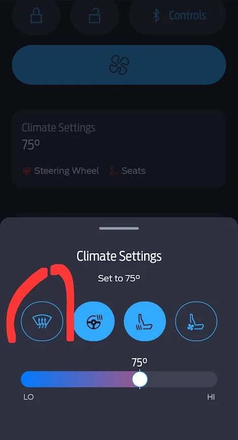

You can pre-condition your vehicle with no environmental on but if you want to preheat the cabin, I am not sure if you can select how the heat is distributed. My XLT Lightening 2024 has a heat pump so it warms slower that my MachE that has almost instant heat.
I don't think this is an option on the Pro, at least I can't find it anywhere. In one of the latest app updates, there now is a "climate" option after I initiate precondition. Even with climate temp set at 60 and defrost and seats set to off nothing changes with precon nor are there any changes with cabin settings once the truck starts so I haven't discovered what the "climate" button does for the truck.
89
5,564
7,470
"Climate" is a word. It replaced "Remote Start". That's the change, nothing more, nothing less.
This was done for two reasons. 1) There is no difference between starting an EV and turning on the climate. 2) To create confusion.
After you hit Climate, AND your vehicle has had a server side update, you can change the temperature, the defrost, heated seats, and heating steering wheel.
Using a departure time while plugged in, which is the only way to precondition the battery, will go to the settings you pick when you set your departure time. It gives you less options but warms the battery.

I'm not sure what the trim level limitations are, but this is what the climate control panel looks like for a 2022 Lariat-ER, I almost never select the window defroster mode, truck is usually in the garage overnight and during inclement weather.
