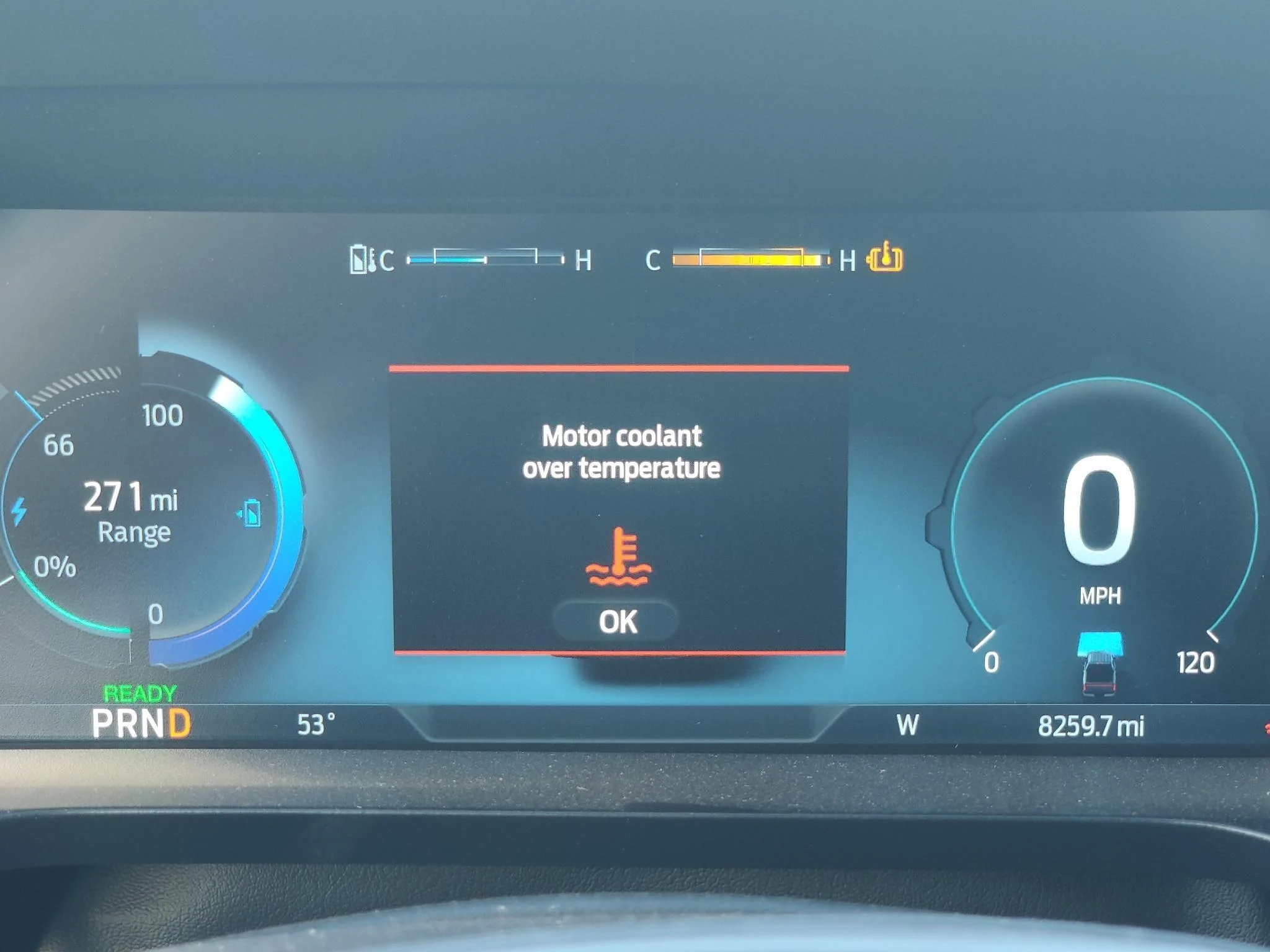

Soooo... I got my truck back yesterday (yeah!)... but this happened on the way home.
Ford F-150 Lightning Notice From Ford: Battery Replacement Needed MotorCoolantWarnin
Good thing I live only 3 miles from the dealership, so I was able to limp home. On the way back to the dealership this morning, it came on again - shot up during the regen braking. We'll see.

Did you look at the coolant level in the reservoir? Maybe just some bubbles that they didn't get purged??
Interesting power availability forced to 66% even though outside temp is moderate and the SOC is high. Probably to prevent over heating the motors any worse than they are

Tiny bubbles probably became one big one that causes cavitation in the pump and stops circulation. What a shame. :(
I've never seen either of those gauges move. I hope it's a quick fix!
Did I look at it? No. I'd just picked it up from the dealer service dept.
Air bubbles in the line is what they were thinking too.

Video of refilling the cooling system for a Mach E.
Refilling starts about minute 28.
It seems to take quite a bit of shop time.
Thanks @Grumpy2 - cool video, great info. Much appreciated.
OK, picked up the truck yesterday after work. Yep, air in the coolant system was the problem - good to go now. Yeah!
