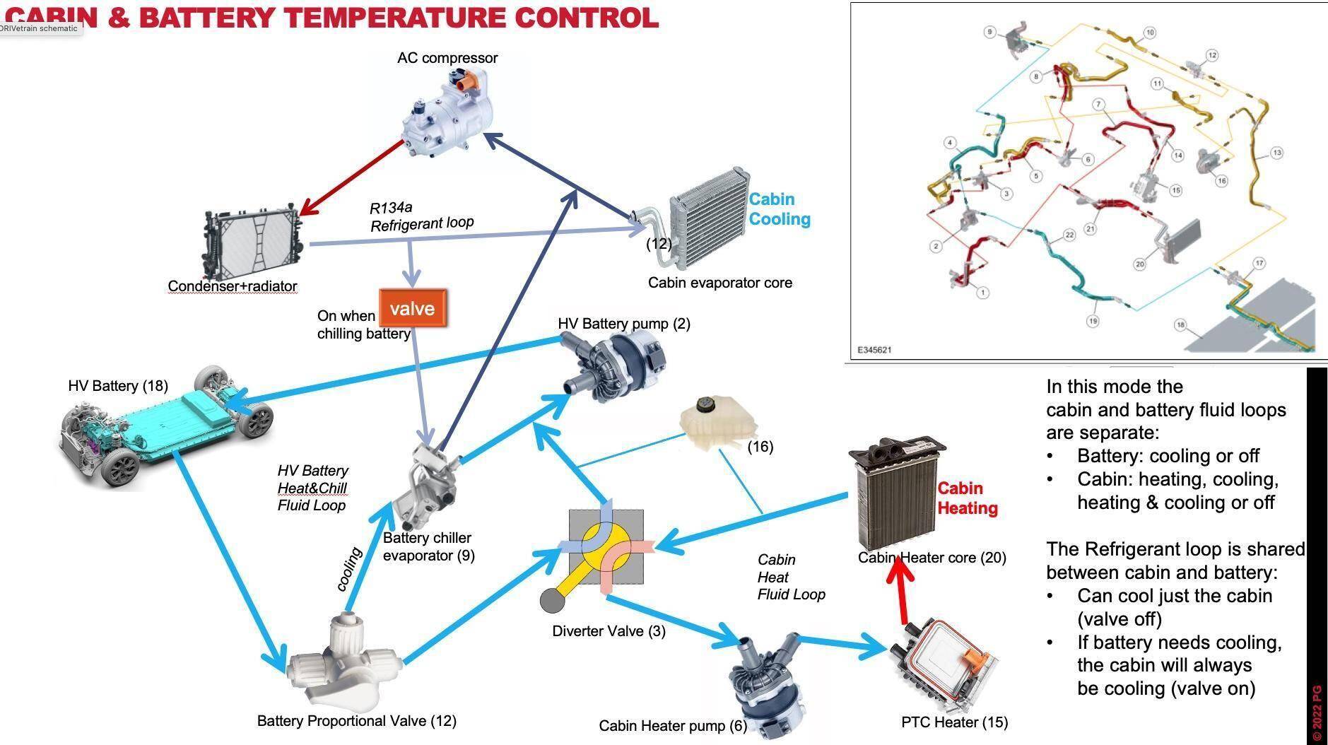

186
14,035
15,127
I've also noticed the heater is inconsistent- it blows lukewarm air, and then really heats up the cabin when the battery is preconditioning on the way to a fast charger. I'm guessing it's doing some heat scavenging from the battery when it shouldn't be.
NOTE: 2022/2023 system, but I suspect the heater core is substituted for a HP condenser/evaporator .. or the entire AC/HEAT system is swapped for the HP system, but a PTC and glycol loop is still in play for battery conditioning.
I'd love to see the architecture of Fords HP system.
The glycol loop is designed such that the cabin heater core is between the PTC and the HVB when the diverter valve is set to battery conditioning sub-loop.
That ensures cabin warming happens and the battery is next in line.
Try lowering the fan to bare minimum if you get too hot.
