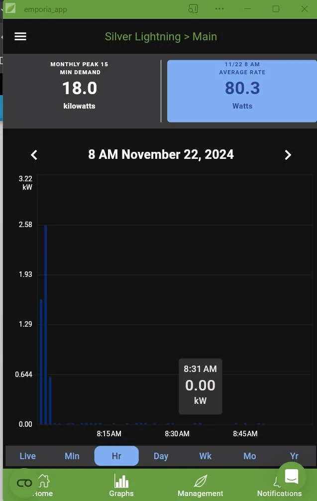

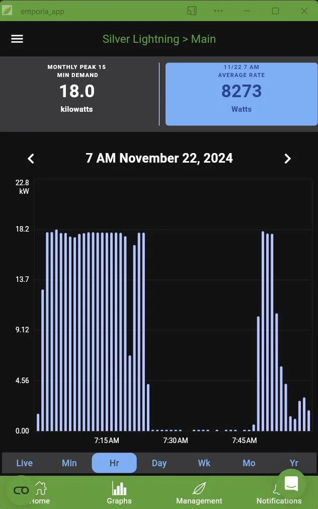

There are a number of suggestions I've read about pre-conditioning while your truck is plugged in to avoid wasting battery on cabin heat so I've recently started pre-heating 15 mins in advance.
NOTE: An odd issue I encounter is the dumb/buggy Ford charging software seems to want to randomly go into Charge 100% even though I have 90% max charge set everywhere and the truck had been at 90% when I start the pre-heating. I find the only way to keep the truck for charging randomly when it wants, sometimes to 100%, is for me never to have it plugged in once it's at 90%.
I noticed that Fordpass will display a message concerning how much time to 100% while plugged in and running the climate / remote start cycle, that message is essentially a false statement.
My truck had already reached my charging goal of 90% previously at 7:24 am.
Then the truck sat quietly until I clicked the remote start 7:47, the "charging Status" display reappeared to say it would reach 100% by 8 somthing am about another hour, but the remote start is only for 15 minutes, or 30 if I extended it, but notice the power flow from 7:24 am to 8:02 am when I unplugged.
The reality is that the charge controller limits the amount of additional energy going to the HVB but does allow 'just enough' to maintain the heating cabin preparation process while on the grid connection. In the past I've never seen more that 1% 'extra' charging occur during this process.
