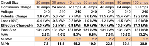

Not to split hairs... but 10kW sounds more like 40 amps to me. Not 32.
I took that estimate from the following post. So yes, it’s ‘like’ somewhere between 38 and 48 amps.
Hair split! 😊
Ford F-150 Lightning 40A home charging - Should I do it 1701275830439
87
5,547
7,440
48 x 240 = 11.5kW, 10.4 or so to truck. 48amps.

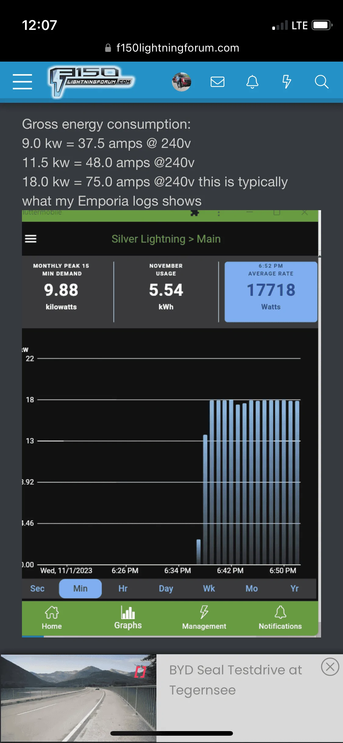

It's all about how far you drive in an average day and how much time you have to charge if you're under a Time Of Use rate regime.
