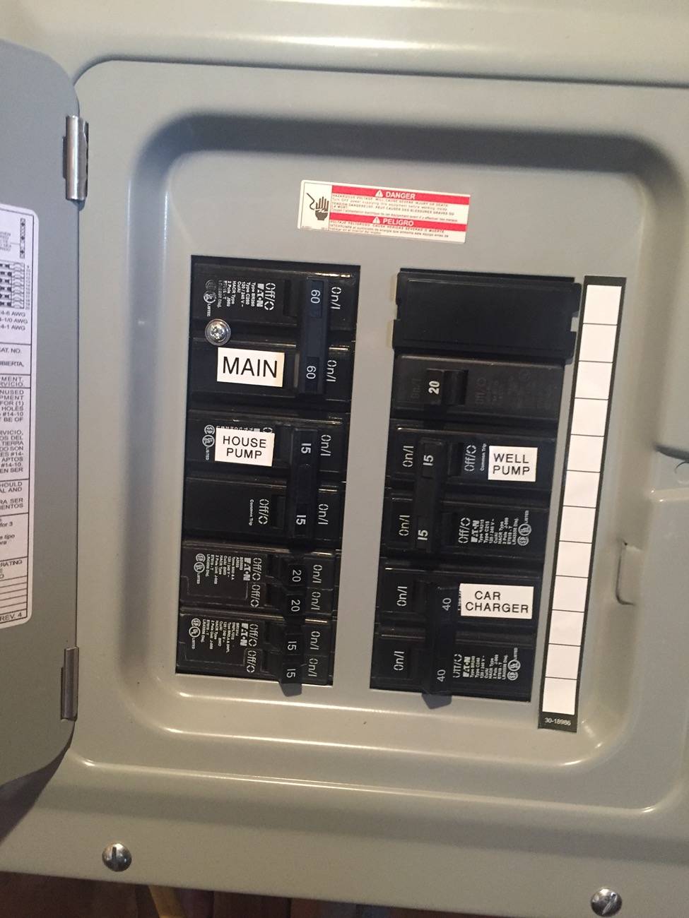

You can repurpose the 40 amp unused kitchen range breaker and wire it to a 14-50 outlet. Then use a Ford mobile "charger" that has a 50 amp plug that will only draw 30 amps.
It's legal to ie a 14-50 to a 40 amp circuit since there is no 40 amp 240v outlet. Just label it as a 40 amp outlet.
I use a 14-50 outlet wired to a 40 amp circuit at the shed at my remote cabin. The breaker is wired to a 60 amp subpanel. Originally it was used to power my RV but now it is used as a backup charger for my EVs The sub panel also had 2 - 240 volt well pumps, a window AC unit and several lighting circuits.
No. The only semi-acceptable way to do this is to get an adapter to convert the 14-50 male end on the Ford EVSE to work with a 40A outlet (no less!) and preferably tape it on so that it can’t be removed and used for something else. Changing the outlet to handle a connection over the wire rating is a sure recipe for disaster in the future - especially in an old house with old wiring!

No. The only semi-acceptable way to do this is to get an adapter to convert the 14-50 male end on the Ford EVSE and preferably tape it on so that it can’t be removed and used for something else. Changing the outlet to handle a connection over the wire rating is a sure recipe for disaster in the future - especially in an old house with old wiring!
Agreed. If you were replying to me perhaps I was unclear in my posting. The breaker should NEVER EXCEED the Wire and outlet rating.
Since there is no 40 amp 240v outlet, it is legal, customary and acceptable to use a 14-50R outlet wired for 40 amps, and protected with a 40 amp breaker. It’s done all the time with electric ranges.
My detached shed Sub-panel has a 60 amp main. Per code, a main is required in the sub-panel because it is in a detached building and has more than 6 breaker handles.
It’s fed 6 AWG THHN in conduit from the house panel. The 14-50 outlet in question is wired to a 40 amp breaker in that sub-panel, using 6 AWG THHN in flex conduit.
Even though it’s labeled “car charger”, It primarily powers my RV ,so that’s why the 40 amp breaker is a standard Double Pole breaker rather than an expensive GFCI. On very rare occasions is it used as a backup EV charger outlet, since I also have a hard wired Tesla Wall Connector installed at the house which we use for the EVs.
