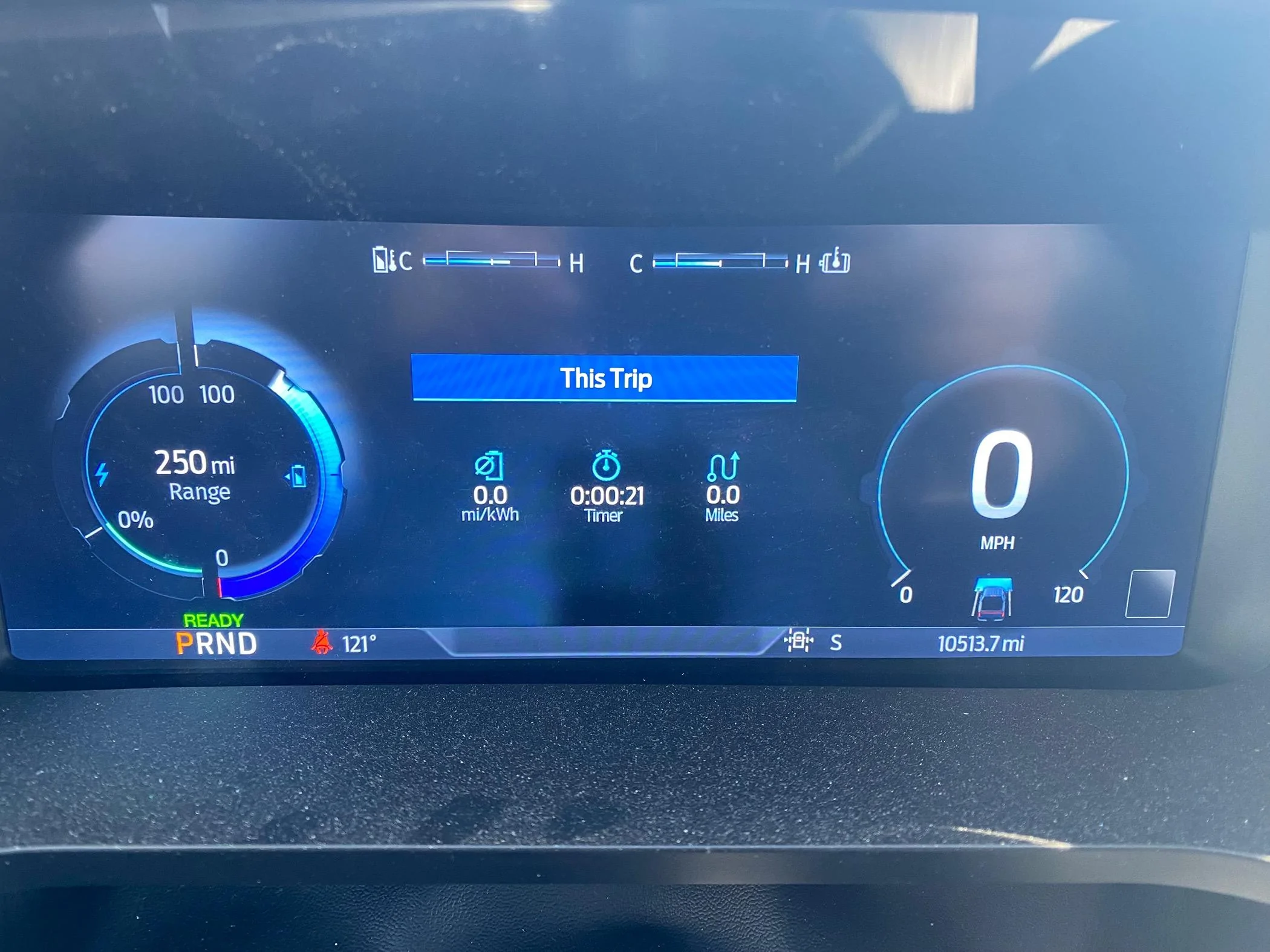

An update: Wife and I went on a 90ish mile drive today from home up around Carefree/Cave Creek and return.
Only 15ish miles around 70, the rest 55 and below. Ambient temperatures in the 108-111 range. Had an OBDlink MX+ plugged in and connected to Car Scanner on my phone. HVB temp slowly over the entire drive climbed to 102.2 at the end of the drive. HVB Coolant inlet was 87.8 at the end of the drive. Used about 27% battery during the drive with AC etc.
Battery temp indicator in the dash display went from the centerline at the start to halfway between centerline and the next tick to the right.
I checked the coolant level in the tank that sits under the drivers side fender cover and it was at the max fill line so I'm not low on coolant.
Question, at what HVB temp will the truck cool the battery when plugged in?
An update to my update I guess quoted above. Just more data, not complaining but am wondering.
I took a short trip on the freeway, air temp was running about 111. HVB low was 100.2 at the beginning, HVB max and coolant inlet was 102.2. The trip was an out and back to try and mitigate wind, elevation etc. and was about 15 miles one way. HVB max and coolant inlet slowly climbed to 104 then on the return leg, both coolant inlet, min and max started to drop from 104.0 to 100, to 98 to finally reach 89.8 as I took my exit to go home. Max went to 90.5 at the end of the trip as I pulled into my garage. Maybe battery cooler circuit doesn't kick in until approximately 104, don't know, not enough data. I don't know the parameters Ford uses for the temp readings, but to me logically max should have stayed at 104 and coolant inlet and min should have been coming down.

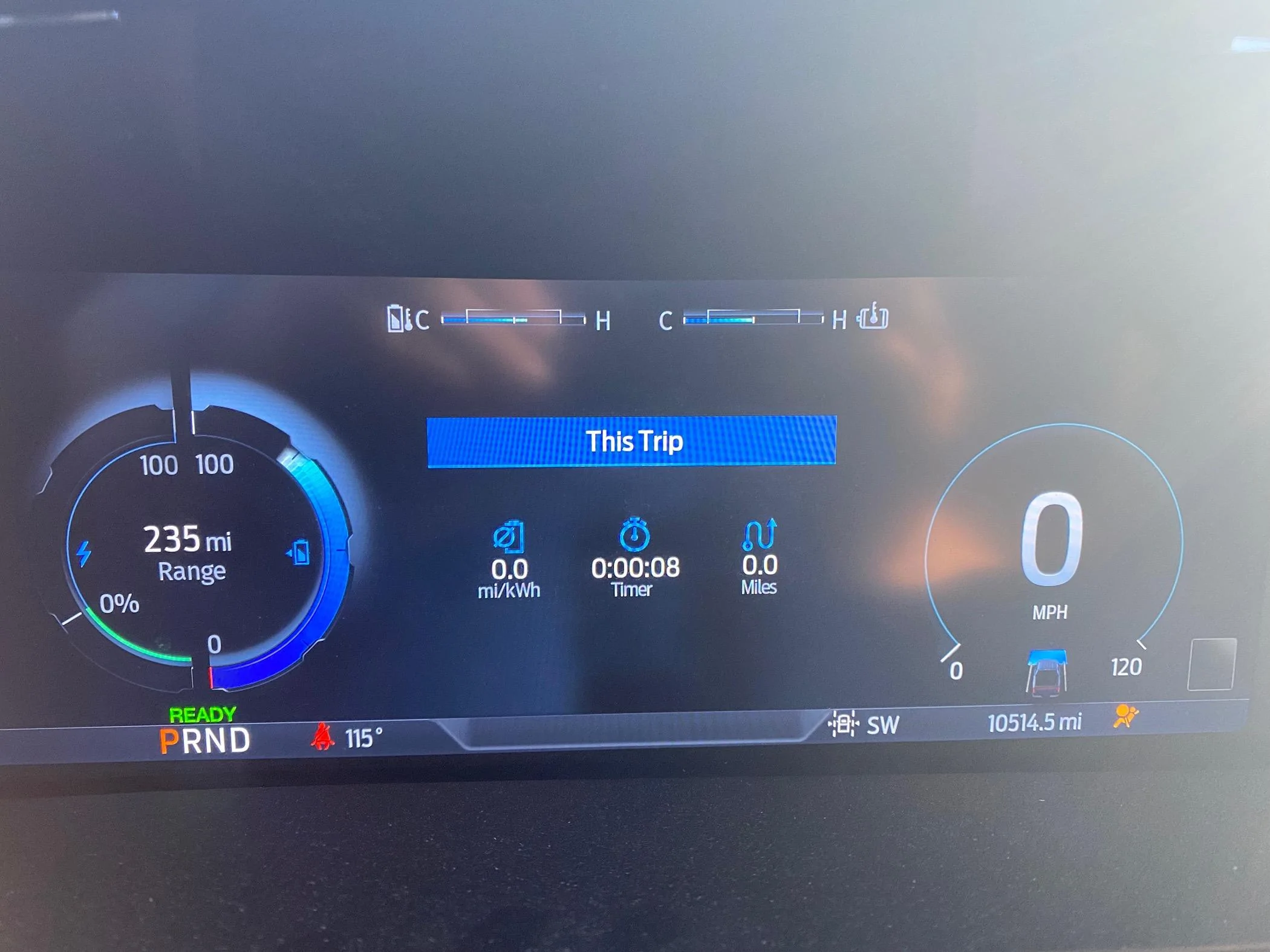

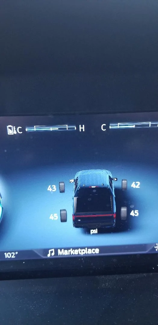

Just did a 500 mile drive out of Phoenix to Big Bear with the family. Highs hit 118*. Battery temps never go outside the “safe zone” but don’t go back to the centerline while driving. Truck has max trailer tow package FWIW. did some “experiments” with the ac controls and found that the battery will cool back to normal when maxing the AC to the feet rather than the main vents. Maybe it’s coincidence but I was able to repeat the results a few times on the trip.
