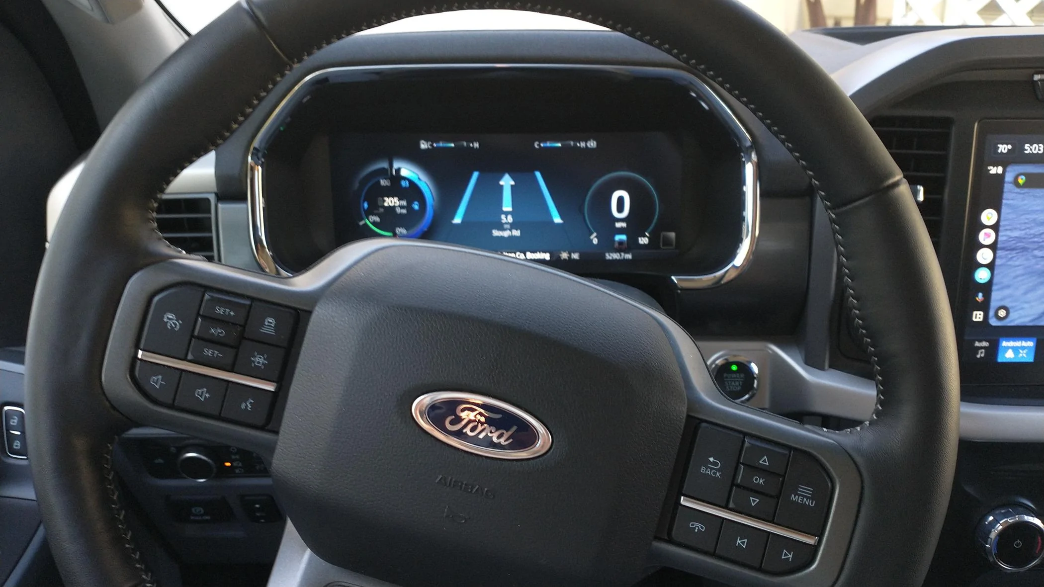

All I get is static (for the ringing or a voice answering or my voice to another phone) when making or receiving a call. I have not tried the steering wheel phone speaker button, if that is what folks are referring to. Button is lower, just left of center is the "talking face" (voice interaction button)? Not the lower, just right of center, "phone handset"?
Update 4-24: with Android Auto, used phone app to switch to phone speaker (if a caller would be patient for the switch) and that worked, but kind of weak volume at max. Not sure fastest method to switch if not using AA.
Update 5-2-24: Tried my wife's Moto G Power (2020?), same model as my unit, and did not get the static, call was normal. My phone is a warranty replacement, refurbished phone, so I wonder if that caused the problem, but I cannot find the dates of the replacement phone and the start of static noise on calls. Maybe a full factory reset might work, but I am not looking forward to reloading everything without a guarantee of a better outcome, but maybe. I do have a shaky arrow on the Ford Navigation screen and have lost Ford Nav at times, but again, is it just my phone. I did a restart of the phone and the navigation worked again...but Ford Nav should be separate from any dependence on the phone, I would think. Good excuse to get a new phone and latest Android operating system?
